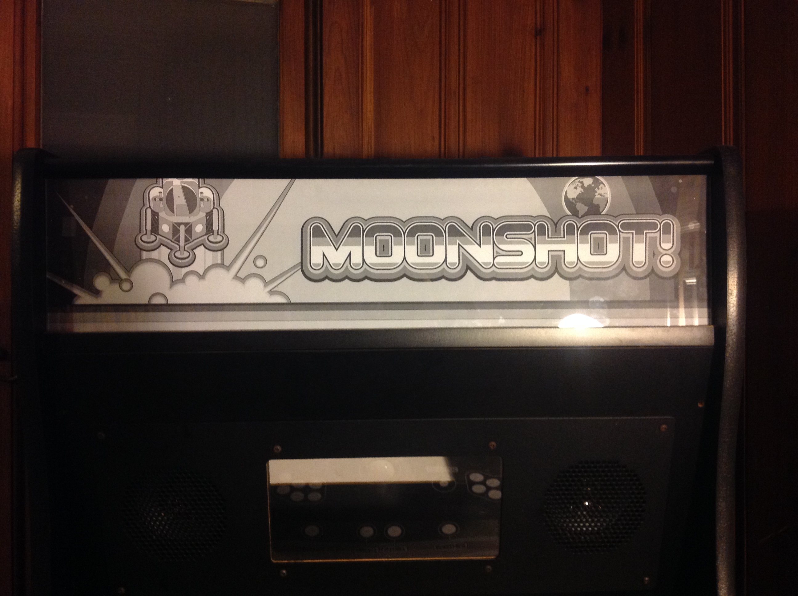

You also have to think about the Marquee brackets that might cover that shuttle up further.
+1, the top and bottom of that marquee need some "bleed".
BGoulette
  • Posts: 192
    • lazerjoose.com
Re: Moonshot! - Marquee Art Update (11/5/2015)
« Reply #41 on: November 06, 2015, 03:28:14 pm »
Valid points.
Token, let me lower the lander a little, then I'll send you a hi res file. Do you want ai, eps, pdf, png, jpg, tif, etc...just let me know! I'll also add printer's marks so you can get a better idea where the bleed ends, etc.
Token
  • Posts: 490
« Reply #42 on: November 09, 2015, 11:47:15 am »
Updated artwork.
vwalbridge
  • Posts: 2082
« Reply #43 on: November 09, 2015, 12:03:05 pm »
yep, that's better! Good looking retro marquee.

There you go! It would have been a shame had you got the old one printed up and blocked most of it...lol. Nice work on the artwork as well BGoulette!  :applaud:

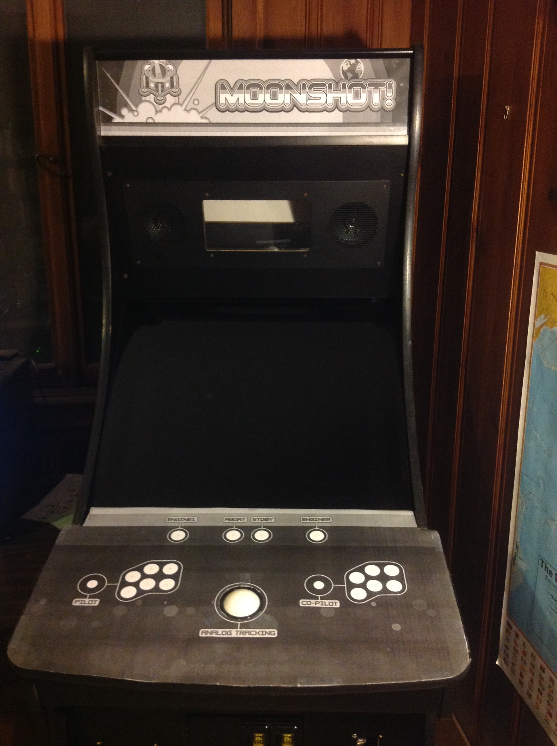

In a world filled with overly busy MAME cabinet art... one man takes a stand for truth, justice, and line-art. His name is BGoulette, and he gets all the credit for this Marquee and Control Panel art! :applaud:
 :notworthy:
If you are looking for clean retro art, then give BGoulette a ring.
And nothing on the control panel has been printed or cut, so please feel free to offer suggestions.

I like the ABORT and STANDBY tags.  I'll probably steal that if I ever get around to building a dedicated shmup cab.

Looks great. I really love it when builders do simple art. Less is more when it comes to art IMHO.
'STDBY' looked a little funny to me at first. And was only 2 letters off from spelling it all out. But I see you were trying to keep it symmetrical.

I really like the concept and almost all of the execution.   :applaud:
Two minor points to consider:
1. Having the "Abort" and "Stdby" buttons on the outside of and close to the "P1" and "P2" buttons makes it more likely to accidently hit Abort when you meant to hit P1.
- Put Abort and Standby where P1 and P2 currently are.
- Put more space between P1/P2 and Abort/Stdby i.e.  P1   (gap)   Abort   Stdby   (gap)   P2
2. Consider labeling P1 and P2 as Start 1 and Start 2 -- think engine start.
Yeah, I stole "Analog Tracking" from the recent NASA build. "Abort" is a volcano button on the original lunar lander control panel. It seemed fitting. BGoulette came up with "STDBY."
Yeah, keeping it symmetrical and brief. You should have seen the attempt to shorten "Analog Control."  :laugh2:
Remind me of the cab color/Tmolidng combo again?
Black laminate cab. Currently has black t-mold, but I plan on eventually changing the t-mold to yellow/orange to complement the art.
Two good points. We definitely need to space out those buttons. And "Abort" and "STDBY" would be better placed inside.
I'm thinking the start buttons could be labelled "Engine 1" and "Engine 2" above the buttons, and labelled "Start" below. Or vice versa.

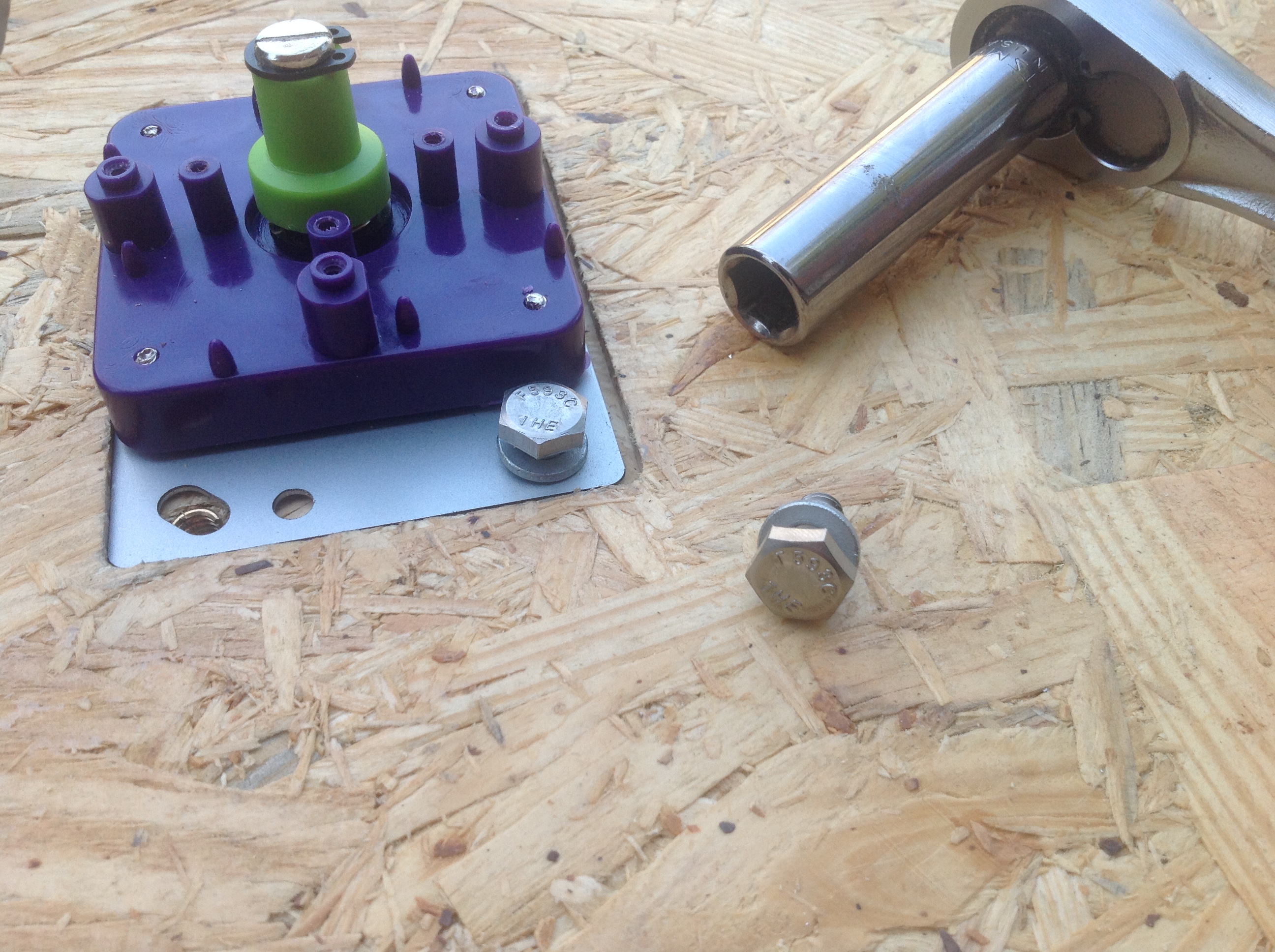

Artwork Test
Before sending the artwork off for printing, I had Staples do a quick B&W print job of both the Marquee and CPO. I am glad that I did! After cutting and scotch-taping it on the cab, it looked like this...
You can see the problem, can't you?
The lunar lander is cut off. So I checked my measurements, and sure enough, I had sent BGoulette the wrong dimensions for the marquee (I think I must have measured it without the retainer in place). BGoulette quickly made a revision to the artwork and it is sent off to stpcore for printing.
Lesson learned-- Always do a mock-up before sending the art for printing!  ;D

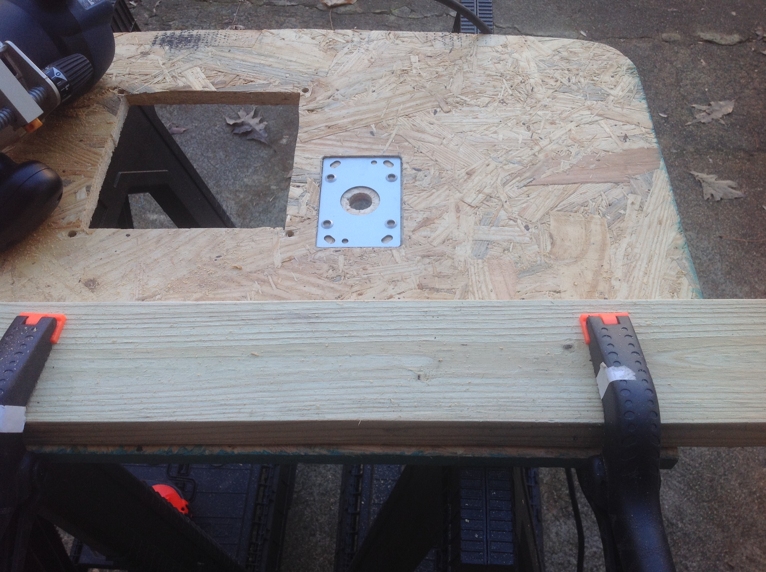

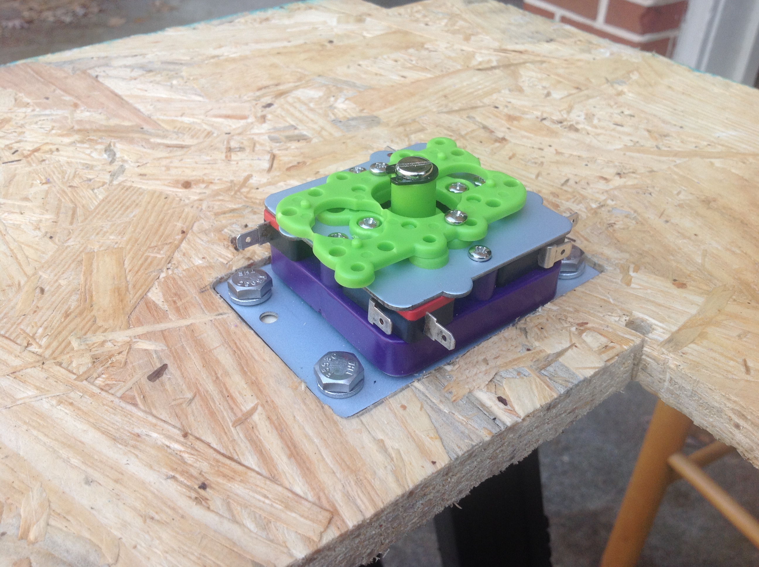

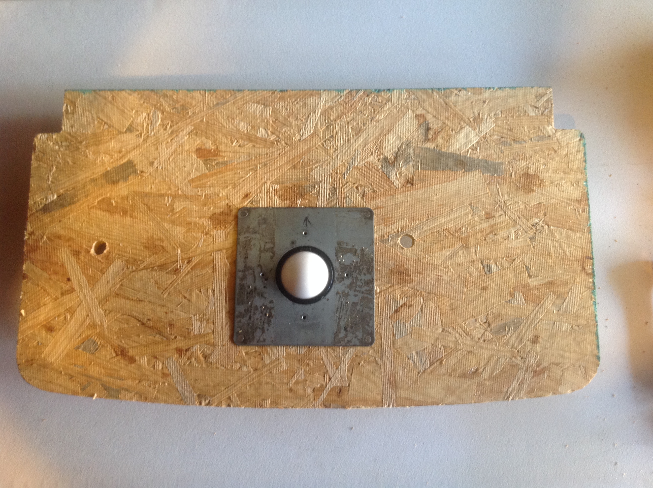

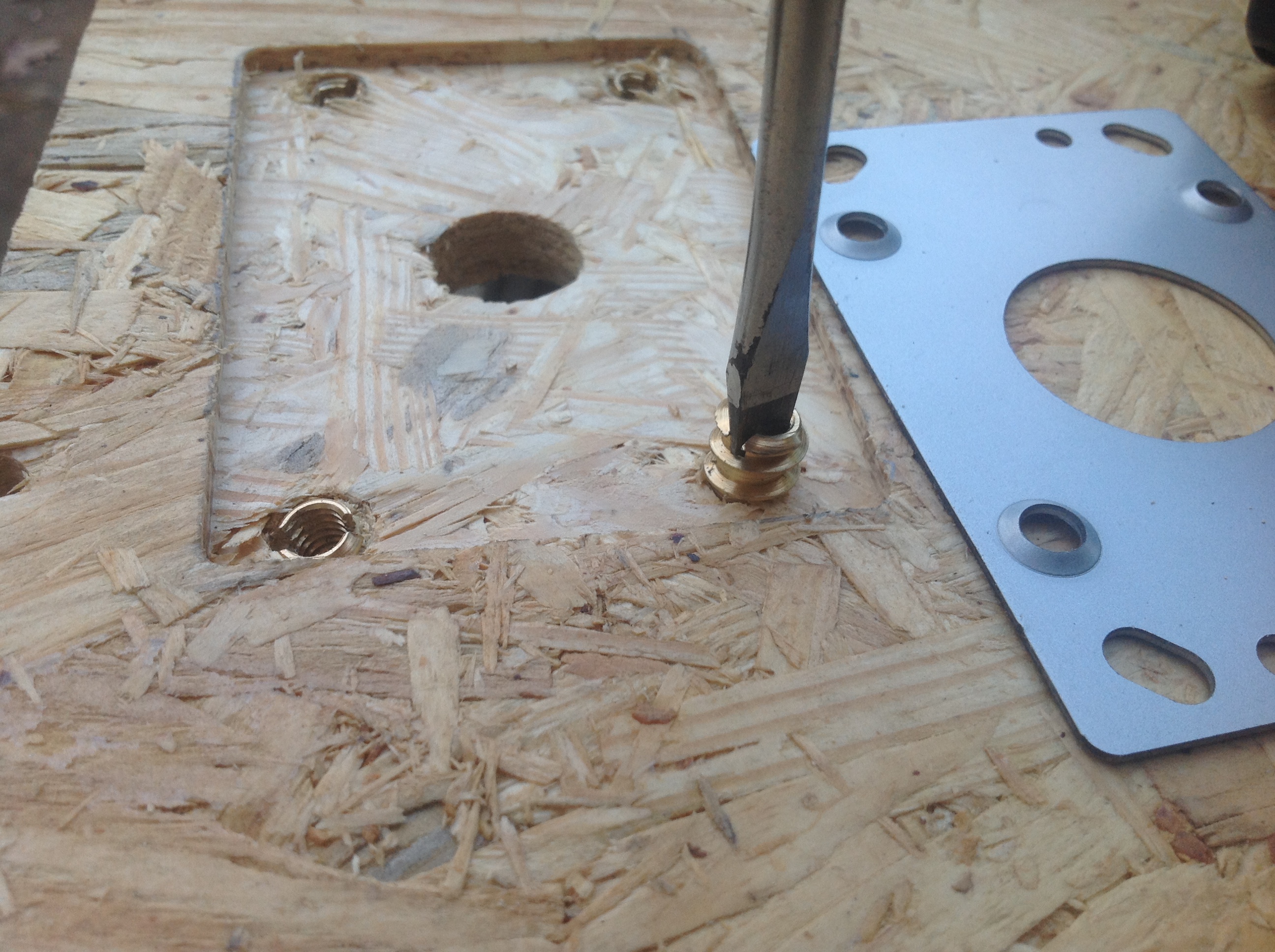

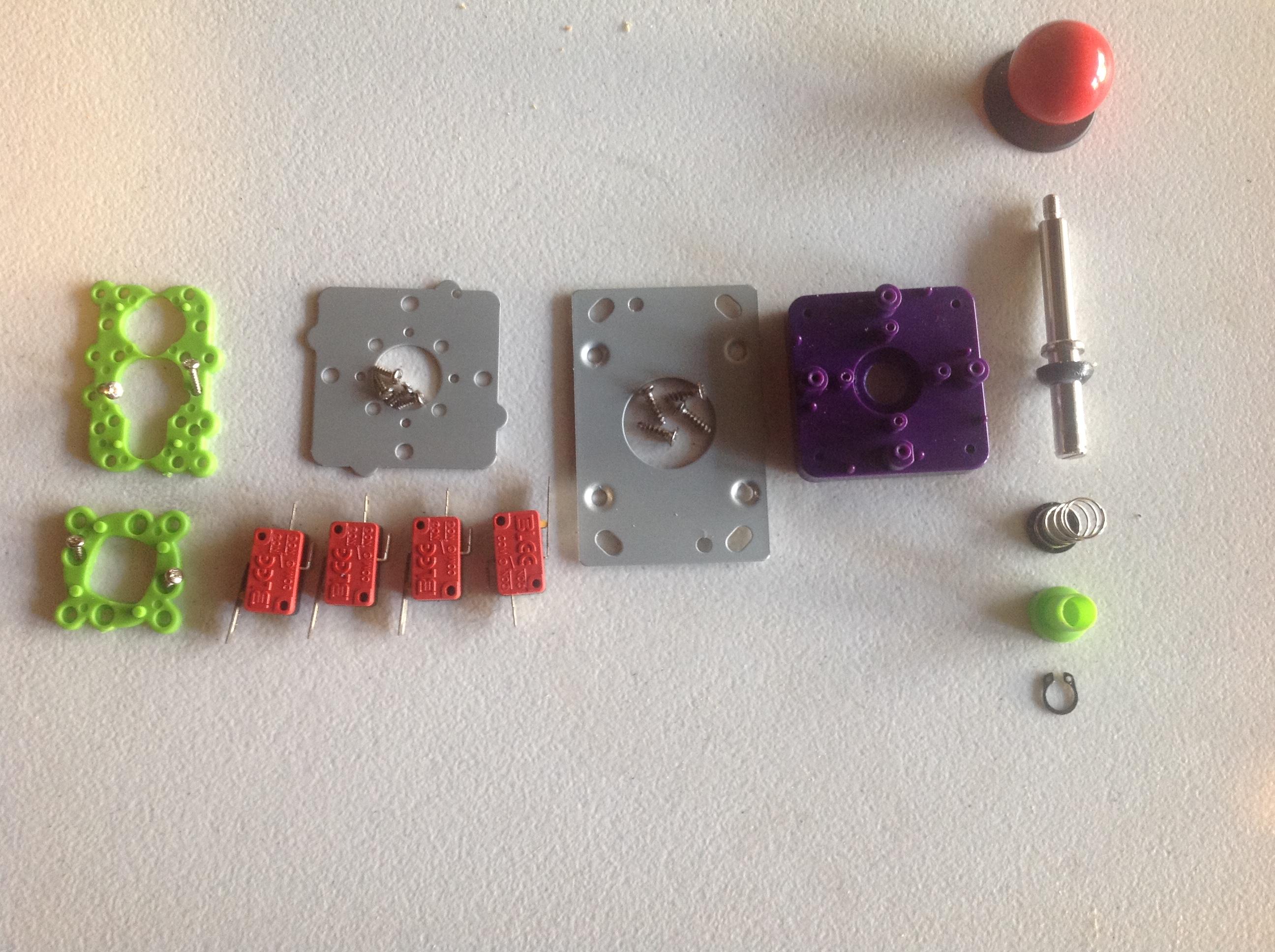

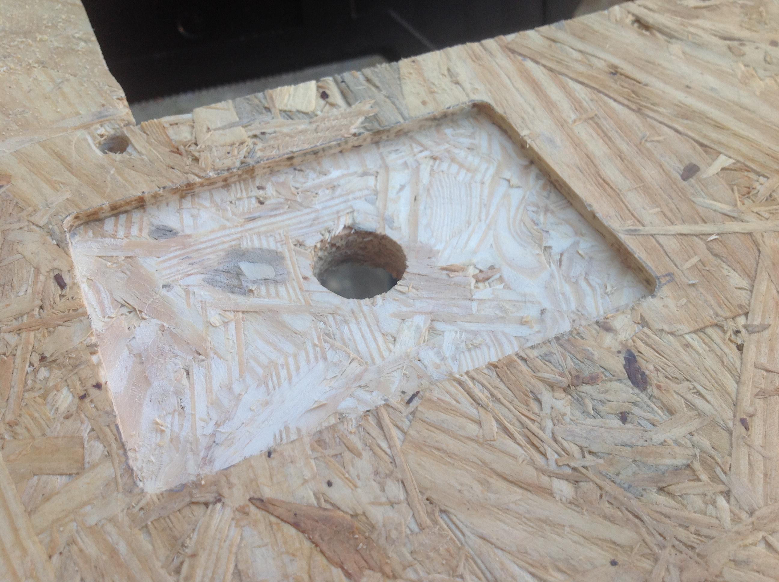

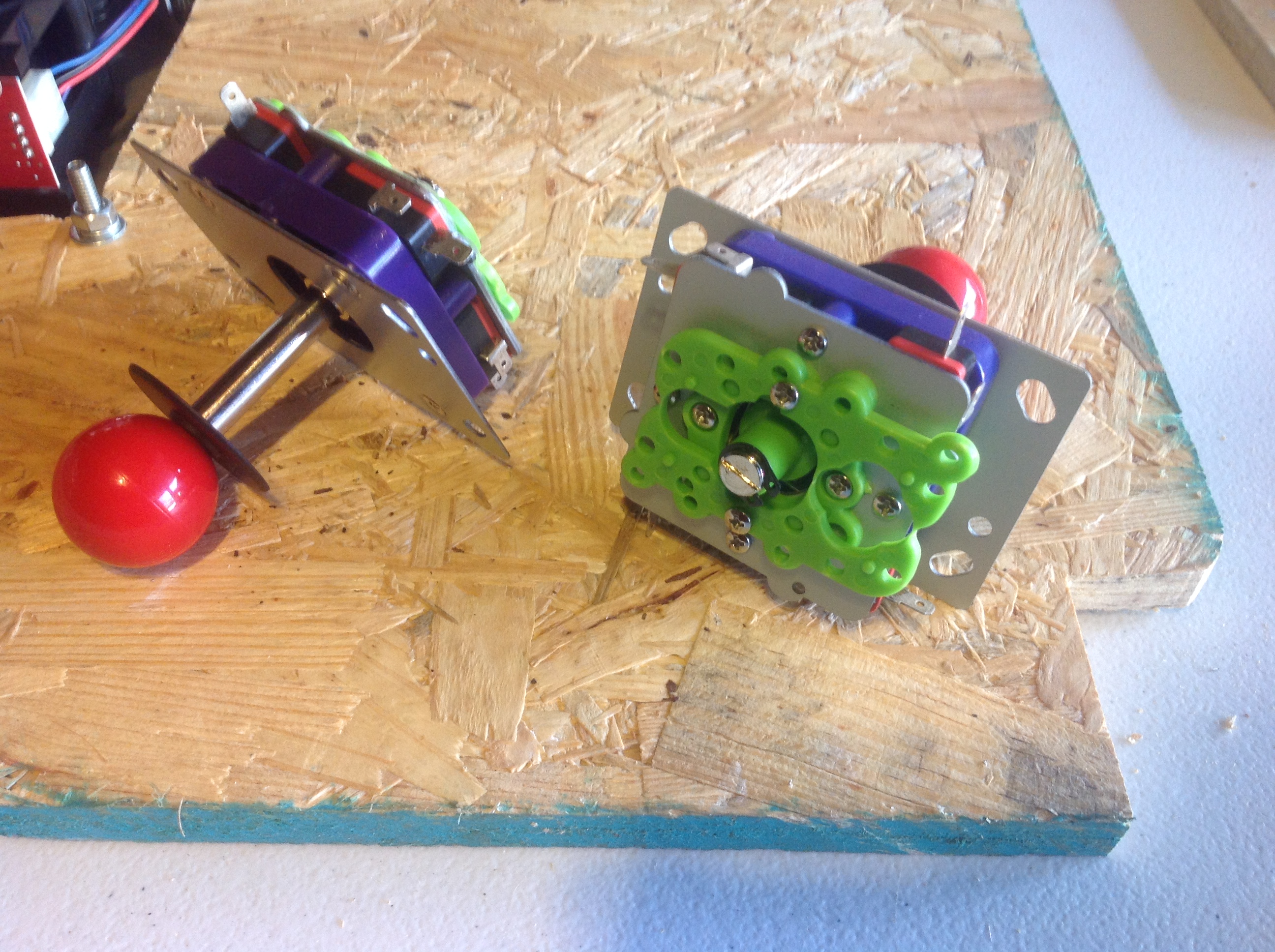

Here is where I need the advice of you pros-- When the artwork comes back, how in the world am I going to make a perfectly round cut-out for the trackball? All the other holes have margin for error, due to being covered by the button rings and the joystick dust-washers. But how do you all cut out clean holes for a trackball in poly-laminated vinyl?
Control Panel Mock-Up
I had some spare OSB laying around, so thought I should practice on it. I laid the original CP on top, traced it, cut with a jigsaw, and there it was. Note that I did not recess the trackball mounting plate, as this is just a test.

Next I dropped in a long-shaft Zippyy I picked up on eBay to check the height. I read somewhere that the suggested height of the exposed shaft should be 1" between the control panel and the balltop. I tried it and didn't like it. Too short for my taste.
So I had to recess the joystick mounting plate in the underside of the CP. And this required taking apart the joys.
Here are the Zippyys-
Broken-down Zippyy-
Routed out 1/8" from the underside of the panel-
I know the serious builders make jigs for this sort of thing, but I find a steady hand and a clamped 2x4 does the job just fine. Now if this was on the top of the panel, you probably would want a jig to hit it perfect.
Screw in threaded inserts from the bottom...
Note on the threaded inserts-- This piece of OSB is 5/8" thick. The original CP is 3/4" While the inserts show through from the top of this test panel, they should be hidden below 1/8" of the top on the final panel.
And getting threaded inserts screwed straight into OSB is impossible, which is another reason you'd never use this for a real control panel.
After putting the joys back together--
