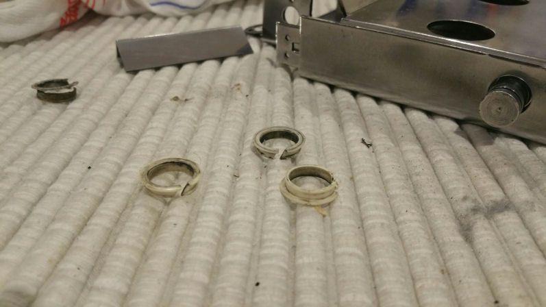

Hi folks,
I am in the process of restoring some old atari arcade pedals, and i need to replace a few of the small bearings that fit around the ends of the axle that the pedal pivots on.
They look like this :
Anyone know where I might find something like this? No idea where to to start the hunt! Or if it's maybe impossible and I have to get something custom made.

Those aren't bearings. Search "nylon bushings".

Better yet, search for "Nyliner".
I bought them here a couple years back while rebuilding the pedal for a Road Blasters.

Thanks guys! I thought htye were bushings too but the manual listed them as bearings for some reason. Now I just need to figure out the size of these things in inches hehe

I just noticed that the link I posted came up empty.
Hopefully this one works.
http://bayareaamusements.com/Merchant2/merchant.mvc?Screen=SRCH
If not, just search for Nyliner on Bay Area amusements.
What Atari machine is it?
If I remember correctly, my roadblasters used 3/8" & 1/2"
I seem to remember my roadblasters manual listed the size
Otherwise just measure the holes.

mgb, These are equivalent pedals to the super sprint pedals, but they are configured with a microswitch instead of a pot so I am not sure _exactly_ which atari machine they are from.  I think you are right though, either 3/8 or 1/2 inch. I ordered a couple of samples from the link you suggested so I'll see which ones fit  :cheers:
