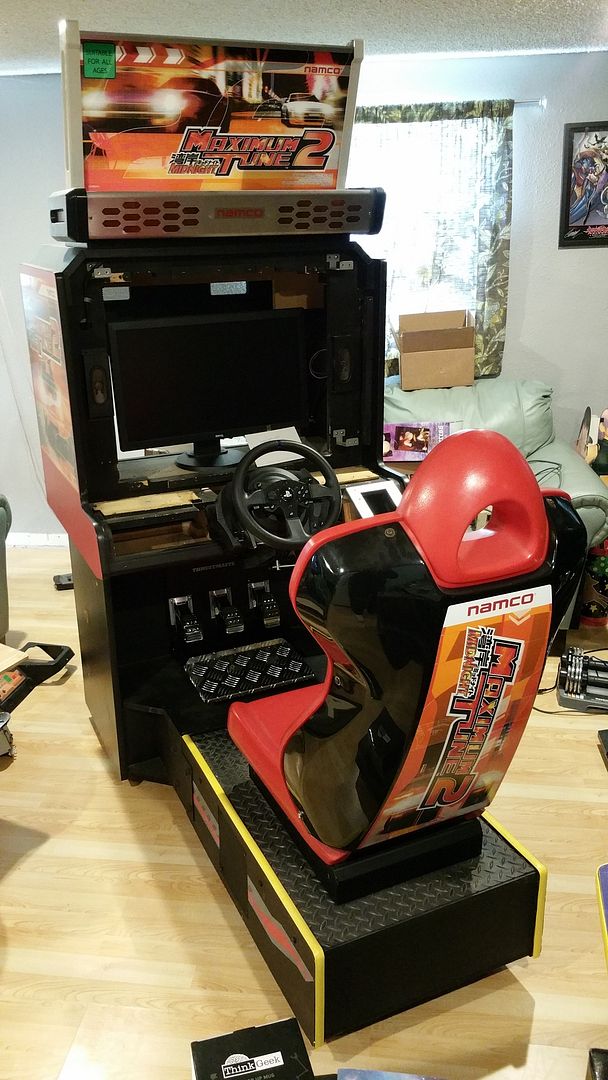

Hey guys I am new here but I would like to start the Official Thrustmaster T300RS + T3PA-PRO ADD-ON + TH8A Add-On Shifter topic. I recently  purchased a project cabinet and I am in the process of converting it to a Demul, Mame, PC , PS3 and PS4 cabinet. I know that Sony has had a long standing relationships with Logitech (soon to be Logi) I am really interested in this wheel because of the add on and the quality of the wheel as a whole. I have started learning a lot form BadMouth's Arcade Cabinet Guide (http://forum.arcadecontrols.com/index.php/topic,105961.0.html). I got to admit I jumped into this project without knowing anything about the difficulty of creating a racing cab but I like a challenge
 If you want to follow my cabinet project this is the official thread: http://forum.arcadecontrols.com/index.php/topic,146057.0.html
Here are some pictures of the wheel. To note the add on work on the Xbox One wheel as well so I could technically switch this thing to an Xbox One cabinet on the fly.

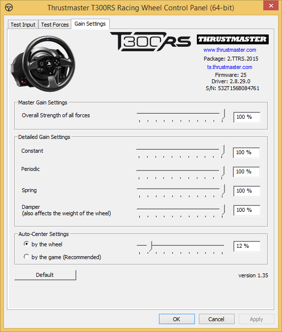

So I set up the wheel and updated the firmware to the latest that Thrustmasters has to offer. This is my first semi pro wheel and I have to say I am pretty happy with it. I know that most people use Logitech G27 and I am thinking about picking up the G29 to do some comparisons. For now I will focus on the T300 RS, I will be posting some video diaries of my project, there will be a ink to the first video further down this post. Here are some pictures of the current state of my rig.
I just started learning about racing game emulation and through some of BadMouth's post I have learned that limiting the radius of the wheel is essential for many arcade games, 180 degrees and 270 degrees if I am not mistaken. The box for the Thrustmaster T300 RS and the information found on the website state that the wheel can be limited from 270 to 1080 degrees, I thought I would be limiting myself since some games work on 180 degrees, but to my surprise the software allows you to limit it form 40 to 1080 degrees.
I played around with the wheel radius limiter and found that the wheel will auto stop at the designed radius once you set the limit through the software. Feels like it does this via magnetism but I am not sure. I don't know how the Logitech wheels do this so if you have some feedback regarding this please let me know.
I decided to test out this wheel with a classic, Datona USA. I set up Nebula's Model 2 emulator and quickly got things running. I put a video together for you guys, here it is. I will do a little more technical version later today.
I haven't played this game for a long time but it seems to work and feels like I remember. I have the wheel set to auto center when released, I set this through the actual Thrustmaster software. There is an option to let the game dictate how the wheel works but I haven't tried that option yet.  The wheel when set to auto center give you a bit of resistance when you turn it, not too much and it kinda feels just right. I have the wheel limited to 270 degrees (just took a guess that this game was a 270 degrees radius game) and it seems to work really welll with the game (meaning the game responds well to small adjustments in the wheel). Well guys, I am still learning but I hope I can bring something to the tablet to these forums, Thanks for playing!
« Last Edit: December 29, 2015, 11:31:40 am by Blackknight2000 »

Thanks for posting pics of the wheel settings in windows.
It's good to see what options a wheel has without having to buy it first.

Thanks BadMouth, you've been a big help with my project so far. I wanted to start this thread specifically to talk about the Thrustmaster T300 RS and how it works with emulators and systems like the PS3 and PS4 as well as how the wheel works with specific games. If anyone out there has this wheel and has some suggestions on how to run it with certain emulators and games (suggested settings) please post to this thread.

Aright guys! WOrked on this project a little more today. My goal was to get another game that I love up and running and see if it works well with the wheel. Going with the Thrustmaster as opposed to the Logitech seemed like a gamble to me so seeing if it works with my favorite games is a must. So the game is... CRAZY TAXI!!! I got it up and running using Demul.  I put together a video showing the game working while I talk about the wheel and how you go about setting it up in case any of you are interested in looking into it. Here is the link to the video.
Also here is a look at the other two option taps for the device options for the Thrustmaster t300 RS
