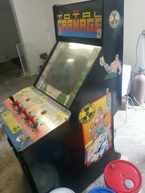

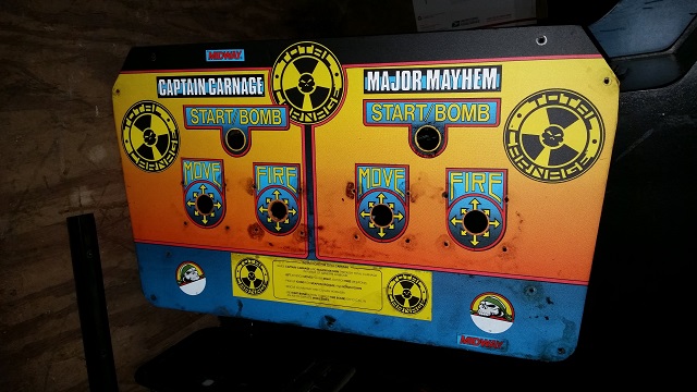

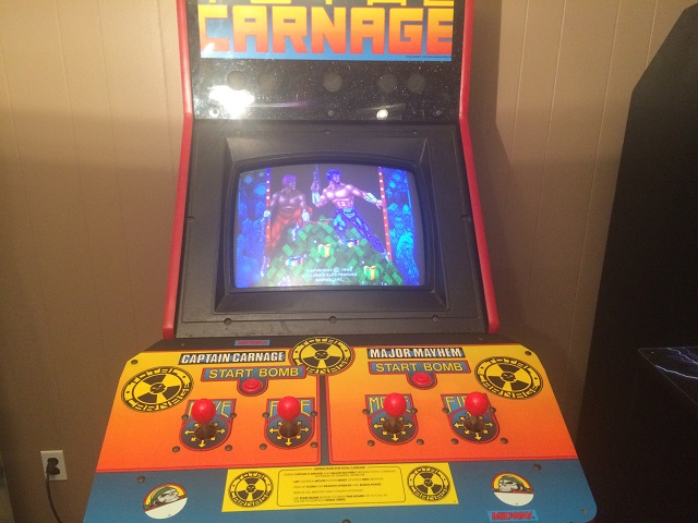

Well, to make a long story short, I "re-acquired" my Total Carnage/Smash TV 2-in-1 machine.  It was in decent shape, but the monitor was removed and I needed to re-do the control panel, so that the sticks are lined up properly.  In the long run, I plan to make it a 3-in-1 with either Robotron (I need to purchase the PCB and modify harnesses obviously) or maybe a 4-in-1 with Karate champ (I already have the PCB for this one and again I will need to modify the harness to make it JAMMA).
For reference here's my old video of the arcade game in action with the 2-in-1 JAMMA switcher installed:
Here's a pic of the machine in it's previous state:

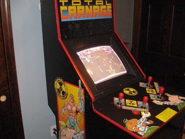

Update:  Here's the completed pic with the new CP installed:

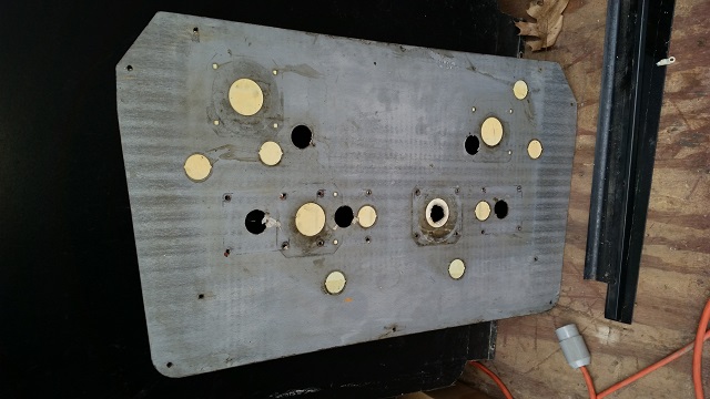

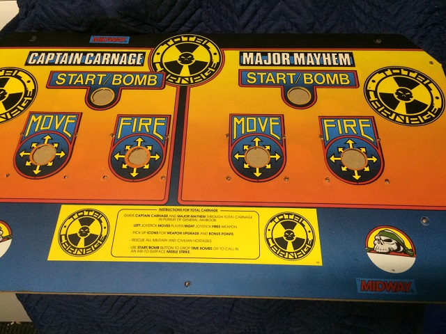

Now that I have the machine back, the CP was my main focus.  I found a guy on the Mid Atlantic Pinball Arcade group who (by sheer luck) had grabbed a converted Total Carnage cab that was also a previous Gauntlet conversion like mine.  The CP fit was an exact match.  So naturally I expressed interest.  We ended up working out a deal and he mailed the CP to me.
It was in rough shape to say the least: (before)
But with Magic Eraser it cleaned up fairly well: (after)

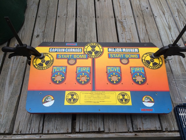

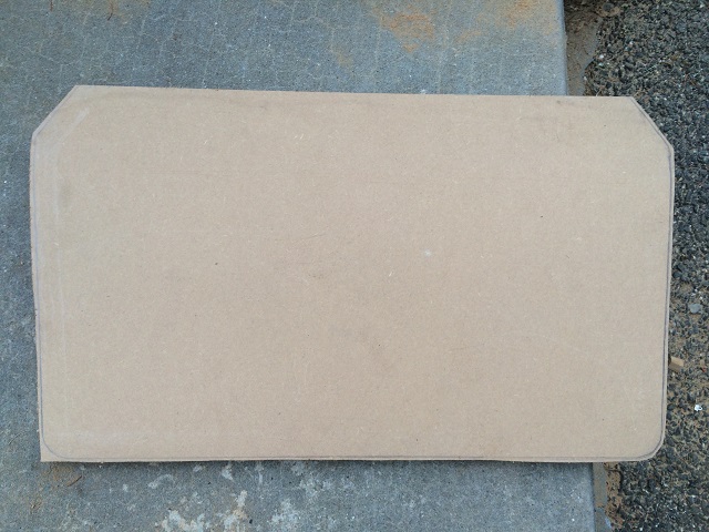

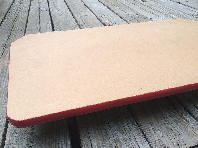

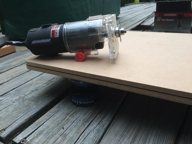

On the replacement CP, I noticed that the artwork was getting chewed up by the rotation of the player one firing joystick.  Looking on the back of it, I discovered why:  The hole that was being used was the "bigger" hole from the original joystick.  Because of this, I decide to not use the plywood from the replacement CP.  I used 3/4" MDF which should solve the problem once I cut the proper hole size.

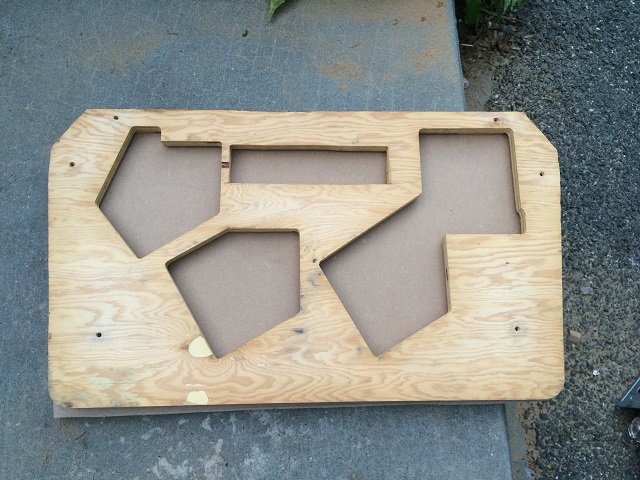

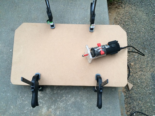

Using the original CP's wood as a guide, I traced and roughly cut the MDF to size:
Then I flipped it over, clamped it down and went to town with a flush bit on my router:
(by the way, I found out the hard way that the bearing on the flush bit should be on the tip of the bit, not on the inside.  I tried a bit with the bearing on the inside and the bearing keep "riding up" the bit and falling inside the t-molding groove.  The 2nd bit with the bearing on the tip worked perfectly:  lesson learned).

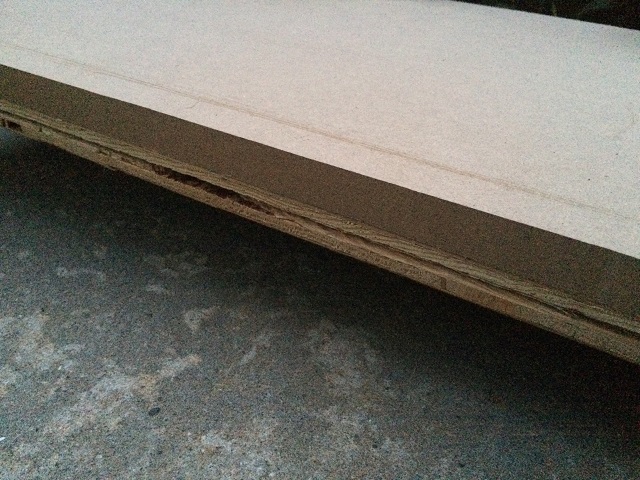

Just to give you an idea of how chewed up the t-molding groove was on the original panel:
Here it is after routing it.  I did a test fit and the metal CP on top lines up great.  Now I needed to route the edges for the t-molding:
Success!

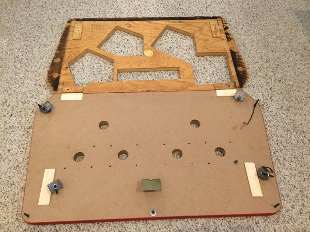

Now time for the holes.  I don't have many pics of the process, but I basically used a forstner 1-1/4" bit, lined it up with the hole on the CP and gave it a tap to mark where to drill on all of the holes.  I then removed the metal CP and drilled away.
Here I'm lining up the hardware trying to match where they go based on the CP.  The small pieces of wood are free Home Depot paint stirrers cut to size!  They go along the inside of the cabinet when the CP rests on top to give it a snug fit.  I'm gluing them in place and will finish up later once they dry.
More to come later!

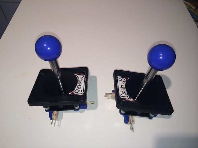

Oh, and did I mention that I will probably be using Dominux 8-way joys in this update?  I ordered blue ball tops with the intention to use it in another project but I will order red ball top replacements for this project.   :applaud:

So far they are great on my existing panel. They work great on Robotron, Smash TV and Total Carnage. They also feel nice on other 8-way games. However for Fighting games it's hard to get the moves/combos out. Probably because I'm so used to my Happ and Sanwa joys:  This one takes a bit getting used to for those games.  Which is why I'm making them dedicated in this Total Carnage/Smash TV machine.

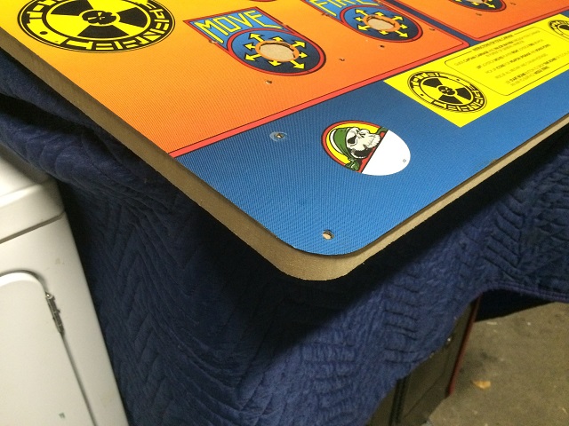

So I opted for no plexi. It just feels better to me. The CP is not perfect in a couple spots so no biggie anyway. It's a game about war so bring on the battle scars. Lol.
I did work on it a bit over the long weekend though.  My first task was to fix the chewed up artwork on the 1 player Fire joystick.
I used a Dremel with sandpaper to trim the artwork to the new sub panel I cut earlier.  I was able to simply use the newly cut hole as a guide.
Before:
After:
Del

I started test fitting the hardware into the new panel.  Originally, when I had test fit the new Dominux joysticks on my old panel - They had a long throw; meaning they would hit the sides of the larger 1-1/2" hole when playing.  On this new panel I accounted for it by cutting a smaller 1-1/4" hole so that the actual hole would act as an external "circular restrictor" making the throw shorter.  I could then adjust the leaf switches underneath if needed. (This was never an issue with the original Happ Super joysticks I had in there already; they never touched the sides).
I ran into a slight hiccup.  Since the metal portion of the CP was slightly smaller at 1-1/8", the Dominux joystick shafts would hit the metal part of the CP instead of the wood, scratching the shafts.
I corrected the issue by using a grinding bit on my Dremel.  I then followed it up with a sanding bit to smooth it out.  It helped tremendously and solved the problem.

-  Modded the joysticks to have custom restrictors that prevent the shaft from rubbing up on the side of the metal CP.
-  Painted the inside of the holes black, as suggested by DJFan.
-  Tidied up existing wiring and connectors. (This will be upgraded in the future with a quality JAMMA harness with -5v)
-  Installed a 2 in 1 adapter (This will be upgraded in the future as I add games)
Although I had smoothed out the edges of the CP, I still found the metal edges rubbing against the metal shaft.  It played just fine, but I wanted to add something to prevent the metal CP cutting into the joystick shaft with heavy use.  So I thought long and hard and while browsing Jimbo's project Jimbovision, it came to me:  http://forum.arcadecontrols.com/index.php/topic,141562.msg1510166.html#msg1510166
I would have a piece of Lexan in between that I could cut smaller so that the shaft would rub against the Lexan instead of the metal CP.
Through trial and error with different hole sizes, I came up with 7/8" for the hole size.  It was a perfect size that allowed the shaft of the joystick to hit it and not touch the metal portion.
Here's the final Lexan piece that I created to sandwich in between the joystick and the control panel:
Here it is over the Dominux joystick:
Here it is installed:
When pressed to the side the shaft is close to the edge of the metal panel but does not hit it:
The result:  A perfect feel!  No more metal.  The joysticks felt perfect!  The machine was now ready for the show.  My buddy and I loaded it up into his truck.  We brought it to his warehouse where all of the machines were being staged for transport to the show on Saturday.  (By the way, the red casters shown in the pic below are awesome.  Got them at the Home Depot for $9.99 each and they match the theme of the cabinet.  Plus they are STRONG since this cabinet is HEAVY and they lock in place after moving)

Thanks for posting that trick with the lexan.  I'm looking to swap out the joysticks on my TC and may run into the same issue.   :cheers:

Thanks for the write up - an interesting read. I was thinking of the Dominux joysticks myself for Robotron but was worried about the throw distance after reading this (I appreciate you can alter the leaf switches but I quite often like to ride the gate). Your mod sounds like a great solution - thanks for sharing.
I wonder if Randy would consider producing a circular restrictor option (like Andy does for the U360s)  for those of us who prefer a slightly shorter throw
RandyT
  • Posts: 7024
    • GroovyGameGear.com
Re: Total Carnage/Smash TV CP Makeover - COMPLETED
« Reply #38 on: October 16, 2015, 12:53:29 pm »
Sure!  DeLuSioNal29's modification is very similar to the way we already restrict for 4 way and octagonal. The only difference is that we laser cut the profile of the part, and set it inside the top lip of the base, so it's nearly flush.
The only issue is that the amount of throw someone may like is a bit subjective.  But if DeLuSioNal29 doesn't mind sharing what he found to be optimal for this particular unit, I could use that as a starting point.
BTW, DeLuSioNal29, I did get your email. I'll shoot you a reply shortly, but I'd like to publicly thank you for going through the extra effort of showing off the Dominux8 sticks.  I'm glad to hear that everyone enjoyed using them!
