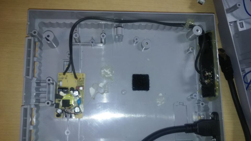

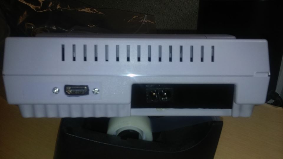

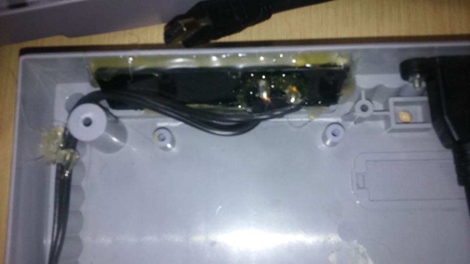

Got my Raspberry Pi and want to do a project. I love the retro console mods, so gonna do one of those.  Stuffing a Pi into a SNES case.
Parts:
Raspberry Pi, model B (Older B, not a B+)
SNES case
Mauseberry power switch
I still need:
HDMI panel mount
Ethernet panel mount
4 port USB hub (to stuff into cart slot)
Various jumpers to move signals around the system
I'm still torn between wiring SNES controller ports to the GPIO and using the original ports or just using a SNES->USB adapter and mounting those ports into the proper place.  Either way I want it to use SNES controllers, not USB ones.  I don't like the look of USB ports on the front of a retro console.  I'm also considering just using wireless 360 controllers since I've got the 360 wireless dongle and that works on the Pi.
Dismantled the SNES into component parts and spent about half an hour with some abrasive scrubbies cleaning it.  Got it looking pretty darn good.
Gonna use the power switch that is original to the SNES, the reset mech needed to be reworked though.  Ground down the mech that was under the switch and just glued a standard microswitch in place.  Works just fine.
Currently have a single player SNES->USB adapter that I shaved down a little to fit into the front plate of the console.
(UPDATE) Decided against doing this and wired the real ports to the GPIO - Post below.
I'll be attaching photos to this post later tonight.

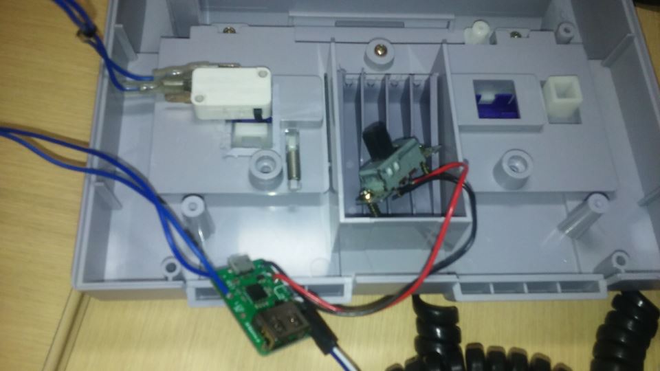

Having problems with the Mauseberry power circuit...
Got it yesterday and wired it up to the power and reset switch.  The reset switch fires an immediate hard reset, so that works.  Tried to install the script from Mauseberry's website and it borked.  Turns out that their script is trying to use some directories that don't exist in the Retropie distro I am using.  Since I am new to Bash I'm not entirely sure what the setup script is trying to do so I am looking at other options.  Found a nice Python script that should work and installed it - no good.  It choked trying to use the GPIO library, apparently the Python GPIO library isn't installed in this distro.  No problem - grab the library and install it...  Security error now.  Ugh.
Losing my mind now.
Just as a test, I do a vanilla install of Raspbian using NOOBS.  Run the Mausberry scripts and...  it works just fine.
So - looks like I get to learn Bash a little better and figure out how to modify these scripts to work with Retropie.
Oh my god...  I'm a dumb ass.  The setup instructions have 3 different scripts for 3 different distros.  When I was trying to get it working with Retropie I was using the WRONG flavor.  When I plugged in Raspbian, I used the correct flavor.  I just used the proper flavor and...  TADA!  it works just fine.

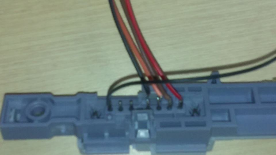

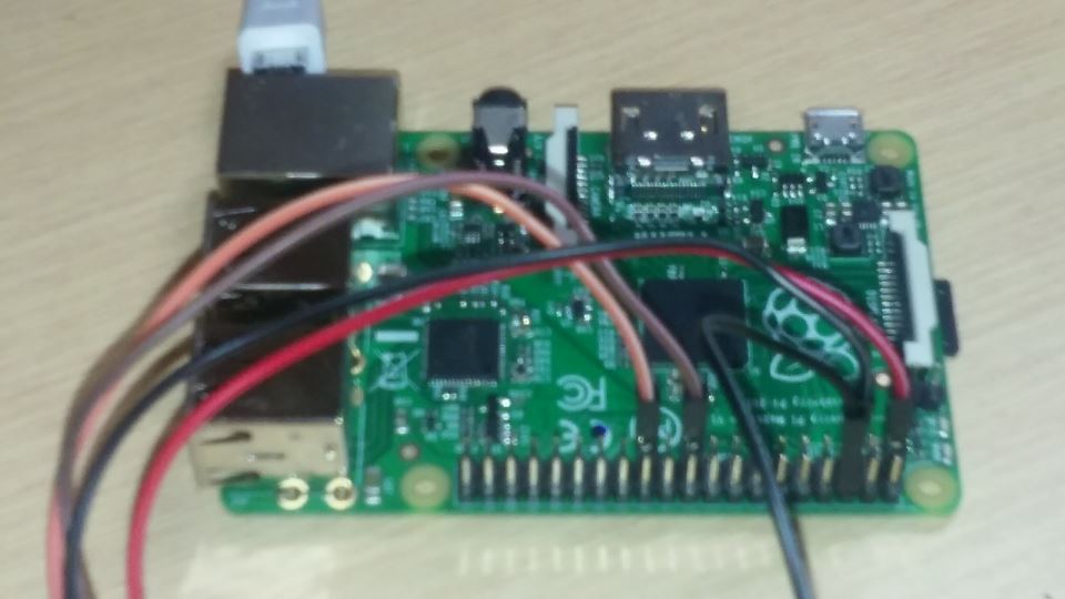

Did some more work on this beast the other day.  Got the original SNES game ports wired up to the GPIO pins.  Player one works like a dream now.  One of the super generic off-brand controllers I had misbehaved in a weird way, but the other off-brand and the OG SNES controller both work great.  I took the build over to a get together at a friend's house last night and hooked it up...  it was being played all night by an assortment of people.  Made me so proud.

Major update!
Mausberry power switch wired up to the switches.  The slider switch is the original switch.  It mounts on a pair of studs and mates into the recess seen on the right (white square).  The reset switch housing I ground down and hot glued in a microswitch.  Slider is wired as power, reset is wired as reset.  The white and blue wires plug into the Pi.
I decided I wanted things to be as simple as possible, so I am only breaking out power and hdmi.  Can't really see the power port in the pic though, sorry.  It's a standard two pin connector, round-round.  The HDMI is not on the same plate due to mounting issues
Inside that power connector is screwed on to a punch out plate that I made from some scrap plastic which was then hot glued (god I love that stuff) into position.  The cord was then routed around to a decased USB wall wart.  I pulled it out of the casing to make mounting easier.  When it is all assembled there is a small USB jumper that connects this board to the Mausberry power circuit.
The RetroPie image has a GPIO driver called GameCon already loaded.  It uses a kernel level routine to read gamepad input, with far less lag than a user space driver.  It has to be activated though, and it required my Pi to have completely updated firmware.  Not a problem though, just another command line and some waiting.  Right now the system is only wired for Player 1.  Player 2 actually just splits most of those connections, there is only one wire for P2 that goes directly to the Pi, the data line.  I just need to splice some jumpers between P1 and P2 for the clock, latch, power, and ground.  Then some shrink tube and all is good.
Everything I've got here has been tested and works - took the half assemble beast to a gathering the other day and it was played for hours.
« Last Edit: August 25, 2015, 07:59:30 pm by Slippyblade »
Re: R-Pi SNES retro console project
« Reply #38 on: August 25, 2015, 08:20:50 pm »
Major update!

As far as the eject goes, I cut off a lot of the internally projecting bits and the main part is held in place with a couple drops of super glue.  I wanted the outside to remain as original as possible.  I'm debating whether to wire up another microswitch to the eject lever and use that as an "Exit Emulator" switch.
I also intend to mount a USB port and possible an Ethernet breakout into the cart slot under the spring flap.
