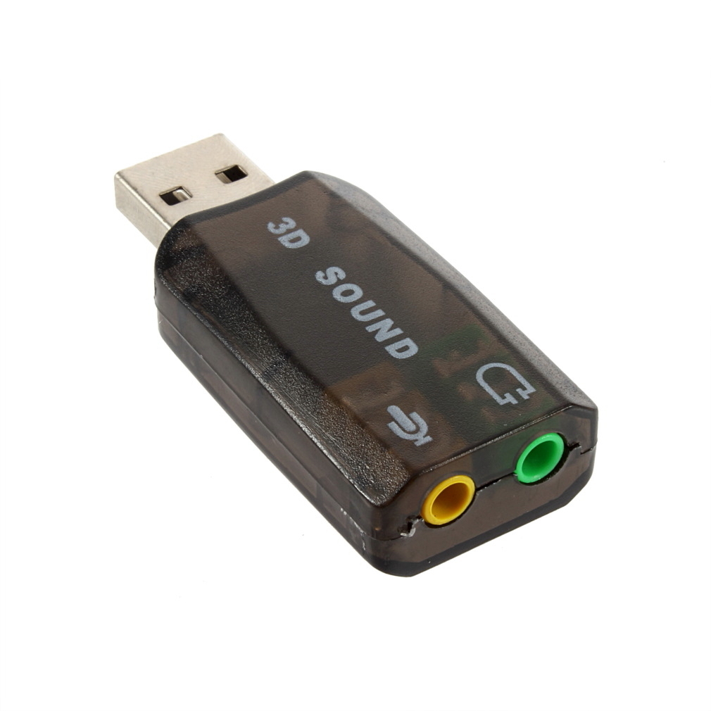

IF using windows they have very cheap USB souncards that work fine I bought 3 of them for old MOBOs with broken onboard audio and they wound up being plug and play and use pretty much the same chipset as the onboard audio (realtek) so work fine with a set of PC speakers.
IF you have time to wait for them to come from CHINA ( about 3 weeks) they are only about $1 each. ( http://www.ebay.com/itm/USB-2-0-Audio-Headset-Microphone-Jack-Converter-Sound-Card-Adapter-FE-/331427372076?pt=LH_DefaultDomain_0&hash=item4d2a9c5c2c ) If you need one faster send me a PM with your shipping info and I'll send you one of the extras I have (bought a couple extras when ordering since they were cheap.)

Thanks guys. Good ideas there. I hadn't even thought about the USB dongle, even though I bought one some time ago to get around a similar problem! (must be getting old).
I bit the bullet and instead of waiting for 3 weeks + for my $1 dongle, I paid 300% more for a local one. Works a treat (",)
