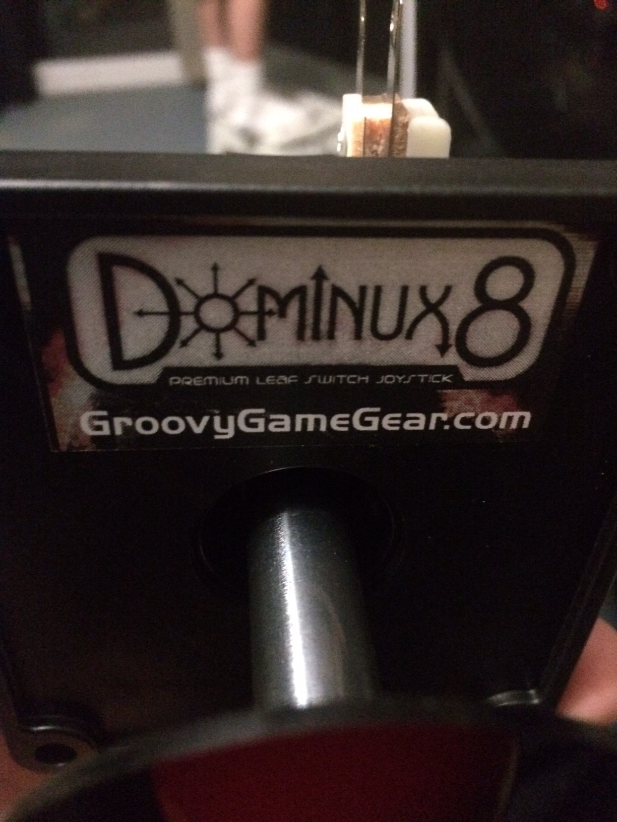

So anyway, Lets check this bad boy out:
This stick does really ooze quality. To me, a centering spring just doesn't feel as good as a rubber centering grommet like this stick has.
The reason I recently installed a Crown stick on my machine was due to it having a rubber centering grommet but the one on the Crown is much lighter than this one.
This stick feels great so far (uninstalled)
It's got a sleek logo sticker that will never be seen when mounted but nice touch anyway.
The plastic body is very constructed and clean of molding lines and all that. very firm.

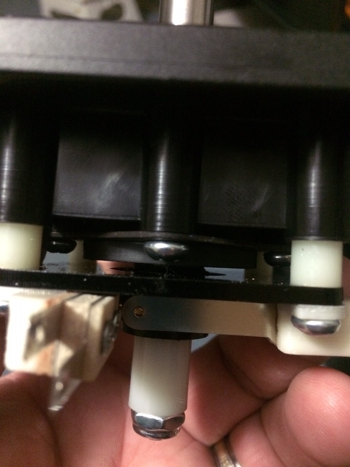

I bought a used stick to try and thought I'd point out what I consider a slight design flaw in an otherwise nice stick.  To be fair, the failure on the stick I recieved may have occurred in shipping,  and I'm not pointing fingers at anyone in particular but it does point out a weak point that could be fairly easily redesigned.
The plastic (they appear to be 3D printed) pieces that hold the leaf switches are secured to the shiny black piece mentioned above by a Phillips screw and what appears to be superglue.  On the used stick I recieved, one of the the superglue bonds has failed and the Phillips screw is just stripped to the point where the leaf switch is no longer held securely in place.  Movement of the shaft against that leaf switch moves the switch and holder rather than activating it.
I'll probably be able to fix it by applying more glue to hold the leaf switch holder back to the black plastic piece, but I'm concerned about the longevity of the bonds on all 4 of the pieces.  The fix would be to redesign the 3D printed pieces so that they have a 'lip' of material that protrudes down the sides of the black plastic.  This would provide a great amount of support to keep the pieces from being able to shift and eventually spin free.  I wouldn't think it'd cost much more for the extra material needed compared to the extra strength it would provide.
I've attached a photo with the failed leaf switch holder facing down.

Yeah you're right about the switches. Thanks for pointing that out.
I noticed there being just one screw holding each switch on and I thought that was a little odd because I saw no sign of any kind of pin or something that protrudes into the mounting plate.
Maybe epoxy would be the best way to get a hold on the flaky switch

The single screw design allows the switch holder to pivot, which in turn allows for fine positioning of the switch during assembly.  Introducing a lip or pin onto the switch holder would negate the ability to account for minor variations in the parts. There are no forces, either in normal use or in the attachment of the wiring, which could conceivably break the combination of the adhesive bond and the screw.  We have about 40 units in the wild now, and haven't had any reports of problems of this nature as a result of normal use.
As the unit in question was purchased "used", it sounds like the previous owner may have disassembled the unit, and over tightened the screw upon reassembly.  But it's difficult to know what a second hand unit was actually subjected to, be it in shipping or otherwise.
It's a fairly simple repair, but as the screw was overtightened, a longer screw may be necessary to reach undamaged plastic. Once the switch is positioned to your liking, you can use whatever adhesive you feel comfortable with to lock it back in place.
