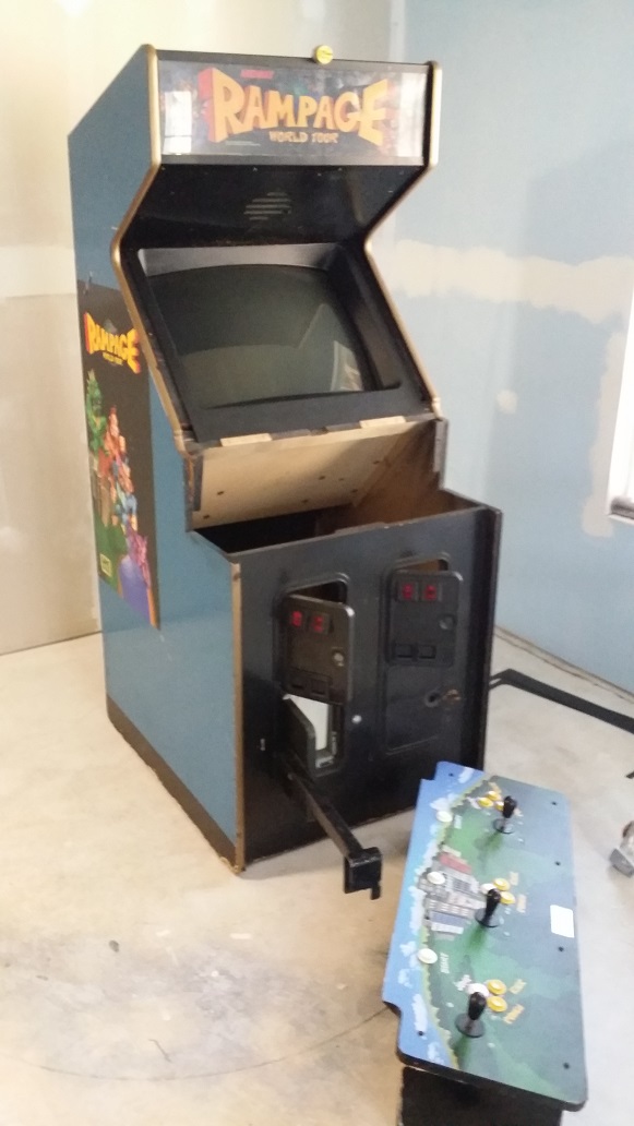

So I for some stupid ---smurfing--- reason traded my pretty great MK1 restoration for this turd.
Here are the major things wrong with it, despite being told it was "in almost perfect shape"
1) Giant bolts and bolt holes sticking out of the 2 sides
2) Giant lock down bar bolted into coin door, that hid a random unused hole between the coin doors, and the 1" hold for the anchor bolt to the right of the coin doors
3) sides are beat up, tons of dents and deep scratches
4) water damage at the bottom of the cab
5) all along the base is pretty much destroy, not a single straight line to be found
6) Was told this was an Xmen cab, ended up being a TMNT cab (Only 1 speaker hole in the top of the cab)   I had already started buying Xmen items (like CPO and PCB)
7) Monitor is too big for the cab, as in, depth. the rear door was cut and boxed to compensate for the chassis sticking out of the back.
8) The wiring, was OF COURSE, all hacked up to make Rampage world tour work
9) etc

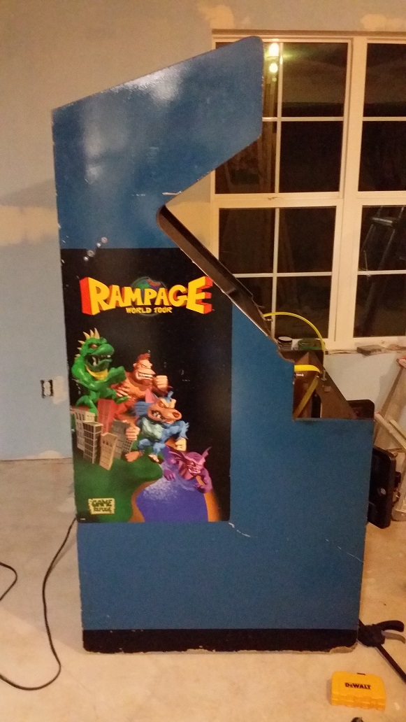

Here's a crummy side shot:

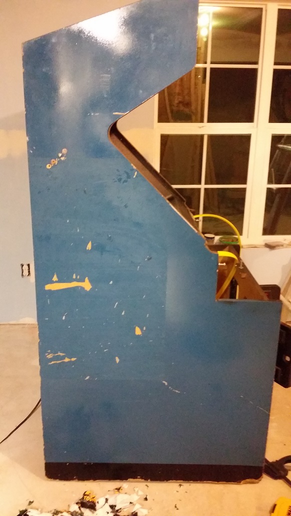

So I started removing the side art:
Little bit of heat gun, and elbow grease with a scraper and its all off:

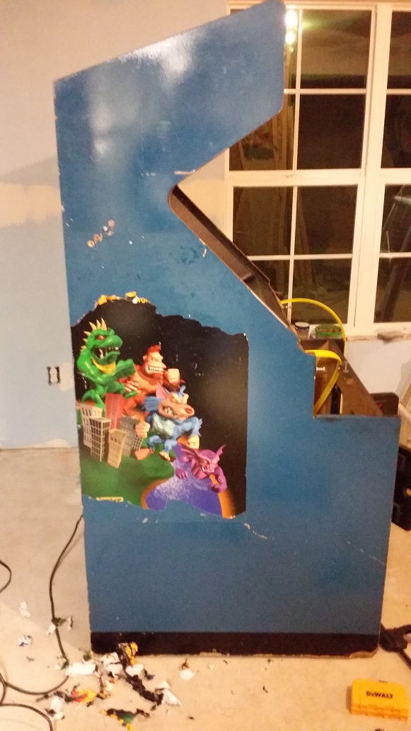

and heres whats left of the side art on this side:
There some little issues, like this:
but thats fixed thanks to gorilla glue:
sanded and prepped better but no pictures of that , yet.
