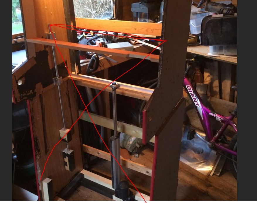

Ok, some progress now, but I think I need a bit of help at this point maybe with some ideas.
I've fitted the main lifting ram/actuator, and it has no trouble whatsoever lifting the top module up & down.  It stops automatically when it gets to the end of its travel so no worries there.  It's even relatively smooth, and I suspect that once it's full of stuff like the monitor and other electronics (ie extra weight) it'll be smoother.
The problem I've realised at this point is that it's when at the top position it's susceptible to quite a lot of wobble, and this needs to be resolved.  I don't mind if it can move a tiny tiny amount since any mechanical device would have some element of play/backlash, but it's not stable enough at present.
Here's a couple of pics of it with the ram fitted, extended to the up position:
Now in an ideal theoretical world the metal bar I've fitted across where the ran attaches, might stop the top section from wobbling, but with this gauge of metal, the weight and leverage & general physics etc involved there's not a hope of that.
You can see how it works though - the ram raises & lowers and the slider rail at each side smoothes & guides the cabinet to move up & down.
The issue with that is it's a lot of potential leverage on those rods and their mount points, plus there's nothing to guarantee that they both move up & down by equal amounts constantly other than the theory of the ram being in the mid point and being balanced (as best as is possible).
So it works, but not well enough.
So ideas are requested here on how to ensure the sides of the top module to not either have the freedom to rock/tilt forwards & backwards, or effectively rotate from side to side (ie one rod being lower than the other etc).
I wondered if adding some drawer runners (assuming they're decent ones that don't have lots of play) would do the job, but they need at least 13" travel.  I think they would prevent it from tilting forwards/backwards, but not from side to side, unless perhaps I fit a second pair on the back of the cab?
I'm all ears anyway guys.  Itching to do more but don't want to until I resolve this as it's a fundamental thing that it has to be steady when raised (when it's lowered it sits on its lowest 'stop' points and cannot really move so that's not really an issue).
Thanks for any ideas!!!

These are the sort of things I'm thinking of - say one on each side to complement the existing rods/bearings, and one pair on the rear of the cab.  Given the construction/nature of these, there shouldn't be a lot of room for them to bend across their width (not thickness - if that makes any sense), so hopefully by covering 3 sides it'd keep it all pretty solid, but smooth with the bearings in them?

I would be concerned that adding more things with basically the same goal and system (like adding drawer glides to the existing rods) would only add more points for binding and potentially make the movement jerky without really doing much to solidify the cabinet in the tall position.
The linear guides and rods you're using typically are supported on both ends with the item moving on them being mounted between the rigid mounts of the rod. I know that doesn't work here but could you brace the top of the rods to each other and/or add some diagonal bracing from the top of the rods to the bottom or back of the cabinet? Any wobble you are getting is probably the result of the rods flexing or moving in their wooden mounts in the bottom cabinet, if you can brace the top of the rods to each other and also brace them down to the back of the bottom cabinet at an angle you will be able to get rid of a lot of the flex.

Hmmm, looking at the pics again, I think a brace for the top of the rods wouldn't be as easy as first thought.
The issue is that when it's lowered down there's a lot of those rods exposed in the top half, without much support, but then when it's in the low position the cabinet is pretty secure anyway, so not an issue at that point.
In contrast, when it's raised, there's a little of the rod exposed at the end, but the only thing to secure this to is the top section itself, which it already effectively is secured to by the top pair of linear bearings (hope this makes sense), but a big distance between the top section and the bottom of the rods where they secure to the bottom section of cabinet.
BUT, if I perhaps ran a thick/solid spine piece or two from the lower cabinet up behind the whole thing (ie two beams with little to no flex) then it could have brace pieces that reach in from those to secure on the top of the rods.    They'd need to be no taller than the top of the machine in its lowered state.  This would then mean both ends of the rods are effectively secured against the main lower section of the carcass.
Hope I've explained that in a way that makes sense.

If I'm reading your response correctly you are talking about the linear bearings themselves bracing the rods, but the problem is that the linear bearings are attached to the moving part and not the stationary part so the space between rods is fixed but they can still sway in relation to the lower cab and therefore the player. The super quick crappy red lines in my attached image show where I would add braces, 1 between the two rods at the top and then one from each of those corners down and back to the rear of the lower cab, creating a cross-brace that ties the top of the rods to the bottom of the cabinet.

Yes of course!  Thanks - I see now.  Your awesome 'artists impression' is just what I needed. :)
That makes a lot of sense.  The only thing I would have to be careful of is bringing those braces near the front of the lower cabinet since they would cause a major obstruction to the fold down seat section (ie the front panel of the cabinet with side panels etc.  I'm sure I could work round that though and possibly include what I'd described as well too.
Thanks so much for the suggestion!

Actually - I've just been and had a look at it and given it a wobble and on reflection I'm not sure the cross braces you describe will help.  When it's lowered they will help secure the tops but that's not a problem anyway.  When raised though, the rods can't sway other than forwards/backwards (due to any movement/weight of the top cab tilting).  The side to side movement is the top cab and linear bearings moving on the rods (one side up one side down, only a little) even if the rods are perfectly still.  Shouldn't really be able to with two of those bearings per rod as that should provide quite a bit of rigidity but my guess is the rods are just a fraction of a mm below the ideal diameter and this provides enough slack for it all to flex since any tiny movement there is amplified as a fulcrum point.
I might try it anyway in case I'm overlooking an angle to this.

I think I have another solution now actually.  A mixture of ideas.
My friend called round and suggested I put stops on the two rods, above the exact position of the upper linear bearing.  This 'should' stop the side to side movement it can do when raised, since it prevents either side from moving any higher.  I.e. one side cannot rock lower, if the opposite side cannot move higher, and vice versa.  I think it's a great idea, and easy to implement.  I may include some sort of rubber damper so that it's easier to exactly align the stop point of the ram, with the limit positions of these new stoppers.
So that should solve the side to side motion.
Re' the front to back tilting, I still think a strong wooden spine (or metal box even) on either side at the rear of the cab, can have a brace extending inwards to prevent the rods flexing forwards & backwards.
I'll try to draw a picture as it might make more sense.

Here's what I mean - the little red donut type bit gets fixed to the rod (screw through it) - not secured to the top cab half.  But it prevents that side of the top cab moving any further up than the actuator limit by rocking.  Same on other side.  Ergo, it can't then rock side to side.
The spine bit at the back shows on the inside of the cab but would actually be behind it all, but basically a solid timber running up the back, with a brace that comes in to the top of the rod and prevents it flexing forwards or backwards.  Therefore the second axis of unwanted movement is fixed.
Or something.  Hope that makes sense!!!

Well I got the top stops fitted to the rods last night, and also the 'spine' pieces at the back, with angle ally tethers reaching in to the top of the rods too.
All seemed to be VERY nicely working in terms of stability, except that the bracket holding the top pf the ram then broke (it's a handlebar clamp from a minimoto, made of crappy cast alloy).  I'll sort the other one out and refit it.
I just bought some of the drawer runners I described in B&Q so I might add those potentially instead of the rods, OR at the back.
The only real issue the whole mechanism has now, is that it binds in places.  The problem is due to tolerances in the assembly of various bits of wood  I should have really welded up a box steel frame then added panels afterwards.  Will inspect it now and see what spare bearings I've got, and where I can add them to help it run smoothly.
Getting closer to it working nicely though.

Ok, I've spent the last couple of evenings making a right dog's dinner of this to be honest.  I've been going about it all wrong, and in all honesty, probably based around laziness.
I've had the lift motor attached and it was all able to move up & down, albeit a bit jerky and not how I wanted it.  So each point I've noticed a problem I've tried to correct, and this has gone on & on over a couple of evenings.  I did fit a set of 24" ball bearing drawer runners at the rear as well to help smooth it out.  Well, in hindsight, unsurprisingly it's made it all worse.
It suddenly dawned on me (as it should have at the start) that I should not even be considering adding the motor until I know it can move smoothly and freely by hand up & down, otherwise I'm set from the start for a load of hassle, and that's exactly what's happened.  Took the motor out and found it was horrible still with bits binding and out of alignment etc.
So tomorrow evening all being well, I'm going back to the start of this slide process.  The new drawer runners will be fitted first at the rear, and carefully aligned so that the monitor module A) goes up straight (ie isn't attempting to creep towards one side or the other, and B) that they are nice and parallel to each other, so that it doesn't move freely in one bit but then pinch up further up or down the axis.
Once those are in place and it slides smoothly, I will then be in a position to re-align & re-attach the linear bearings/rods closer to the front of the cab.  I presume it will take a bit of mucking about at this stage to get it right but given the time I've wasted already I don't mind.  Once they're correctly aligned & in position it should be able to lift up & down freely by hand, without any tight spots.  Should also be fairly secure at this point in that it should neither be able to rock side to side, nor tilt front to back since it also has the spines/anchor points etc.
Then, and only then I'll re attach the lift motor, and see what happens.  It's so mind numbingly stupid not to have done it this way to begin with that I'm annoyed with myself.  Too keen to make it happen without planning it properly.

Success tonight at last.  Top half of cab moves freely up & down by hand & then subsequently by motor.  Yahoo!!!
Stops nicely at both ends of the actuator travel and is basically free from side to side wobble, or front to back rocking/tilting.  Result!!!  Very pleased.
So the next phase is to attempt to make a fold down front panel that houses the seat etc.
Wish me luck, but hopefully I think that's the worst of it done now mechanically speaking. )

« Reply #37 on: January 27, 2015, 07:15:40 pm »
I think this is all I'd need for controlling the direction of the top half of the cabinet actually, linking the power supply to the motor?
http://www.ebay.co.uk/itm/201255011472?ssPageName=STRK:MESINDXX:IT&_trksid=p3984.m1436.l2649
Should be the same for the ram that hopefully will move the steering wheel in & out of position too, but I've not got the measurements/angles etc quite right for getting that all figured out just yet.

Any double position, double throw switch that can handle the current would do.
The one you linked to is just pre-wired for that purpose.  For that price why not.
If you want choreographed movement of multiple things, you'd need a motor controller.
https://www.pololu.com/category/94/pololu-simple-motor-controllers
I used one of these for my monitor rotation.  It can be controlled via batch file or autohotkey script.
You might have to add a heatsink depending on how much current you're pulling.
If going that route, I'm thinking a switch under a cover wired to your keyboard encoder which triggers the script.
Might require an emergency stop.  :D

Thanks - have got an estop I could use from my partly finished CNC machine conversion.
I've bought a couple of those switches but unwired and I'll add that myself as there didn't seem to be pre wired ones in the UK so I'd have been waiting weeks.
Yeah I use Pololus on my 3D printer and on a timelapse rail i built so I like those, although with these being normal 2 wire DC motors I think I need a more basic DC controller like LN988 or whatever the last one I got was....
I can then use an arduino to control the timing of each event potentially rather than have to press each button manually.  The difference will be the seat section can probably be released and lower smoothly down on gas struts but will have to be lifted by hand back up again.
