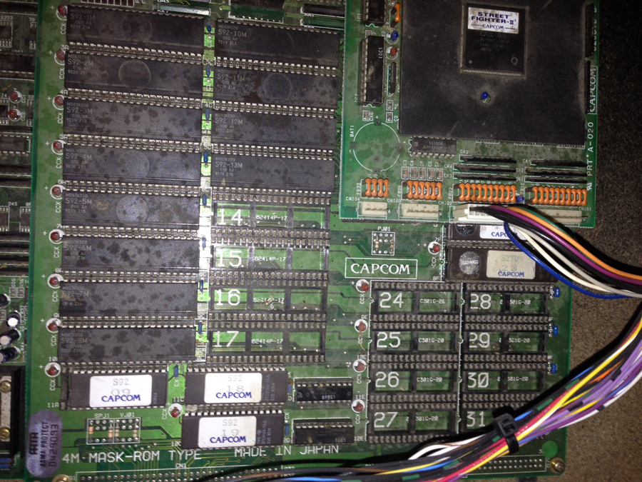

SF2, all except Super SF2 flavors, were CPS1 and didnt have a suicide battery.

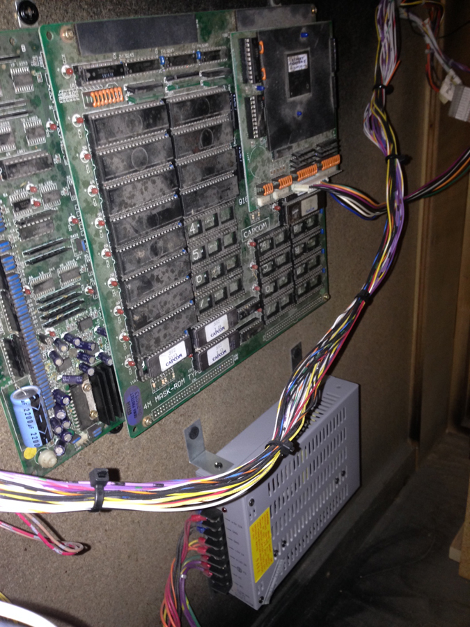

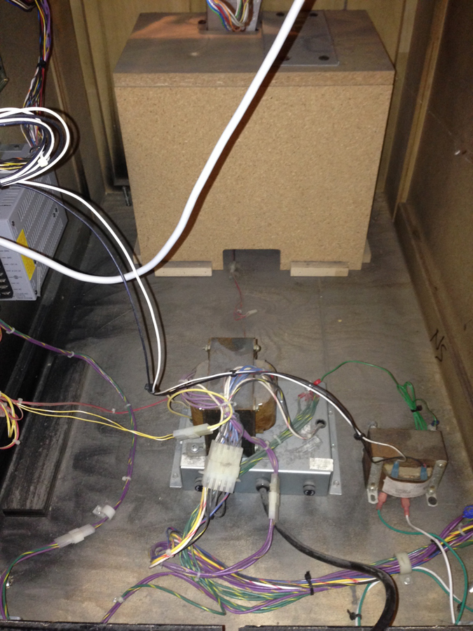

(3) I'm not 100% certain of the Capcom board but I took couple pictures here:
http://www.ryanpaulyoung.com/SF2/SF2-Board1.jpg
http://www.ryanpaulyoung.com/SF2/SF2-Board2.jpg
http://www.ryanpaulyoung.com/SF2/SF2-Back.jpg
(4) Unfortunately I do NOT have another jamma board to swap out or test.
I purchased a decent multimeter (sorry, this is my first rodeo  :banghead: ) and am very confused by what I see so far. While checking for AC voltage (testing the two AC screws on the Peter Chou power supply) I see the proper 128-131 volts. But when I set the multimeter to test DC (testing the ground screw and the +5V or +12 screw) I get between -0.74 volts and -0.80 volts??????? I get the same reading when I test anything on the board too  :dizzy:
Any ideas? If you guys need more detailed pictures, just let me know. And thanks so much for your help!!!!!!

That is a CPS1 board.  You say you dont have another jamma board, where are you located, maybe someone near to you can lend you one?

sounds like the PS is bad by what you're describing. I say order one, worst case you'll have a spare.

I would pretty safely bet the power supply is just blown. Its very typical.
I would just order a new power supply.
http://www.twistedquarter.com/index.php?main_page=product_info&cPath=335_336&products_id=4
The one test you may want to do first is to remove the +5 and +12 volt lines off the ps and then test the power supply just to verify its not the board bogging down the voltage but I'm pretty sure you'll still find no voltage.
When you do change out the ps, its important to have it properly adjusted.
Without the board connected, quickly turn it on and maje sure you have 5-5.2 volts at the +5 volt output.
Then plugin the board and metter for voltage at the board this time (not at the ps)
You'll probably see about 4.8v or so.
Adjust the ps knob until you have about 5.1 v at the board.
