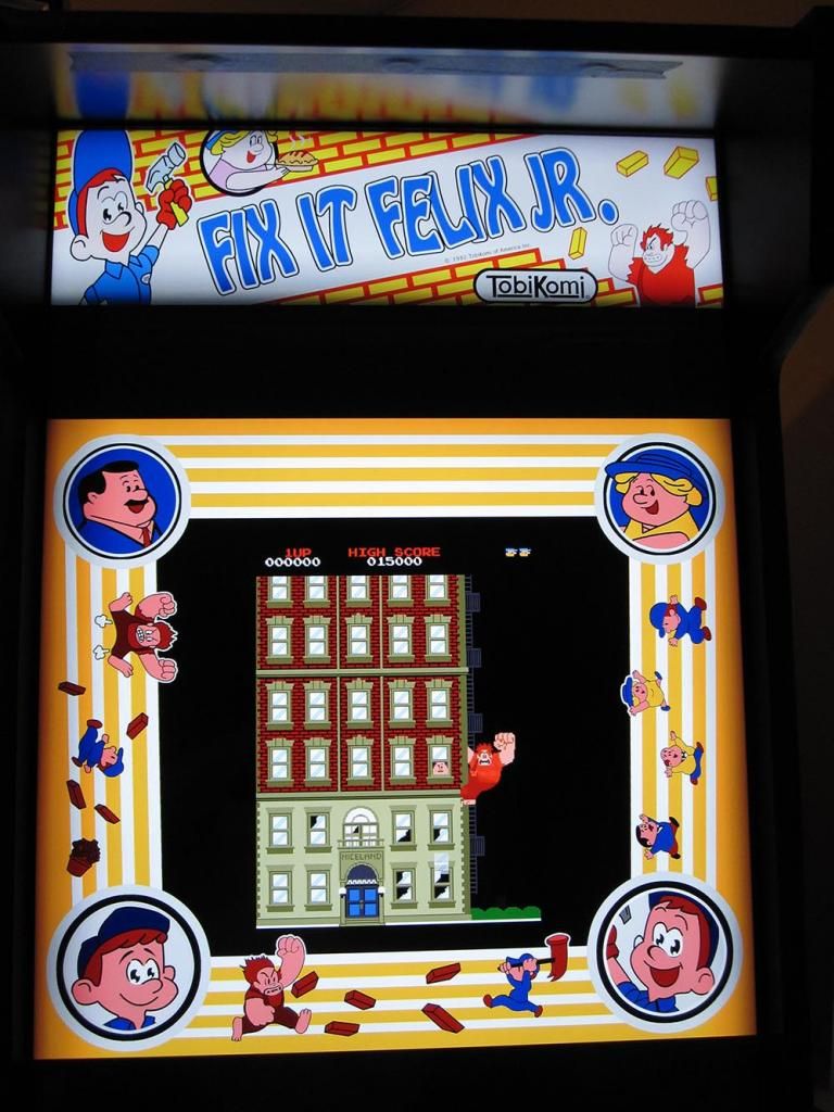

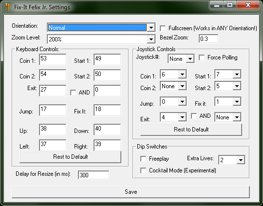

As an FYI, I'm running my monitor/tv in portrait (flipped) mode. I'm using a bezel on mine, so I'm not sure if my settings will help. but, here are my settings for the wrapper:
I still need to tweak the brightness of the bezel, but here is what it looks like on my cab:

I actually had trouble with this as well.  Unfortunately I haven't messed with my pacman cab in a while and I don't think I ever fully resolved it.
The issue isn't with my wrapper, I believe it's the game itself.

I was able to get mine to run pretty close at 200% also, but since it wasn't fullscreen when I launched it from Hyperspin it came up behind the FE.
Yeah Howard I am pretty sure this is an issue with the main program, not your wrapper.  I've done so many tests and tweaks honestly I'm a little lost on what helped or hurt and where the problem is.  I need to spend a couple more hours testing out all the different issues to know 100% where the problem was.  I was hoping even if the problem is with the main app, since you have the wrapper running so well horizontally that a fix vertically wouldn't be too tough.
