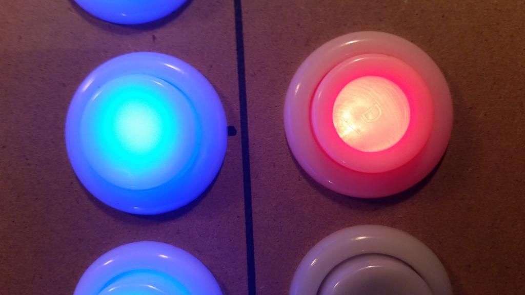

I bought some Electric Ice buttons online from another arcade enthusiast and noticed that there is lettering that appears to be engraved on the inside of the plunger... I only notice it with red LEDs... Is this normal?  Or were these modified?  They appear to be A-B-C-D...  I'm not sure if it could be the LEDs I am using are brighter than the ones GGG sells?  I'm using 5mm 5Vs  Which I think are the same?   Any opinions are appreciated...

I just installed EI2 buttons and using the Helio9 LED's (very very bright) and that is definitely not the case, no letters... maybe Randy can chime in here.  That red button actually looks quite strange, its super bright in the middle and dim elsewhere, it shouldn't be as far as I know.

The buttons in the photos are the original EI buttons, not the current EI2 buttons.  The original buttons were made from existing molds, which had a mold cavity identifier inside the plunger.  With normal lighting, these should not be visible, but you can see that with intense lighting, they are.  They are also a different material.  A diffusive element placed inside the plunger would probably help with this kind of lighting.  Grinding the top of the LED flat could also be of benefit.
The current EI2 buttons are from our own molds, have a diffusive surface (no identifiers) inside the plunger and are better for high intensity lighting.  They also have a very different bezel and plunger design.

Randy,  I was considering ordering the button blaster LEDs off your site... Do you think those would be an improvement or should I just bite the bullet and order a whole set of the EI2s? I tried grinding the LED but it just got worse oddly enough...  Appreciate the advise everyone!

The LED's might be just too bright for these early buttons.  I have a better solution for you. Send me an email and I'll tell you how to order some diffusing elements from us.
