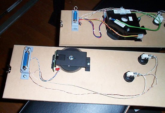

I'm still looking for a good solution to clamp down my control panels.
The main trouble is that I have 5 control panels (and parts for about 5 others)...
But I don't have a good way of locking them down.  I'm looking for a generic solution that I can buy one side or the other by themselfs (so I don't have to buy 40 pairs of both the male and female side... since I will only use 1/2 of them).
Also, something that I could buy at a normal store (home depot or something) would be great!
Anyone get selenoids to work clamping a control panel that work well?  I wouldn't mind spending some extra cash if I could have a lock button..  That would be pretty cool.

I'm using almost exactly that setup.   I originally thought I would need one at each corner but it turns out that I only needed one on each side.
This is the bottom of my control panels.  Notice the clip at the far left.
Here is the roller side (inside the cabinet):
In my case it works perfectly.   Easy to pop in and out, holds very good, and I don't have to do anything behind or under the cab.   And those clips are relatively cheap at Lowes.
There is another type of cabinet latch that I tried first.   It has rollers that spread apart and a single "pin" that pushes in between.  Those did not work well because they allow too much vertical movement because the rollers are on springs.
