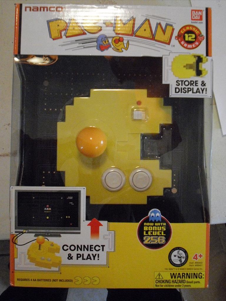

First thing I needed was to source one of the PNP units so I took a trip to the local K-mart and discovered that they had just received a new shipment of the Namco Pacman units for $25 ( they had been OOS for several months so I thought I was going to have to resort to Ebay for a used unit.)
Got home and had to test it for awhile to ensure it worked correctly so put in some batteries and hooked it up to the TV I thought would be used in the build - an old 13" Disney Princess TV that my neice had outgrown.
Everything worked fine but there were a few problems - First being I had started looking at designs for the unit and was leaning toward a Weecade Clonish shape which this TV would not easily fit in unless I really scaled it up and I wanted something with a smaller footprint. Second and more of a problem was this TV did not have a button to set for AV mode (you had to use the remote control to switch to AV mode and it did not stay in AV mode when turned off) - so after some contemplation (and purchasing an AV to Coaxial converter at Goodwill for $2 that bypassed the second problem) - I decided the 13" TV was not going to work for this build. So started looking for other options.

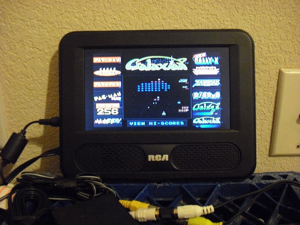

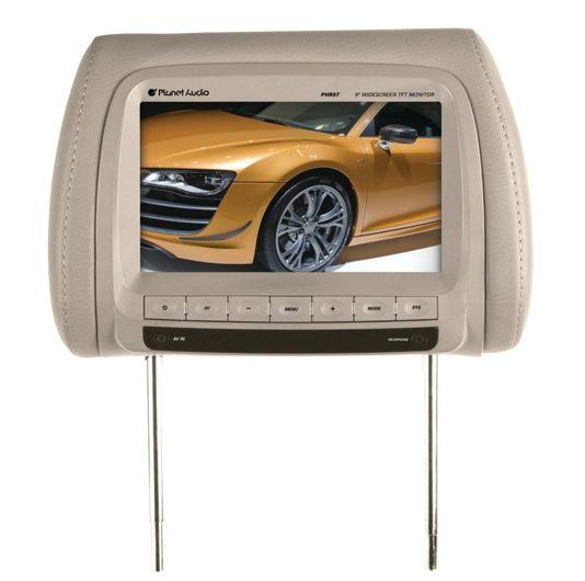

At this point I came across a 9.2" headrest monitor that Walmart was discontinuing and selling for $29+ shipping - which I ordered.

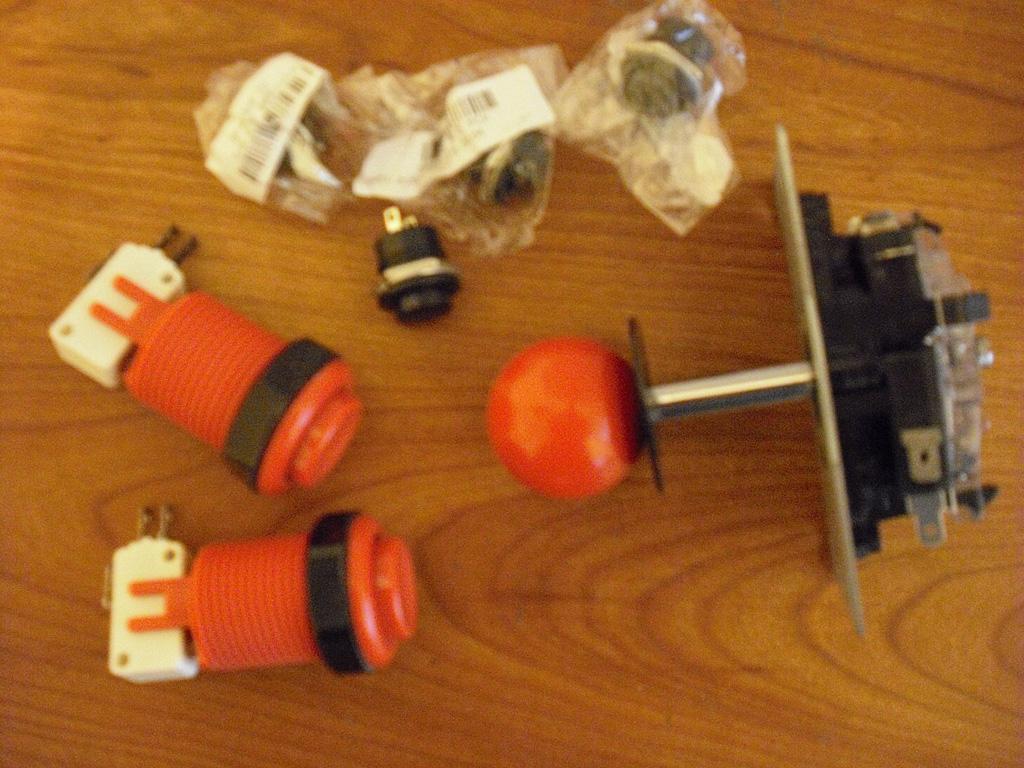

Also ordered the other parts I would need ( Joystick $12 , buttons $3 ) and began waiting for the parts to arrive.
Fours days later -- I receive an E-mail from Walmart saying the item is OOS and they do not know when it will be restocked so my order has been cancelled. :angry: Soooo back to looking for a monitor solution -- Finally ended up on Ebay and found a 7" DVD player secondary monitor for $16.71 shipped and went back to waiting.
3 days later the monitor arrived so hooked it up and tested
A couple days later the buttons arrived ( smaller than I thought they'd be so repurposed one into my Robotron build for the on\off switch and removed the red button I was using and combined with the 1 extra I had left over from that build. Then got the next bad news  :hissy:- checked on the joystick tracking and found this :
So thought the darn USPS had sent the joystick back to china !!!!! -- Luckily a quick call to the local branch the next morning found it was a false alarm (they had given it to the wrong carrier thus undeliverable since it was not his route) so was being re-sorted to the correct carrier and he would deliver it that day. )

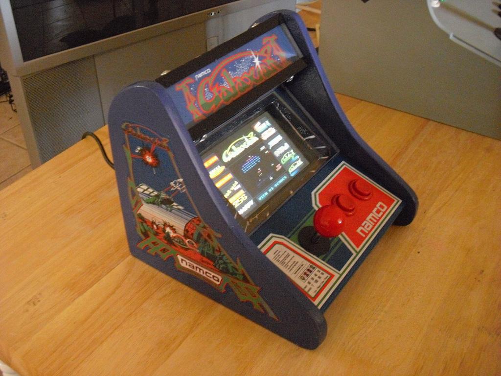

With the cabinet put together and painted and all the Plug and Play parts set up for install it was time for the final steps. I was ready to print a copy of the final artwork on my HP laser printer - only to find that unfortunately the 25 pack of sticker paper I had purchased when building my Robotron bartop had somehow run out ( had 15 or so pieces left after printing the ones I used for the robotron bartop but somewhere along the line my niece had needed some for a project for school ( and after finding she could make stickers with it decided she wanted some stickers for decorating other things  leaving me 1 piece :banghead:
Since I had only the 1 piece I decided to print the CP panel and install it - after printing I found I had not measured the layout very well and things didn't really line up but left it for now until the new paper was sourced. The next day I went to a few local office supply places only to find they wanted $18 for 10 sheets of the paper (had paid $4.99 for the 25 pack so wasn't willing to throw $18 out for 10) so came home and started looking online - Finally found Onlinelabels.com where they had 100 sheets of the paper for $10.45 + $4.95 shipping so $3 cheaper than the local office supply place for 10x the amount of sheets (  :soapbox: and the retail outlets wonder why they don't have people in the stores buying things !  :soapbox: )  During the 3 days waiting for the paper I found that the CP sticker was not holding up very well (Ink was streaking and fading) so was going to need to do something to make it last longer.
So a quick trip to Walmart found a couple possible solutions -- 1.) clear shelving Contact Paper that could be cut and applied to create a laminate layer protecting the artwork. 2.) A can of Clear spray paint to coat the paper pretty much doing the same. 3.) taking the prints to the office depot and having them laminate the pieces -- Decided to first try the spray can so purchased a $4 can of clear Krylon spray paint. Once the new paper arrived I adjusted the CP panel art and printed a new copy of it and also the rest of the art. Cut out the side art stickers and trimmed the CP and bezel art and then used the Clear Krylon paint to apply a thin layer over the prints and let dry. Applying the paint had me worried as at first it appeared to be smearing the artwork but as it dried it turned out fine (just be sure not to soak the print with too much paint - better to apply a couple very thin layers). Once dried I disassembled the CP and Bezel and applied all of the artwork and reassembled completing the build.
Here are a few pics of the final result (I'm very pleased with the result) -- If anyone has questions or needs more info on any parts of the build feel free to ask.
