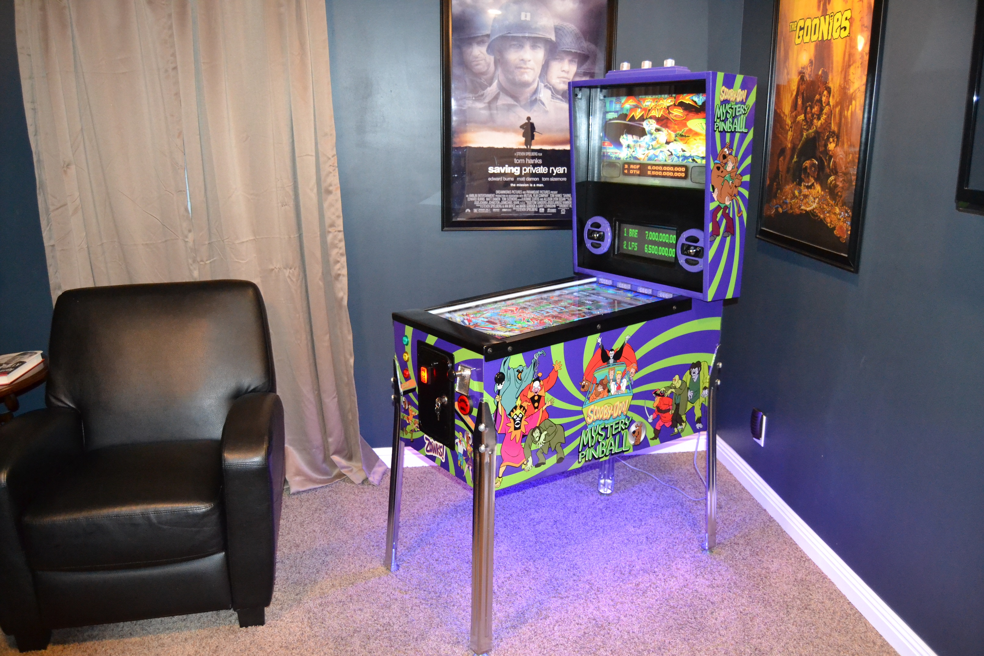

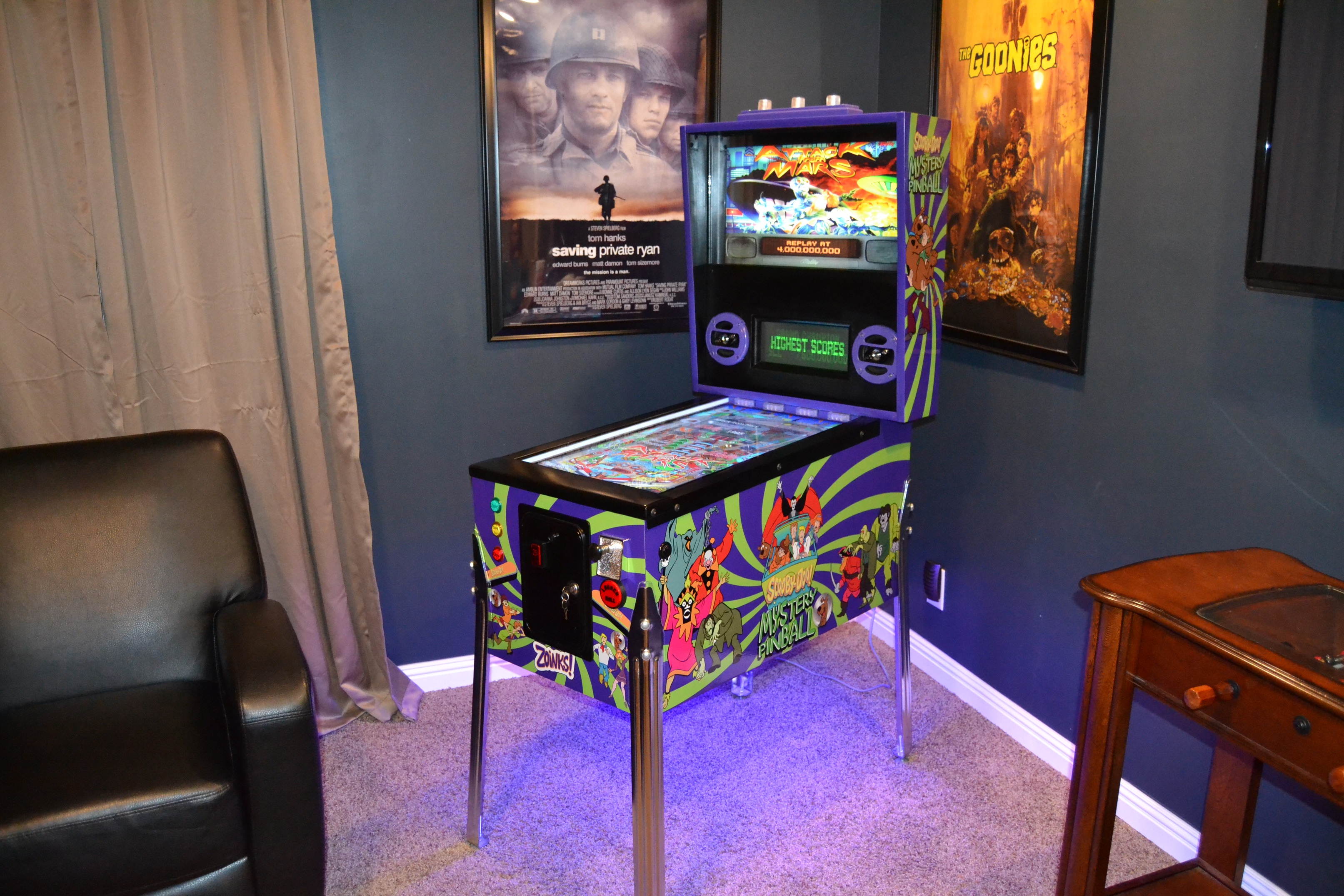

        Well I started I started a virtual pinball project VP/FP. We had an extra 32 inch tv, an extra 24 inch monitor, and a 17 monitor we weren't using. It took a while to convince the wife. She says I get a bit obsessed with them but that is my nature. So she was okay with it so I started. I have read most of these pinball threads and got inspiration. From the Minipin and the Multi Ball madness projects mostly. Also I have read most project threads on VPforum. I have set up both Future pinball and visual pinball. Both were kind of tough compared to Mame. The problem is I don't have a computer that will run it properly. So I will build the cabinet. If I bought a computer now it would sit around for a couple of months while I finished the cabinet
        What I have now:
Emerson 32 1080p Led TV ( Playfield)
Acer 24 Led monitor ( Backglass)
17 inch HP LCD monitor ( DMD)
I ordered 4 Williams black legs brackets and hardware.
         What I need:
Ipac
Led controller
Sound system. ( I may pull one from my old Ms pacman build.)
I have an analog plunger I built but I haven't tested completely.
About a 1000 other things I also need.
Computer. I have a p4, Athalon Xp 2800, and a newer AMD I could use. None of which are very fast.
I will probably build an I5 with a monster video card and about a 1000 watt power supply depending on how many shakers,spinners, and Leds I put on it.
         I'm not one of these guys who put every little part in sketchup. I know what I need to build and if I need to change it later I will. Probably because I am severely impatient at times.
         So I have some basic cab plans but I had to modify them somewhat. As far as a theme I don't know if I want an original or I'll use some I found on the VP forum.BTW they are very free with their artwork over there. I have about 4 or 5 templates I could use. I am leaning towards Monster Bash. My sons and my daughter wants me to use a walking dead theme I have. My wife wants a Mario theme that I also have. So as you can see if is still undecided.
Updated 6/12/14
The Theme is Scooby Doo Mystery ball. Brad on BYOAC is going to tweak it a bit then print it out for me (he's very reasonable Thanks Chance and Yotsya) I'll update when he sends me a draft
Jay

* I painted the glass braces purple to match the T molding
* I painted the LED light plate purple to also match the T molding
* I installed the access door
* I fabricated a custom lockdown bar, puttied, sanded, and painted it.

More update pictures
