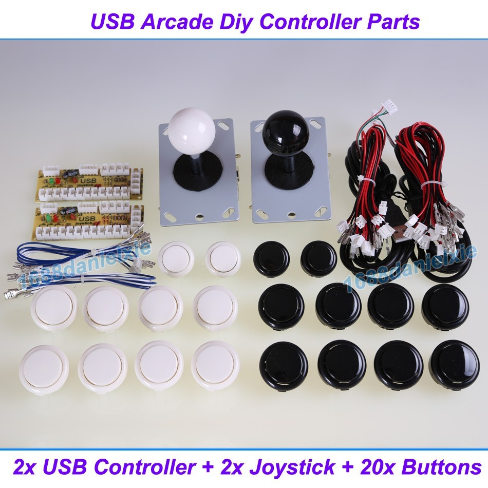

How do you like your ebay joystick and button set? It seems like a good deal.
I'm on the fence about it, but leaning toward the positive side. The joystick seems stout enough, though the stick length is short after poking through the 3/4" control panel. I'll need to route out a pocket I think.
The buttons are okay, though they are friction-fit, they don't screw on like some of the other sets I've seen. Also, the 1 1/8" Forstner bit was too small, and the 1 1/4" was almost too big - the buttons are in the holes and not popping out, but I wouldn't quite call them snug.
The encoders worked natively with Windows 7, I didn't have to manually install or configure any drivers. MAME recognized them as joysticks and getting the buttons set up was easy.
