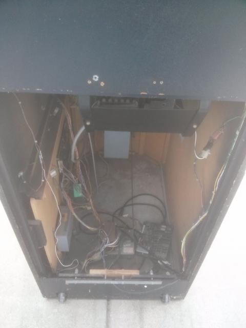

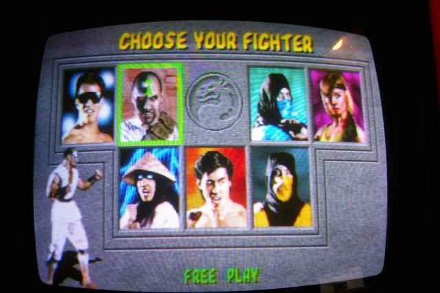

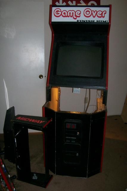

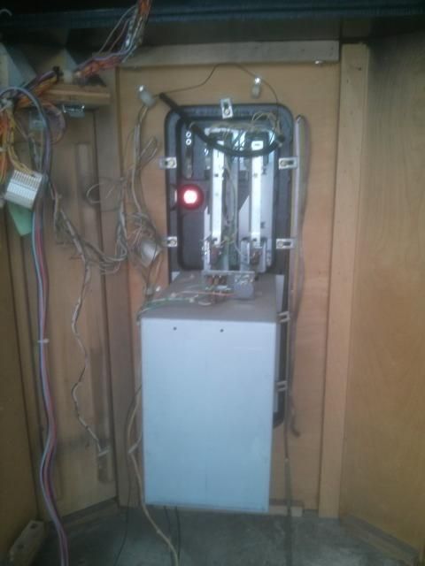

« Reply #14 on: April 26, 2014, 10:00:38 am »

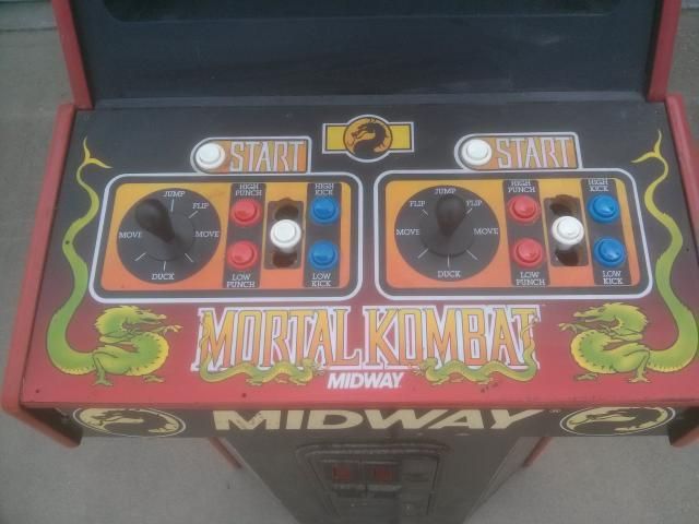

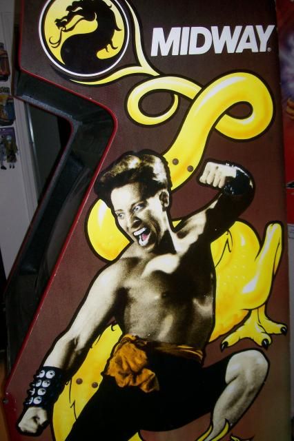

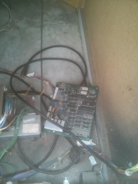

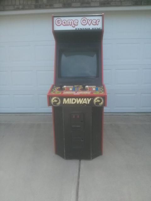

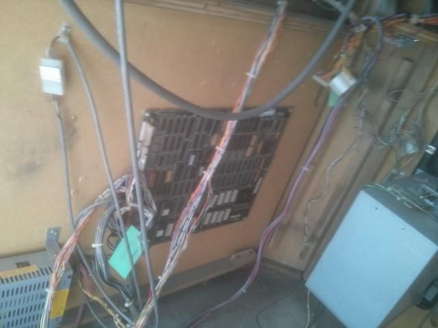

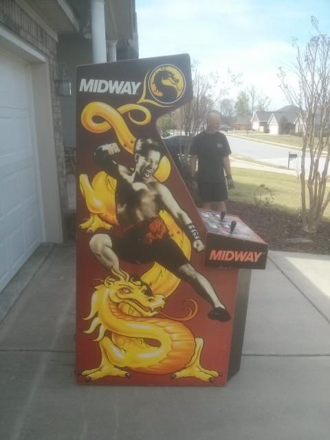

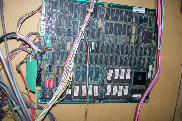

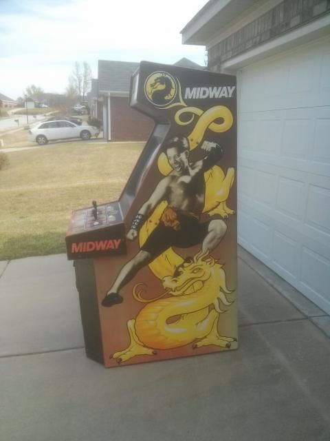

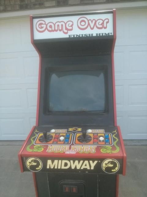

Yeah. I had actually started exercising and eating healthier a couple weeks ago. It should have started a long time ago, but it didn't. It just solidifies what I need to do now and no slacking off. I don't know if it's type 1 or type 2 yet. I have to have the A1C & other blood tests on Monday, then they'll put me on either injection insulin or pills. I'm hoping pills, but because my blood sugar was so high when I was diagnosed (402), they may give me injection-insulin for a short period to get it under control, then switch to pills. My fiance is diabetic so I have a wealth of experience and information there to help. And it makes things easier on both of us when we buy groceries. We're not buying for 2 different diets.
As for the cab...

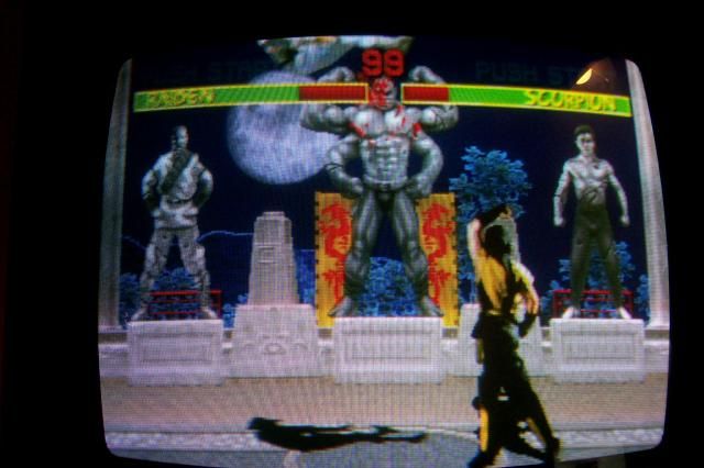

The guy mentioned there is no sound and the colors are off slightly on the monitor, but everything else works. Should potentially be easy fixes. The marquee needs to be replaced with the original artwork, and the control panel needs to be redone, as you can see in the photos. There may be a couple of spots that need some paint touched up on the front and possibly the back. But that's not a big ordeal. T-molding looks alright as well.
I'm not gonna touch the side art for a while. I want to enjoy it as it is before I get them reprinted.
This will be my first real-deal cab. So I'm super excited. Also really lucky that it's the cab I've wanted for a really long time.
Here comes the inevitable question. MK1 Cabs aren't as rare as others, and I want to keep the outside as authentic as possible. But I also would like to put a mame pc in it along side the original jamma hardware. Is that possible and worth doing? Is it easy to switch between the mame & original hardware? Either way I'll need to modify the control panel slightly to have 6 player buttons instead of 5, so I can at least hook up other jamma games in it. Because this will probably be my only cab for a long time. Took too much convincing to get it in the first place. So I want to try to put as much extra functionality in it as possible without touching the majority of the outside of the cab.
I'm not gonna put an LCD in the cab if the monitor is borked. I'm gonna try to find a equal replacement or see if I can find a suitable tube tv.
These are pics of the cab off of the seller's craigslist page.

I say preserve that cab. It may not be an ultra rare cab... like when that guy MAMEd a Computer Space cab  :banghead:, but the MK cab is a bit more rare than the MKII, MK3. MK4, KI, KI2 cabs.

Re: Project attempt #2 - Mortal Kombat restore/mame?
« Reply #19 on: April 28, 2014, 04:16:35 pm »
It looks great.
Don't know any thing about switching between the board and a Mame PC. You could just leave the board in side un attached. I'd post that kind of question to the mane page. Some one here will know.
Note: The monitor can kill you.
I have never owned or worked on a arcade monitor but from my Mame research I have seen projects where people have replaced all the caps on the board, used degaussing coils on the monitor, and some special equipment called a rejuvenator. People go to great lengths to save original monitors. If I was you, I'd ask for help at KLOV. You may get lucky and some one near you may be able to help.
« Last Edit: April 28, 2014, 04:24:25 pm by Locke141 »

You're not going to like the way MK looks when converted from CGA to VGA for an LCD. 9/10 times the original monitor chassis can be repaired for cheaper than it would cost you to get a converter and a new LCD. When you get a chance, post some pictures of the monitor image and chassis so we know what you are dealing with and what needs to happen. you'll be much happier preserving the original monitor.

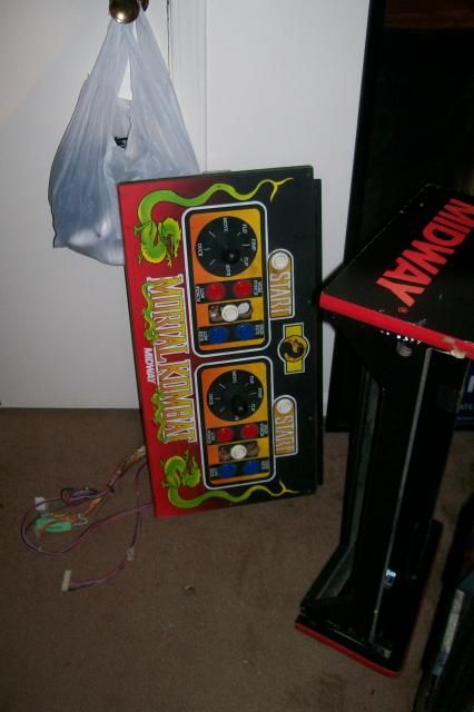

Decided on what I'm gonna do with the cab. And I think I can have my cake and eat it to in this case.
I didn't want to destroy the cab and change the artwork and all that, because the MK1 art is what I love about the cab in the first place. So I'm going to keep all the original hardware & art, but restore & remove the original CP & board and keep it off to the side. I'll build a separate control panel (with original style mk artwork with a 6 button layout), and use a Mame PC in it until I get to a point where I can acquire an LCD style cab to run the mame pc in. Once I do that, I'll swap the panels back and put the original MK board back in and keep it dedicated.
That way I can put the cab back to it's original form once I get a dedicated mame cab that can play old & newer stuff.
I've got most of the pc parts already, but now since I'm keeping the original monitor, and I'm building a separate control panel from scratch (since that won't take too much wood work), what all will I need to make the mame pc work with the arcade monitor? Will I need just an arcadevga card? Or will I need a J-pac & i-pac as well?

Problems with the cab:
- Faded artwork on 1 side and on the sides & front of the control panel
- No sound (because the sound board wasn't connected at all)

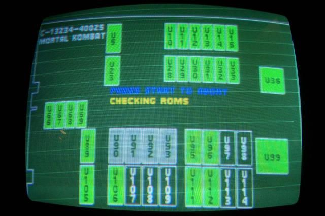

- Color were off & lines showing up in the monitor
- Lots of extra wires left in from a street fighter conversion
- Marquee is missing
- Some water damage/warp on the control panel, and extra holes drilled in it
- Only one of the coin door lights light up

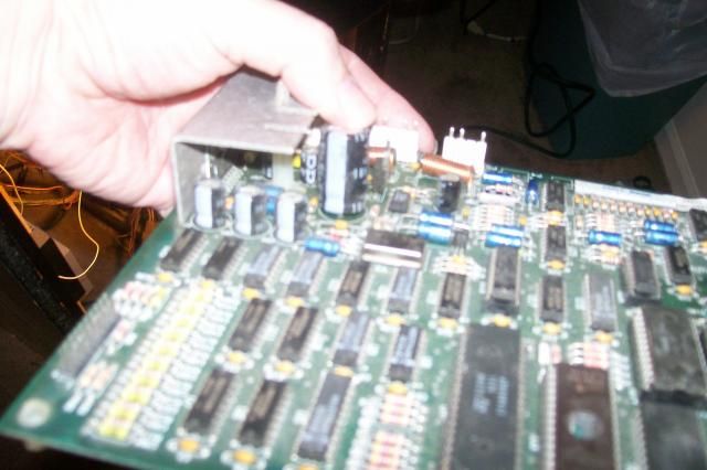

The sound board has a broken cap, a bad trace it looks like, and is missing the ribbon cable that connects it to the main board. A buddy of mine is gonna fix/replace the cap and take care of the trace issue.
I fiddled with the pot switches on the monitor adjustment board and got the colors looking better. Still looks like I'll need to manually adjust the RBG pots in the back of the monitor though, may be too much green or maybe not enough contrast. Will do that later on. The bezel looks like it's in good shape. I'm gonna clean it up with some WD-40 to bring out that old shine. And I'll need to cut some plexi to go infront of the monitor.
There is also a alot of spliced wires and extra uneccessary wires in the cab laying around that don't need to be there. So I'm probably just gonna replace all the jamma & kick harness wiring. Also looks like an extra audio cable was spliced for stereo sound. I dunno. That'll get taken care of as well.

Artwork on the left side of the cab is pretty faded, but not really messed up at all. The right side's colors are spectacular, but there are some good size gouges in the artwork. So both sides are gonna get replaced. Which I'm gonna need to get some info on how to apply artwork from ThisOldGame.com. Will I need to lay the cab on it's side to get new art on it? Or can I do it with the cab standing up?

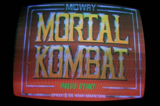

You can see the lines really well in this photo. The colors look better than that. The camera just kinda sucks. Not sure if that's the monitor, or something up with the main game PCB. What do you guys think?

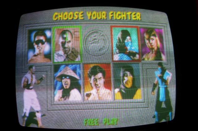

See how it looks like it's too gray? That'd be the brightness and contrast that needs adjusting right?
Broken cap on the sound board.

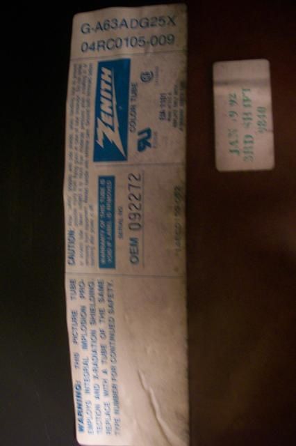

Info on the back of the monitor. Not sure if it's the original factory one or not, but it's in good shape.

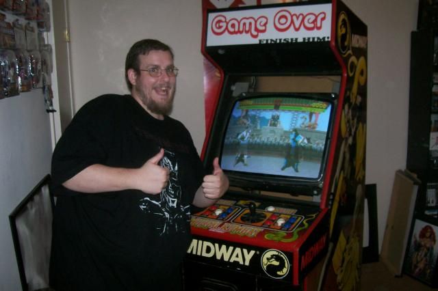

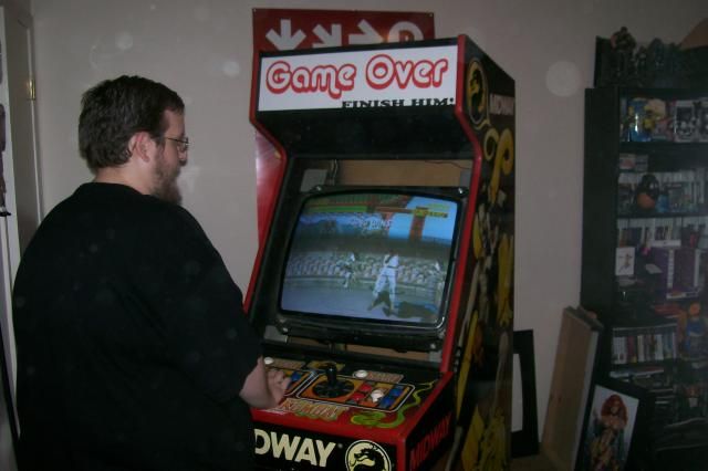

Me playing a couple round to test the controls.
Works like buttah!
And finally here's the main board. I think it's a T board. Revision 4.0. I'm gonna upgrade to 5.0 later on and snag a Turbo Ninja hack to keep things interesting.

turn down the gain on the monitor flyback, that should make the lines go away (there 2 knobs, the other one is focus)
As for the bulb, take the broken one to autozone and tell them you need a replacement bulb. If you need a security torx, I have a spare but its not a screw driver bit, its like an allen wrench.

Is that an actual screened marquee or just a piece of paper?
« Reply #32 on: May 02, 2014, 10:38:22 am »
I can pretty easily create that marquee for you in photoshop if you want to get it printed somewhere

Yeah, so could I, genius.  If it's not vintage then I don't want it.
Sadly it's a vinyl decal put on a piece of plexi.
@ Malenko - I'll fiddle with those knobs (that's what she said) later on to see if I can get rid of those lines. The flyback is on the back of the monitor I assume?
« Reply #36 on: May 02, 2014, 12:13:49 pm »
look for the red wire leaving the chassis, not the end with the anode cap, but the other end. the knobs are right near where the red wire starts.

Congrats on the pickup! To properly adjust the monitor...
-) Turn the "brightness" pot on the remote board ALL THE WAY DOWN
-) Turn the "screen" pot on the flyback up until you JUST BARELY see the raster lines (the lines you are currently seeing)
-) Turn the "screen" pot back down until the lines JUST go away from the screen
-) Turn the "brightness" pot back up to desired brightness
-) Adjust "contrast" as desired.
Your colors look pretty good to me from the pictures but it's probably different in person. Post some pictures after you adjust the brightness. Also, you'll not only need the ribbon cable for the sound board but also the power cable. Here is a video I made discussing the ins and outs of MK pcb. Let me know if it helps you out...
« Last Edit: May 02, 2014, 05:42:11 pm by MK3FAN »

Found the screen pot finally. It's where I thought it was, it just didn't look like it would turn.
But I did the adjustments and the monitor looks really damn good.
Lines are gone!
@ Malenko & MK3FAN - Thank you both for the info.
