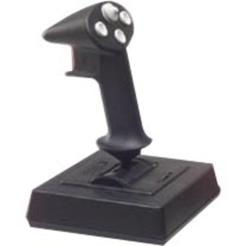

I use a cheap PC USB Flight joystick like the one below.
Then map the dial left and right to the buttons on the joystick.  Plays great and you can pack away easily when finished.
DOT needs a spinner but this joy works as good as the DOT joy.
Might look a bit tacky but this is BYOAC after all.   ;D
