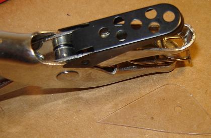

Speaking of PCB feet, is anyone using them to mount their mainboard? Are the screws the right size for that?
The screws should be the right size, but double check that you aren't shorting anything out.
Some boards have components/traces very close to the screw holes -- you may need to make an insulating washer by drilling a hole in a piece of plastic/cardboard then hole-punching it out. (pic shows after drilling but before punching)
Those seem really high in the air. This may be a dumb question but why do we need mount the ipac at all?  Why not screw it directly into the MDF?
The reason they are that high is to allow air to circulate and cool the board -- more important for a motherboard than the IPac.  ;D
You can screw it directly to the MDF, but by using the PCB mounts, you can remove/replace the IPac without worrying about wearing out the mount hole in the MDF.
As screw threads bite into MDF, the MDF breaks down into fibers -- each time you remove the screw and replace it, the screw hole is more likely to strip out.
