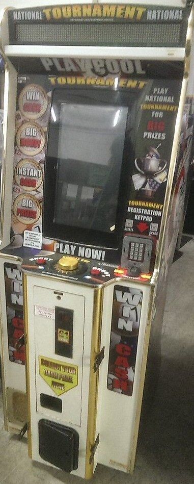

Thanks for replies, it is a 213C-1 and cab was a play pool cab that has keypad and print reader. All I found in cab was display unit and power brick so may need to buy lead if possible.

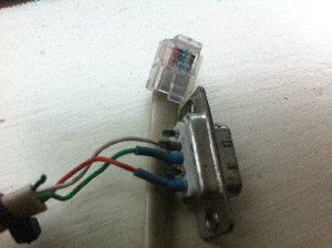

Well I found the lead for this in bottom of cab in the cash box lol, nice of em to leave it in for me.Only problem is one of 3 wires was off on the seriel end plug, although I did have it working with betamsg software the proper betabrite proggy wont see it, just keep getting "not connected to com1".
I need to check the pins so I can solder it back on properly but at least I know it is working so thanks for the help and info/links. :)

female end of db9
2=red
3=green
5=blue
the rest are internal jumpers
if u need the pin outs for them let me know
ed

female end of db9
2=red
3=green
5=blue
Big thanks, mine has :
2=white
3=green
5=red - this was off but looked like it had been on 5 and did work in the betamsg software BUT didn't work in betabrite proggy where it keeps giving com1 error.

« Reply #9 on: November 14, 2013, 06:46:02 pm »
interesting
if u want i can trace both end's..it is sitting beside me
now mine is out of a pga golf machine.?
i wonder if that ia the dif  :dunno
i will try the s/w and see
ed

ok i was reading there faq's
there is an .ini u can edit to change com's
also it look's like the 9pin dbm to rj45 is mgfg specefic..not betabrite
theres look's like straight throgh rs232
i will dig some more once my account is open to me
in the in term u could use a usb to rsr232 converter ?
i can try this for u if u want ?
ed

This came out of the play pool machine,will try add pic.
Link to cab pic
Here

ya i c where they differ now
mine has jumpers
1-4-6 all toghter
7-8
2 sep jumpers confiqed the way i just listed to u
i can see why now
look up rs232 protocol
dtr/dtc/and ring..etc
ed

the extra jumpers are to tie the ready to send lines so the computer knows it's okay to transmit.
normally this flow is done through software (a software xon xoff) but because this is a dumb one way connection you need to inform the computer it's okay to just send. (hardware flow control)
it can't hurt to add the additional wires if they wheren't included.
