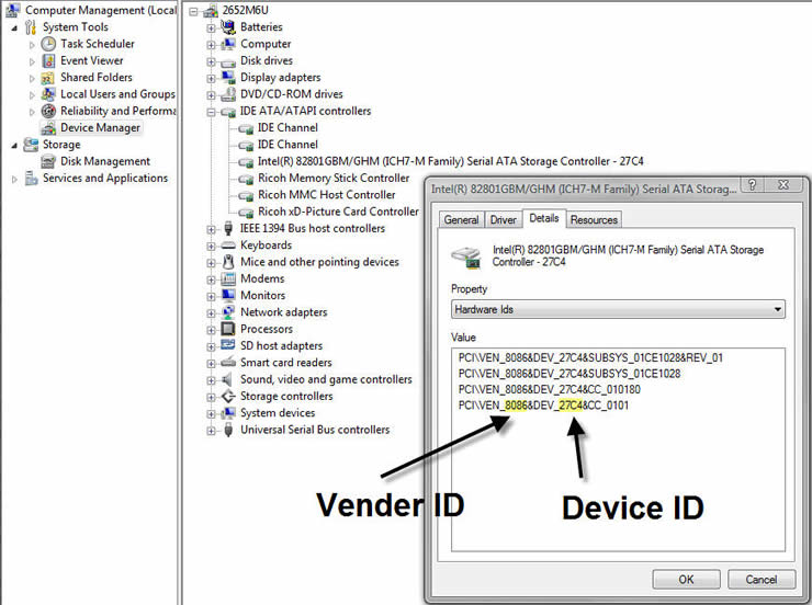

silly question but how do i find the device ID , thanks

This is for disk devices but it's the same for video cards:
Steps to create a log:

Ok found my device id , its not the same as in the other threads
PCI\VEN_1002&DEV_954F&SUBSYS_174B174B&REV_00
PCI\VEN_1002&DEV_954F&CC_030000
Thanks
