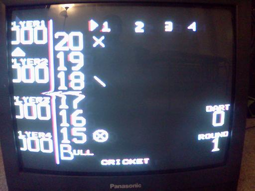

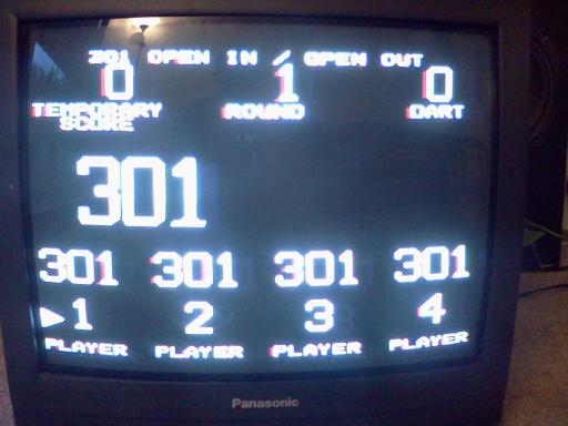

Voltages were close when I measured. I suppose if I am just a hair low logic will die. I know I have one segment that sticks but I have been pretty careful to make sure it isn't stuck when I test.
Sounds have been working when I get in game. And I am pretty sure there is a sound that plays when you add a credit.
Interesting note. I added two small fans to the supply that feeds the monitor fairly recently. I like to keep supplies cool. If you have the monitor plugged in the fan speed decreases (audible change) suggesting a drop in voltage.
External TV
http://www.ehoward.alyrica.net/images/super6/super6_301.jpg
http://www.ehoward.alyrica.net/images/super6/super6_cricket.jpg
Near the top of the 17 in cricket you can see a bit of scrambled video. This aberration is a horizontal line that scrolls upwards at a slower pace. I do not know what this is.
I will check voltages again when I have a chance.

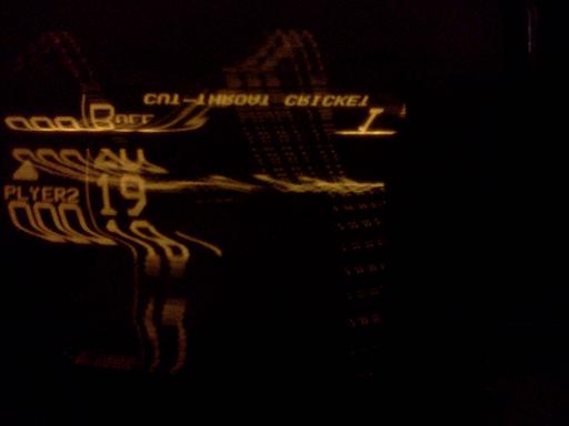

ethan1082
  • Posts: 9
  • Last login:February 26, 2015, 08:53:48 pm
    • ehoward.alyrica.net
Re: Arachnid English Mark Darts Super 6
« Reply #4 on: October 28, 2013, 09:34:51 pm »
I checked voltages again real quick.
5V ~ 4.89V
12V ~ 9.65V lower than I expected
21V ~ 23V
I was thinking the logic was good to 4.80V but maybe someone can confirm?
Monitor issue:
http://www.ehoward.alyrica.net/images/super6/super6_scrambled_vid.jpg
It looks like you stamped the image on a cylinder and started rolling it down the street. It continues to do this even when the system has frozen.
Any thoughts whether this could be caused by the low 12V? Can anyone measure theirs to verify?
So the freeze thing I am talking about. I power on the system, it starts to go through its demo / attract mode and then will suddenly stop cycling through the various screens. (The case above was cut-throat cricket or something.) It sits on one screen and if you try to add a credit, the system is unresponsive. The video is still clear on the external TV.
I can if I get lucky quickly add a credit after power up and may be able to select a game on the next screen. Very rarely I can actually play.

My monitors do the exact same thing unless I let them warm up for 20 minutes or so.  I did cap kits on both, I recall that the kits were missing non-polarized 1uFs and substituted a wonky value for a high frequency cap.  I saw no improvement in either monitor after the kit.
A scrolling vertical distortion on your TV is likely a sync issue and not a board problem.  I will defer to Paige's opinion on that one.

pbj, I know someone else who needs the boards if the original poster ends up not needing them. I gave a complete -boards machine to a guy who has been pretty good about doing favors for other guys.
Video problems normally originate on the monitor or with the wiring, not in the boards (in theory they can originate with the boards but in my experience they never do). I have probably 4 of those monitors sitting around right now.
