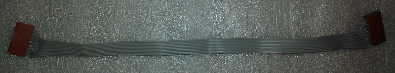

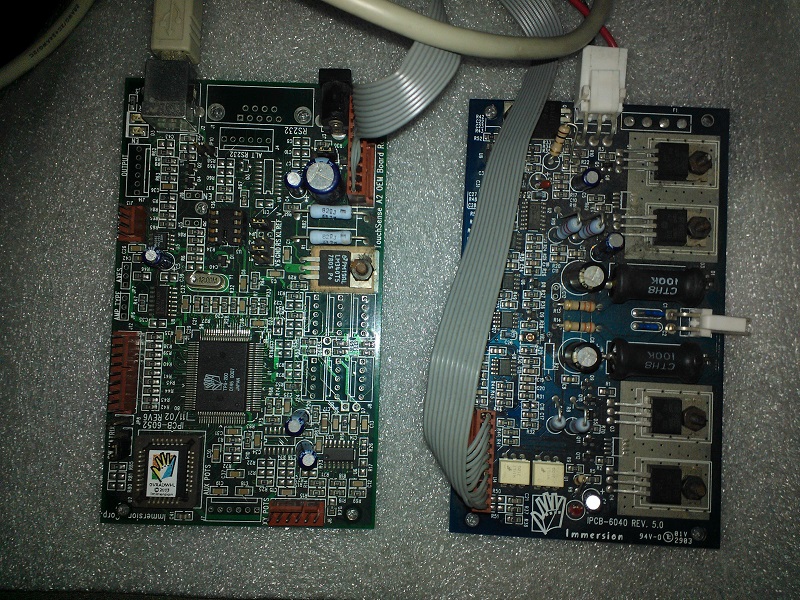

There seems to be many versions out there.  The new ones are a single PCB, while the ones Jolly West and I have found were two separate PCBs.  His has many more inputs than mine, but here is the pinout for mine:
I didn't bother trying to figure out what the connectors between the boards were.  If you happen to be missing the cable that connects them, I'd recommend ordering one from Global VR if they still have them.  If not, I'll try to explain how it's wired.

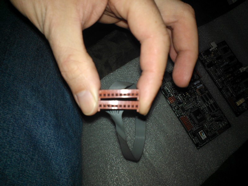

(I'm sure there is a better way to explain this and I'll probably revise it later, but it's late and I want to post the info while it's fresh in my memory)
The connector on the left side has the tabs facing up, the one on the right has them facing down:
When the connectors are held like this, the leftmost pins on each are connected:

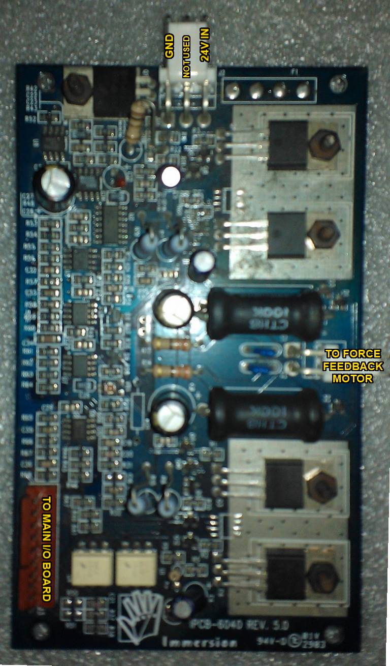

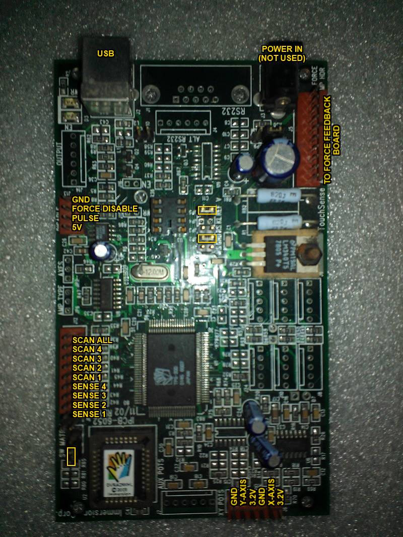

The pins for the button and potentiometer connections are standard .1"
I did not have the original connectors, so I used some pre-crimped jumper cables from pololu for testing.
The main board is powered through the 24v input on the second board.  I assume the power input jack on the main board is used for testing or when the application doesn't have ffb.  I do not know the proper voltage for that input.
The buttons are matrixed and require diodes after them if you want all of them to work. (see manual)
If you go to the trouble, you'll have 12 buttons and the four directions on the hat switch.
If you only need 4 buttons, think of SCAN 1 as the ground and SENSE 1-4 as the buttons.
That will show up as buttons 1-4 on the game controller.
SCAN1 + SENSE1 = BUTTON 1
SCAN1 + SENSE2 = BUTTON 2
SCAN1 + SENSE3 = BUTTON 3
SCAN1 + SENSE4 = BUTTON 4
SCAN2 + SENSE1 = BUTTON 5
SCAN2 + SENSE2 = BUTTON 6
SCAN2 + SENSE3 = BUTTON 7
SCAN2 + SENSE4 = BUTTON 8
SCAN3 + SENSE1 = BUTTON 9
SCAN3 + SENSE2 = BUTTON 10
SCAN3 + SENSE3 = BUTTON 11
SCAN3 + SENSE4 = BUTTON 12
SCAN4 + SENSE1 = POV HAT UP
SCAN4 + SENSE2 = POV HAT RIGHT
SCAN4 + SENSE3 = POV HAT DOWN
SCAN4 + SENSE4 = POV HAT LEFT
Connecting SCAN ALL to any of the SENSE pins will activate all four buttons associated with that SENSE pin.
I did not do any testing with the "Force Disable" header.
The Force feedback tests in windows controller settings worked fine without having anything on that header connected.

Thanks for the detailed info BadMouth.  Most useful in understanding how the switch matrix works.
I have a Need For Speed Underground cabinet with the twin PCB setup like you had.  I tried soldering on connectors to the Z-axis on the PCB and hooked it up to the Throttle but no input was sent through this channel so probably not supported.  I found a guy in the US selling brand new single PCB replacement boards (part no. COEM-GCE-H2P5A-HF) on ebay.  I got one delivered for A$50.  I swapped it for the twin PCBs and it worked perfectly straight away.  No connector changes and has the same footprint as the old board.  It now sends through the X, Y & Z-axes and probably W-axis too (if I ever want to configure a clutch).
I've just got to figure out how to make the 6-speed shifter work now but it seems it will be hard to make it work for all games.

My 2 piece board above has 4 transistors for the force feedback.  These have 2 and 2 empty spots.
I have to wonder if the older boards handled more current than these.

Just wanted to say that the red&black wires coming directly off the PCB (you can see it in the photos) is for disabling the force feedback.  Just leave it disconnected if you want FFB all the time.
As for the power it seems to drive my HAPP motor well.  I haven't run it continuously for very long but at 100% it gave me sore arms and certainly wouldn't want to drive one-handed.
