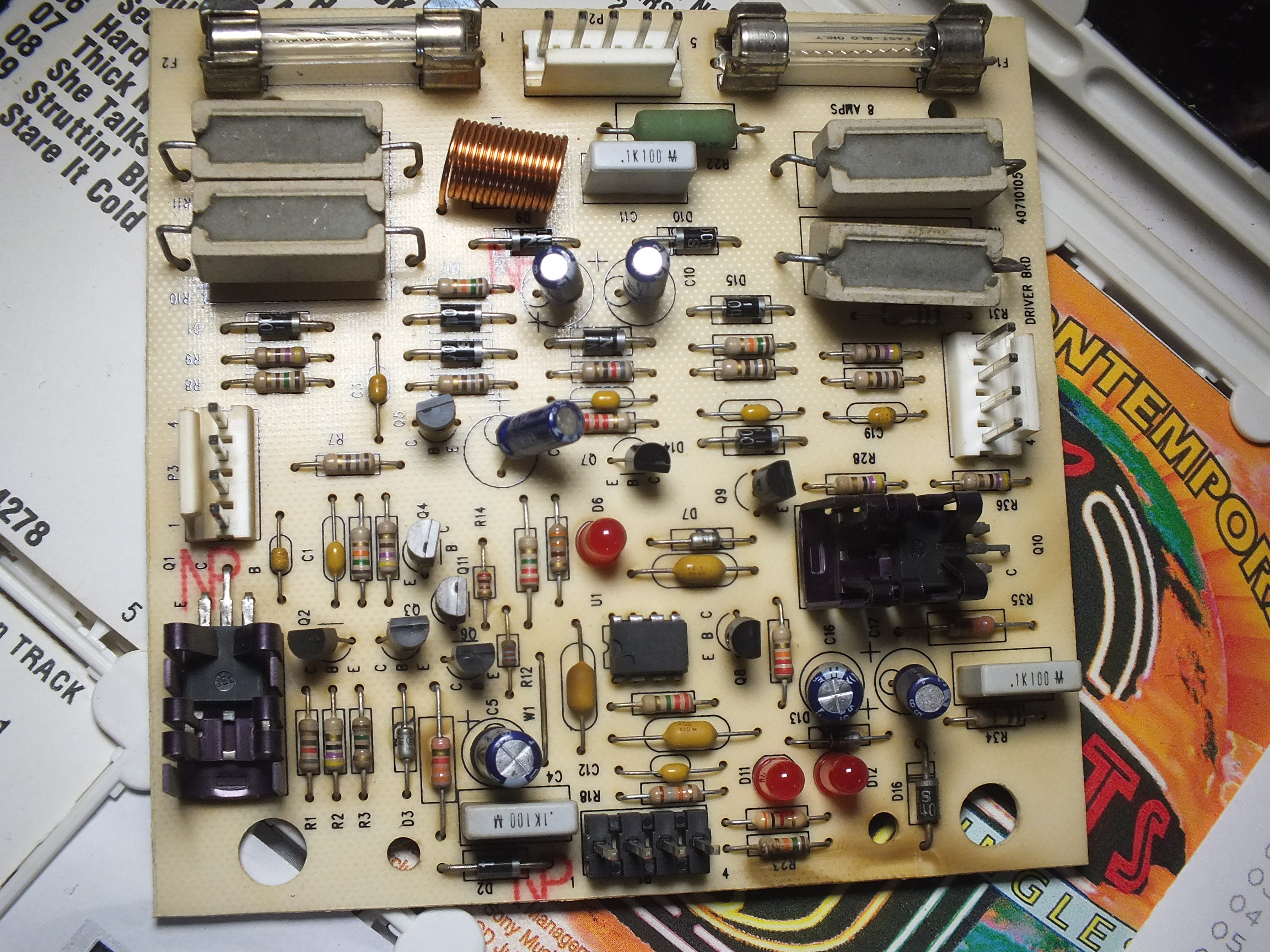

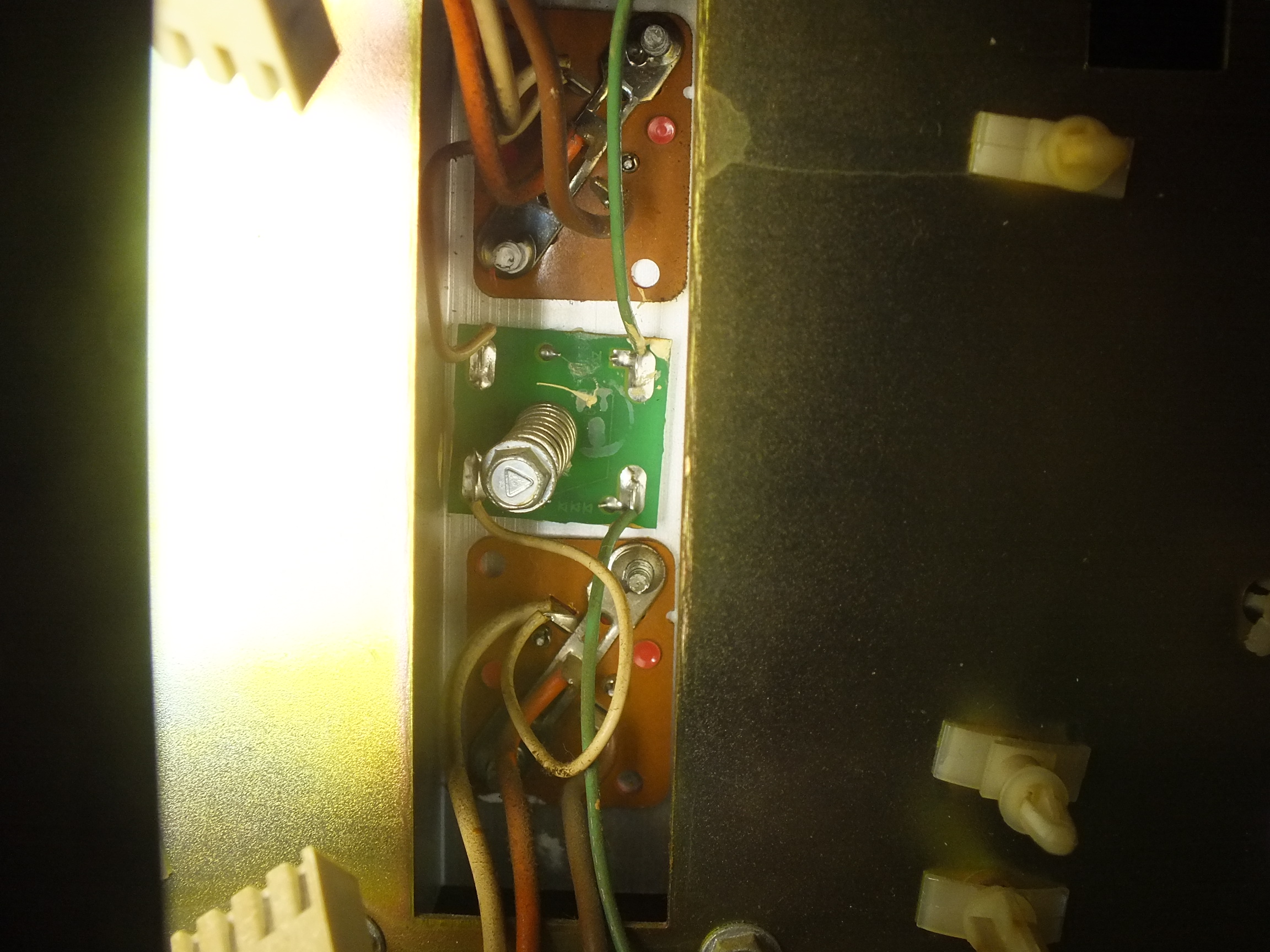

I have a rowe 61024903 amp for a Rowe Saturn Jukebo, and one side got all kinds of static and low volume along with blown fuses. I replaced the transistors with ST transistors, and replaced all the fuses. Hooked it back up, it made this weird astroids arcade game sound, blew 2 fuses on one side and both sides sound like garbage now. Anyone have ideas? ???

all rowe jukes used matched output pairs
if u replaced them with off the self replacements ? and did not re-bias the amp
guess what is gonna happen ??
also if it sounds like static..cap kit is in order
start from scartch..replace all transistor's,make sure the finals are a matched pair
re-cap,re-bias..carry on
a owners manual is handy right about now
as u need to :match: the rowe outputs to there :exact: spec
ed

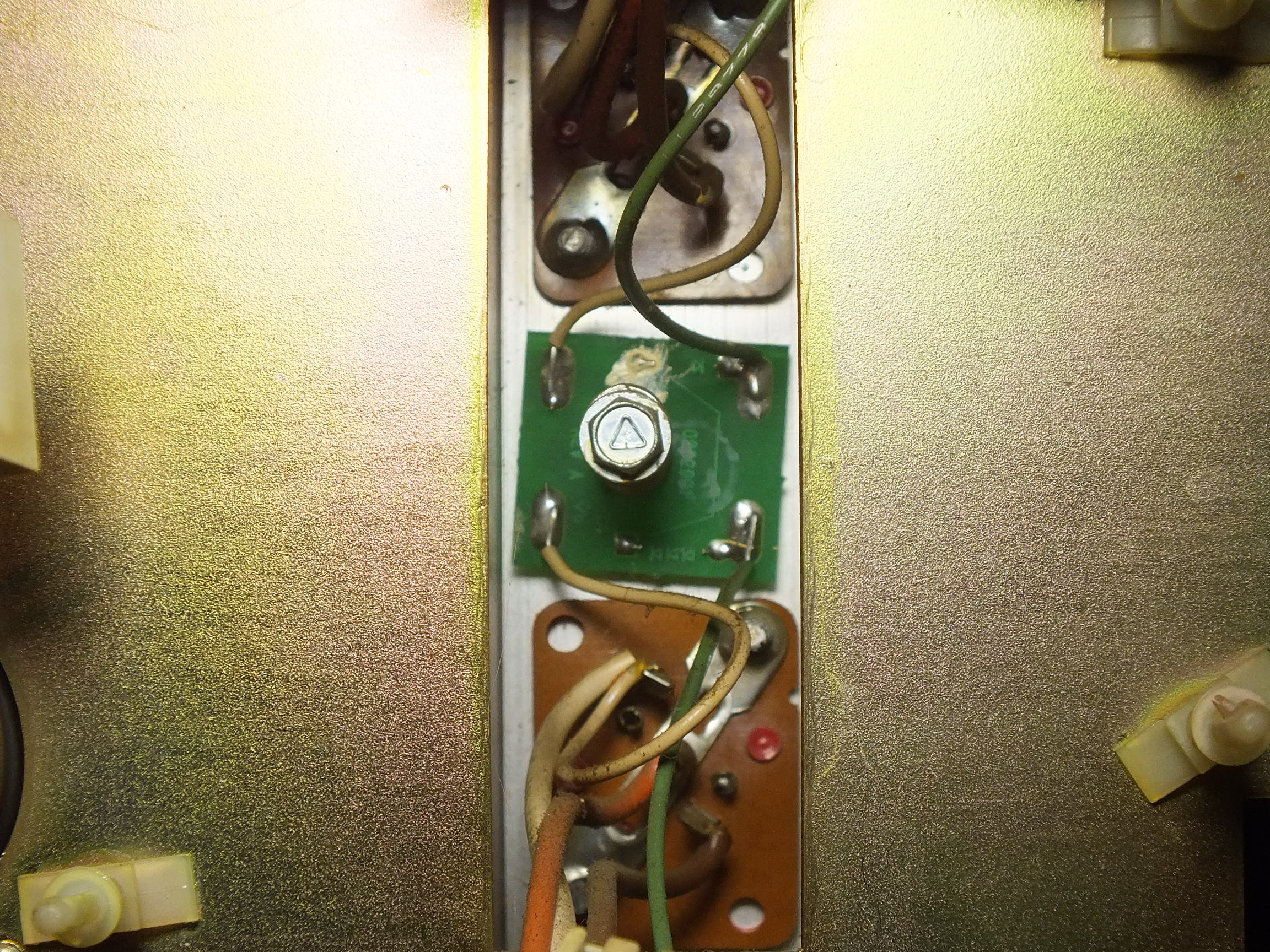

lilshawn
  • Posts: 7515
  • Last login:January 23, 2026, 01:40:05 pm
Re: Rowe Saturn Jukebox Amplifier problems
« Reply #7 on: October 22, 2013, 07:58:06 pm »
you basically need to have a pair of transistors that are matched very close. if one is different than the other it can cause a cascade effect that makes the transistors run away as they flip flop out of control till they blow up.
also, check the little circuit board on the underside of the heatsink with 2 diodes and 2 wires. they use it perform a temperature compensation. if there is a bad or broken solder joint on there it can cause the transistors to pop. about 90% of the boards i've checked have insufficient solder to hold the leads properly. the vibrations from the subs can cause it to break.

ed12
  • Posts: 3972
« Reply #15 on: October 23, 2013, 12:03:43 am »
ami-man
my typo
>ami-guy<
ok so it is npn finals ? so both channels use npn ?
as outputs ?
please post me a picture of the final >output stage of the amp
so i can see it
ed

well my last post never made it up hmm

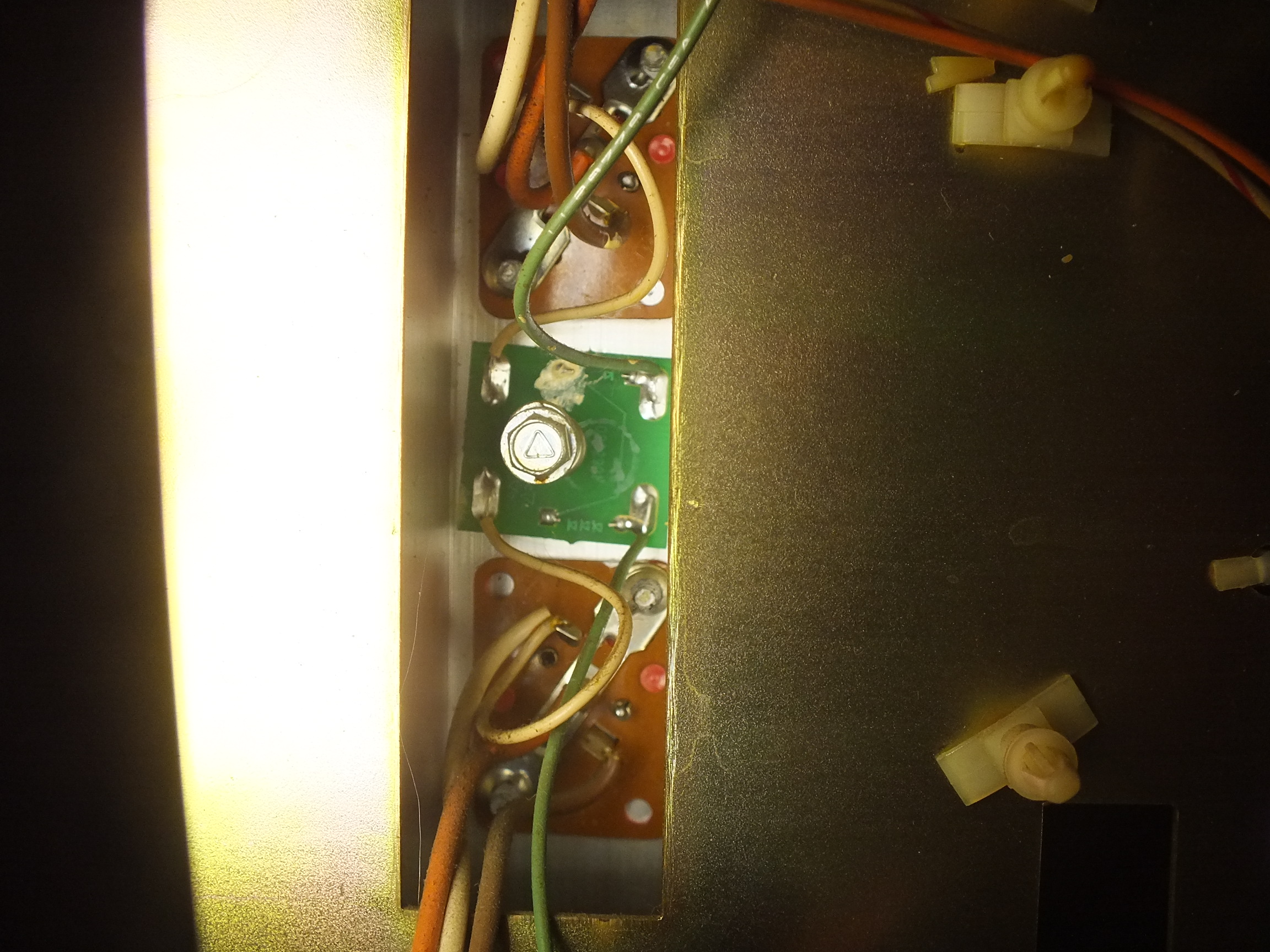

in your last pic..u can clearley see the word >mp< foward on 1 and reverse on the other..
as a rule they are sold as :pair's: for that exact reason..
now on the other parts..thats what we are here for to help u fix it cheaper then sending it in,so it may need a few diodes and caps,resiters..have at it
10% cheaper then sending it..and 100% better knowing u did it yourself
heres the trick..go slow and steady..listen up :alot: and carry on
rem u are the person doing the work. we are olny guiding u and are your personal sounding board until u have fixed..then its high 5's and we all go back to our corners

new insulators too. those metal cans CAN'T touch the metal AT ALL.

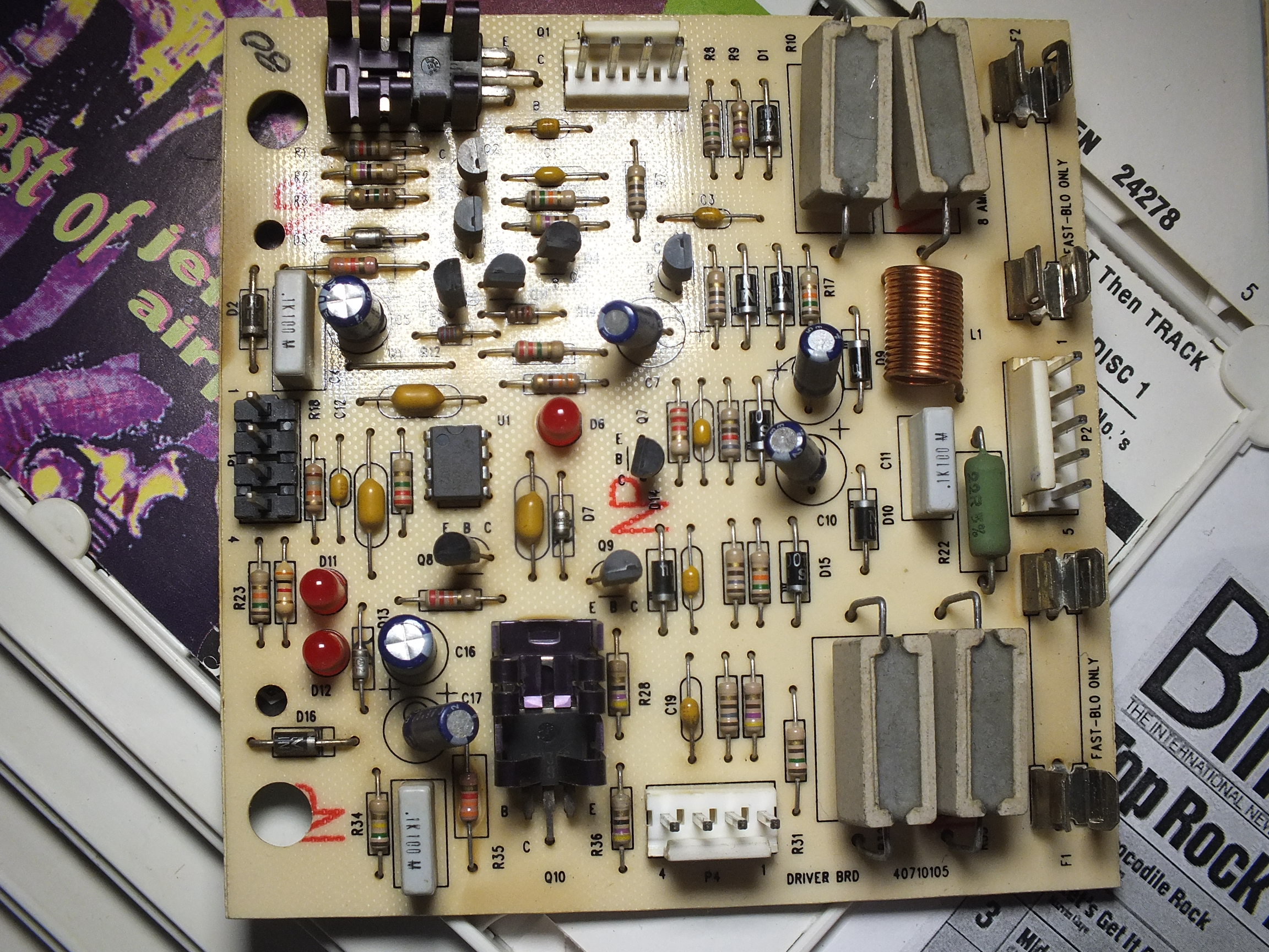

youll have to check the driver board too. they are the 4x4 inch boards on the back. sometimes some resistors burn out on there and some traces burn up. check them out and see if they look okay.

you don't need rings or anything on the screws. it's okay if they touch the metal can. they screw into the phenolic holder base that the transistor clips into so they remain insulated. you just have to make sure you don't have the shaft of the screw touching the side of the hole in the heat sink.
the phenolic base has some ridges around the screw holes that are supposed to keep the base aligned with the screw in the middle of the hole so there is no chance of it touching, but it's easy to think they are seated properly when in fact it's not since it's view is obscured.
this holder also makes it so you don';t have to solder the transistors at all, you just unscrew them and pry them out. be aware though the base isn't attached to anything and you may have to disassemble the boards from the backside to reach in there and hold the base while you attach the new transistor.
protip: when you are finished installing the transistor test for a short with a meter between the can and the heatsink. if it's in the 100's or 1000's of ohms it's okay, if it's zero, something is touching somewhere and the can is grounded. You will need to fix it before you power it up or kablamo!

I understand that around the "F" model, Rowe changed the driver boards in the amplifier to "self-adjusting bias". There were no adjustment trimpots on those driver boards because they adjusted themselves.
In my experience over the years, any time the output transistors blew out again after being replaced, it was usually because there were additional bad components on one or both the driver boards. I have no experience with the new self adjusting driver boards, only the older driver boards with the trimpots on them.
Definitely all four of the output transistors must be electrically insulated from the chassis/heat sink so be sure all the insulating mica sheets are there and smeared with a film of silicone heat sink grease.

for the old style driver boards, you have to check R21 R24 R33 and Q4. especially if the board looks like it got hot. R21 and R24 should be 180 ohms R33 should be 470 ohms. if r24 is toasty q4 is almost assuredly shorted.
i'll take the manual home with me today and scan the amp section into a PDF and post it here tonight when i have a few minutes.

when shawn up-loads a scan ? i can explain why they have to be matched pairs and give u cleariatiy
u will be looking at the driver boards
as something is not right
it is a starnted push pull amp 1-npn 1-pnp per channel
4 self biasing per side >heat sink mounted>
the transistors are high gain darlingtons >best to have some sort of a load on them at all times,we normaly use a 100-125 watt light for this
u have 2 leds that will tell u if the amp is overload condition
u have 2 fuses pre driver board to deal with
u have 4 high power resisters per driver board
to deal with..again thk-u shawn for the heat issuie
we will need to adress these

You know, it also would not surprise me if the screws touch the heat sink. There is some play when putting them in. I may be wrong

Ami Man, Thank you. I am still looking but don't see much. This is what I have. If anyone sees anything, please let me know. All solder joints look good.
http://www3.picturepush.com/photo/a/13798956/img/13798956.jpg[/img]
« Last Edit: October 25, 2013, 03:10:13 pm by amandandme197 »
ed12
  • Posts: 3972
« Reply #70 on: October 25, 2013, 03:14:56 pm »
correct me here
but that looks like a self biasing  unit to me
refer to the pc in the middle of the heat sink
the resistors we are talking about are the 1's that look like big bricks
they look good
the boards look fine..no damage i can see
what we do now is some tests with that meter of yours..
also u may have either shorted out the outpus placing in the new 1's
and or forgot to do a few steps.? refer back to replys here
or your speakers are shorted and or the out put tramsormer..?
this is what the light test is for in its cleartly..so we can see load without the outputs
in...
ed

« Reply #72 on: October 25, 2013, 04:48:24 pm »
yes those are the auto bias boards. 40710105.
no adjusting for you!  :cheers:
the manual bias adjust driver boards are 40710104
you may still run into the issue where they "sound" blown like i did with those boards.
we will cross that bridge if it comes to it.

 :cheers:Hey ed, my driver boards do not have any cr diodes. I have the other style driver boards 40710105 so would I do the d1, d2, etc?
« Last Edit: November 03, 2013, 02:29:44 pm by amandandme197 »
ed12
  • Posts: 3972
« Reply #147 on: November 03, 2013, 02:46:32 pm »
ya same syntex  cr1=d1 etc
its like where u see a resister makred .1kohm..u go wtf
that is 100 ohms
cr stands for current recifiter d stands for diode
both mean the same thing
expect for zeners which will as a rule have a :board mask: with a symbol
that looks like >z< which donates zener
others will have a board mask with >|< which means normal diode recifter
and donates chathode and anode :polairty:
ed

now with everything back in expect the output transistors
go ahead and place your 2 lights into the fuse holders >just tack them there<
u should find +40 volts dc on both sides of 1 light
and - 40volts dc on both sides of the other
if so...2 of your leds should be off >overload<,if so we order transistors and fuses
mica's and grease
this applys to 1 driver channel olny..as u olny have 2 lights
but just remove them out
and place them in the other driver board
and repeat step 1 and 2
and as a saftey measure here
give the main caps about 30 mins to drain down there charge..reason is there is no real load for them to work into
 the driver board will pull it off abit slow but it will do it
ed
