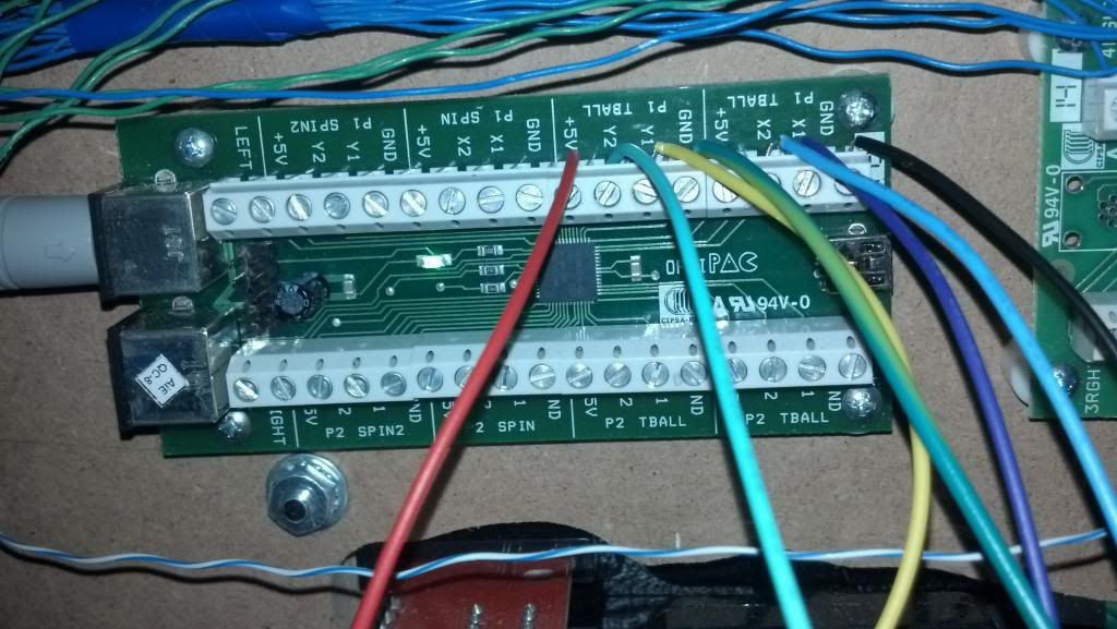

here is my setting atm:
and
2 questions:
Is the wiring wrong?
Is the settings wrong in the Optipac Software Utility?
« Last Edit: August 24, 2013, 02:01:46 pm by Yourname942 »
  • Posts: 9716
  • Last login:Today at 12:45:26 pm
Re: Question Regarding Getting trackball to work
« Reply #9 on: August 24, 2013, 02:27:00 pm »
Looks like you have either frame ground (bleeds off static electricity charges) or the green Y-axis data line attached to the ground for Y-axis.
Try disconnecting all the Y-axis wires and moving the red 5v over to P1 Tball X-axis 5v. (4 spots to the right of current location)
Once you get X-axis working, add the data lines for Y-axis.
Once you have X- and Y-axis working, attach frame ground to dissipate static.

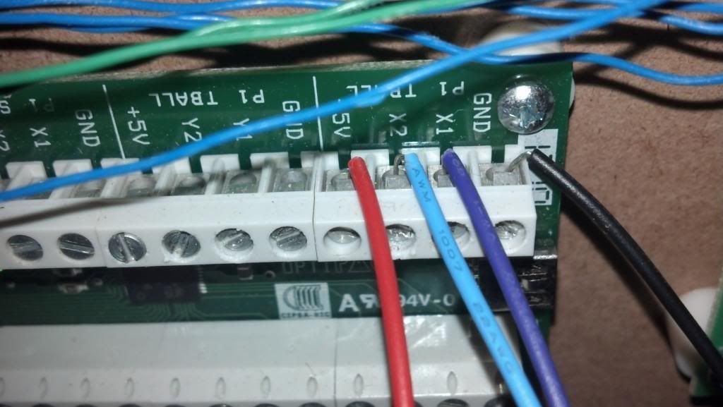

here are a few more pictures for a clearer image of my current wiring:
here are the wires from the NorthEast side of the trackball:
and here is the thicker ground wire I think:
Is this correct?
« Last Edit: August 24, 2013, 03:40:01 pm by Yourname942 »
  • Posts: 9716
« Reply #12 on: August 24, 2013, 02:49:24 pm »
1. Move the red wire 4 places to the right.
2. Disconnect the yellow and two green wires.
3. Boot system up to see if the X-axis is working.
4. If x-axis isn't working, change the P1 Trackball setting in the software.
Once you get X-axis working, we'll work on Y-axis.

I moved the red to the x axis +5 and took out the greens + yellow, opened the optipac software utility but it still doesn't do anything.
Edit:
and
here are the wires from the SouthWest side of the trackball:
« Last Edit: August 24, 2013, 03:43:06 pm by Yourname942 »

The wires look correct. (We'll take care of the rest once the system recognizes the Opti-Pac and X-axis is working.)

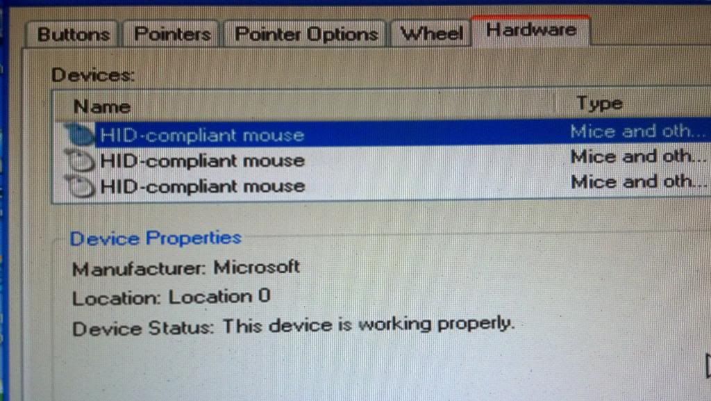

Does the system recognize the Opti-Pac as a mouse? (Check under "Control Panel")

yes it shows up as 3 mice in the control panel:

Good news on the system recognizing the Opti-Pac. :woot

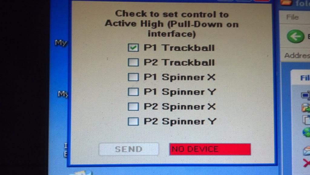

Try deselecting "Active High" and see if your windows cursor moves when you move the t-ball on the X-axis.  (most trackballs are "active low" devices)
Yourname942
  • Posts: 123
  • Last login:October 01, 2016, 08:10:20 pm
« Reply #21 on: August 24, 2013, 04:45:40 pm »
I deselected the P1 Trackball checkmark, but it still doesn't move  :-\
Is the optipac software utility supposed to show Send as greyed out and "no device" in red?
« Last Edit: August 24, 2013, 04:50:20 pm by Yourname942 »

If the Send option is grayed out and the software doesn't recognize the board, it couldn't command the Opti-Pac to switch between Active Low and Active High.
Sounds like you may need to e-mail Andy on this one.
