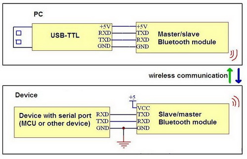

Gudday all,
Been reading this forum for a few years and enjoyed it but only recently registered. Best info I have ever found has been on this site so thank you.
What I want to do is see if I can make a cordless AimTrak as I really haven't found anything as accurate as the AimTrak and not found a cordless version.
The bluetooth module below after much looking around appears to be correct for the purpose.
Easy-use Serial Bluetooth Module Kits V2.0(Master + slave + USB)
http://www.elechouse.com/elechouse/index.php?main_page=product_info&cPath=90_91&products_id=641
http://www.ultimarc.com/aimtrak_module.html
Running a LiPo battery from say an Airsoft gun should do the trick and I could probably even run a 14V with a 5V regulator for the AimTrak and the Bluetooth with the possibility of maybe (very maybe) even running a smaller 14V ultimarc recoil unit from the same battery.
My questions:
1. has anyone tested the theory above using a master slave bluetooth?
2. what is the current draw of the aimtrak module?
I would be very interested to find out. :)

I think overall this will be pretty simple to setup electrically but I've never seen a Bluetooth module like this one before. All my research says yeah it should work but no one has done anything like it before and being an Aussie I don't have ready access to parts like this. :( For $50US it seems to be worth a shot. Then if it works spend the rest of the money needed to get good LiPo batteries to fit and modify the internals of the Aimtrak gun to take it.
So does anyone know the current draw on an Aimtrak module? A 2C LiPo is enough to power the circuit with ease but I'm wondering about voltage reg for the Aimtrak. The draw on the Bluetooth module is low.

« Reply #5 on: August 05, 2013, 11:11:44 am »
A 2S Lipo should do the trick, just wire up something like an LM7805 5v voltage regulator to step it down from 8.4-7.6v. Might also want a low voltage alarm so you don't kill the pack by accident.

« Reply #6 on: August 11, 2013, 11:31:49 am »
Good point was not even thinking of a voltage alarm. Should be pretty simple to add it in. Thanks.
