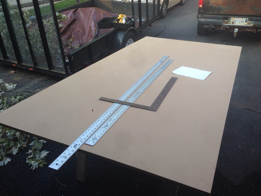

We decided on 3/4 MDF. In hindsight we probably would've been happier with lighter MDO but you know hindsight. We picked up 3, 4x8 sheets and began the measuring.

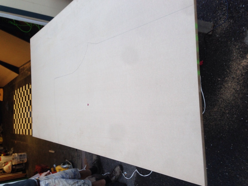

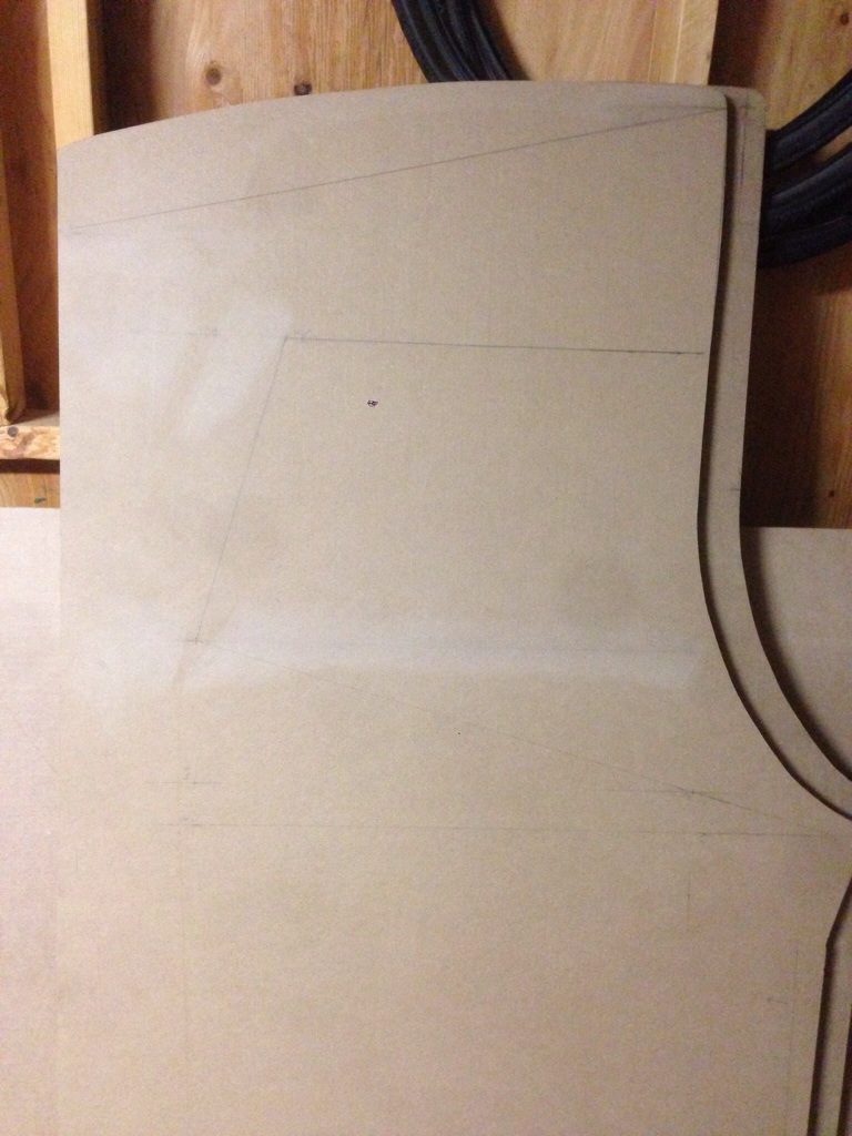

Maybe it seems silly to include a picture of my scribbles on wood but I promise you I spent over two hours laying it out before I was ready to pull out a saw. It was so much fun for my dad while I was relearning everything I forgot in high school geometry.
After much head scratching we ended up with this and it looks pretty good.

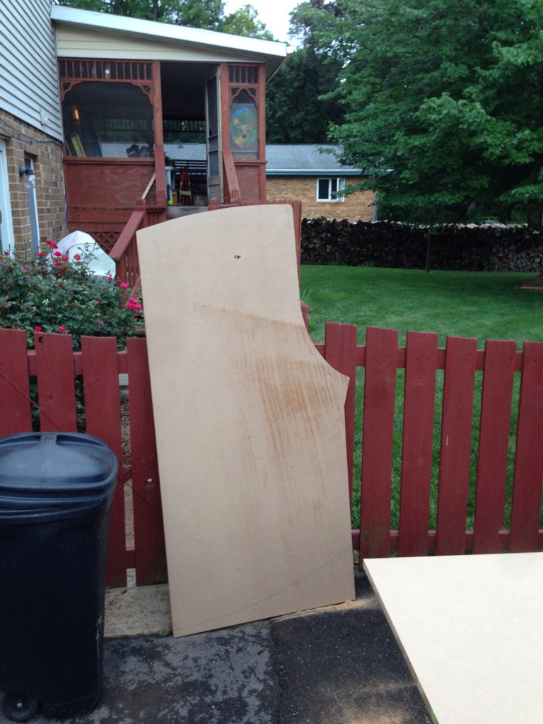

We ended up with this. A fair amount of grunting and nodding happened at this point and maybe a chest bump but I don't remember.
Of course the second one is always easier than the first. We just traced it and cut it the same.
We used some sandpaper to try and smooth out the rough spots. Couldn't really get much sanded by hand though. May have to come back later with some more power.

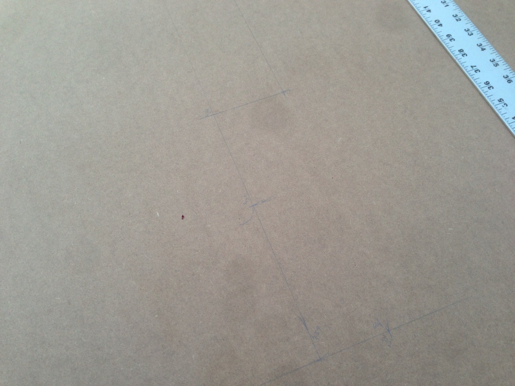

Again with the measuring. I enjoyed the challenge of laying out these measurements but I tell you what, maybe I should've picked something without curves and mysterious innards for my first arcade cabinet build.

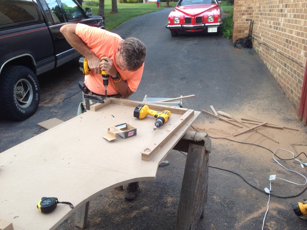

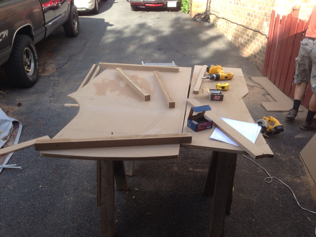

We made up the furring strips for the inside panels out of leftover MDF glued together to make 1 1/2 inch square strips.
Never really occurred that this wouldn't be strong enough. After its glued and screwed I don't think it's going anywhere.

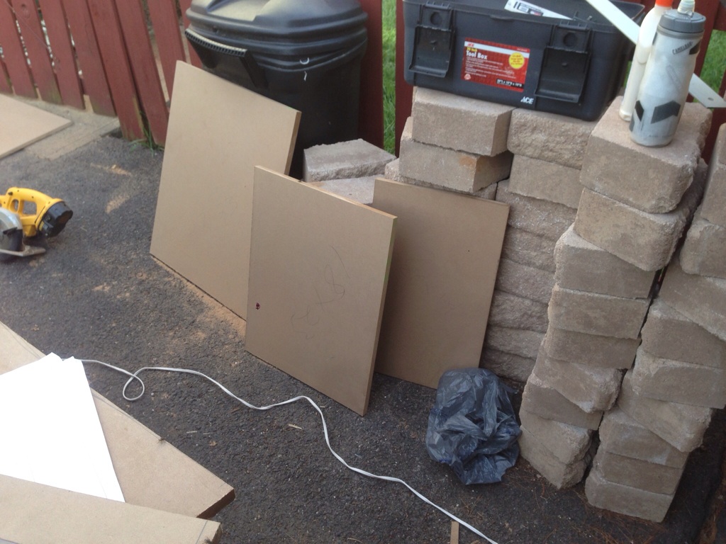

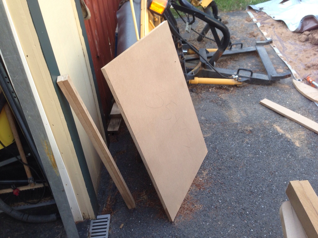

Here are the panels we cut. We just rough cut these at first and planned to finish cut them later.
These panels will probably have some screw holes in them to deal with later but we tried to keep the main sides panels clear of any holes.

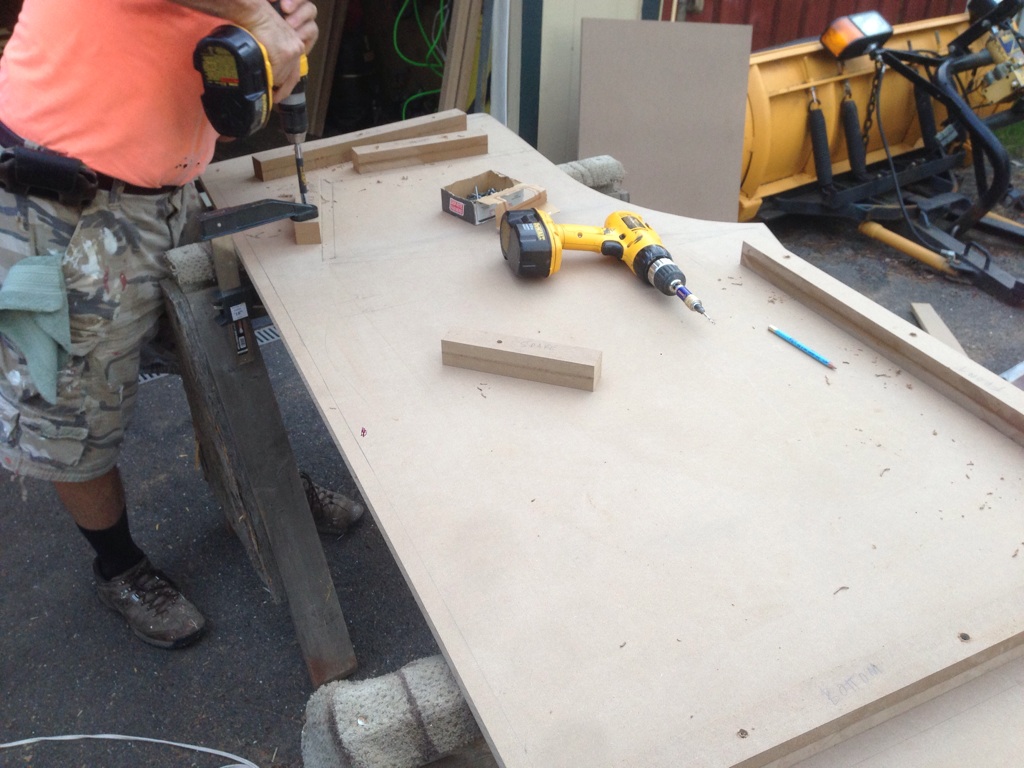

We fastened the furring strips with 1 3/4 screws and no glue. We countersunk the holes which left the screws about 1/4 inch from poking through the main outer panels. I know what you’re thinking, no glue? I lived in fear that in our inexperience we would measure wrong and permanently attach a strip or panel an inch off or something. The plan is to come back later and glue them up when we’re sure it won’t end up on CrapMame.

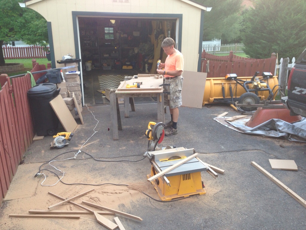

I love this picture because it looks like a DeWalt monster threw up all over the place. My dad is a DeWalt fan if you can’t notice. Quite impressive really. It took TWO 18 volt cordless drills to fasten this cabinet together and, I’m not kidding, there is a third DeWalt cordless drill in there waiting to go in the game. The only thing not impressive about this picture is that white, living-room-lamp, extension cord plugged into another white, living room-lamp, extension cord. I guess when you’ve spent years winding up 50 feet of 10 gauge extension cord you’ll take the easy route.

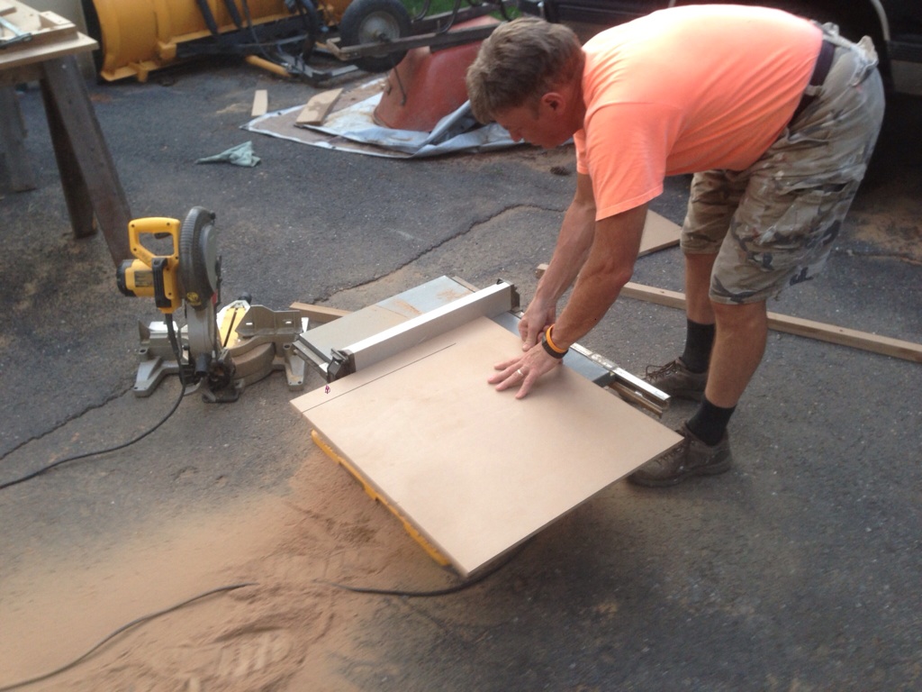

Here’s some final cutting on a panel

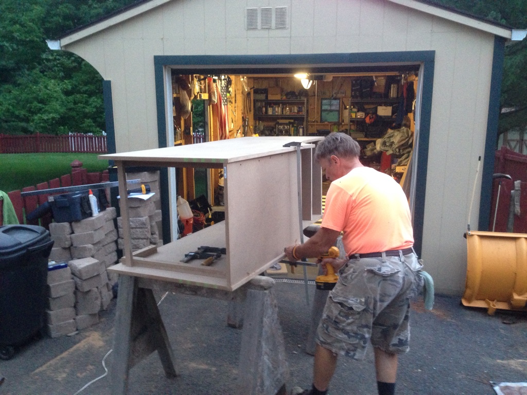

Finally this thing is starting to look like an arcade cabinet. At this point we started getting a bit more excited.

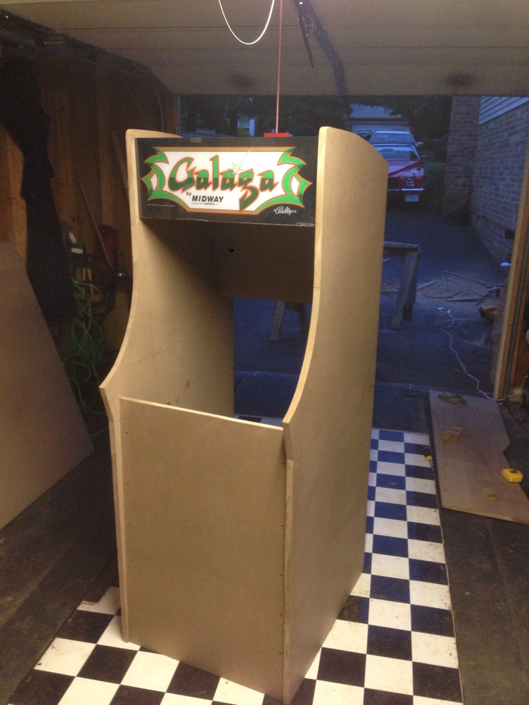

The fully assembled cabinet without a back or bottom but hey it was getting dark.
In this one you can see that 3rd drill and the DeWalt compressor
Had to stick that marquee up there
The plan is to pull it apart and glue the strips and panels and re-screw everything. We might do some fine tuning of the shape while its apart again. More to come. Thanks for looking!

Easy fix, just put the kick plate rubber low enough to cover the gap :)
For the sides, why not just clamp them together and use a flush trim bit on a router to make them the same? I know too late now. Either way, the sides look fine in the picture and as long as the cab doesnt wobble, you're golden.
Confirmation! I had this thought too
Yeah, this really was the plan until I realized the newly trimmed side was still a bit larger than the un-trimmed side. If this hadn't taken the wind out of my sails I would have trimmed the smaller side and then re-trimmed the larger by clamping them together. It turns out that they aren't that much different so we dodged a bullet. Next time though...

Now that we had the ball rolling again we made a goal to have this machine finished and inside the house for Thanksgiving Day. Nothing like holidays to get us going.
We started by making the missing front panel, the modded rear-monitor panel and the entire back of the cab. We measured and cut them from the 3rd and last piece of 4X8 MDF.
More cutting but you can see that the rear-monitor panel (as I call it) is now installed. It took some extra brain power to measure and place this one since the angle is different than it would be for a 19". We relied totally on Jakobud's plans initially but had to improvise after we got a 24" monitor.

There is actually a complete lack of anything on the back at this point. We had to cut 3 rear pieces: top, bottom and a removable door.

The new front panel gets drilled, glued, clamped then screwed in place.

And finally all of the wooden panels are installed
Always gotta get that marquee in there when I can
It was very encouraging to see the progress we made up to this point. Thanks for reading!
