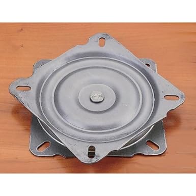

The other thing i thought about doing, was instead of using a mounting bracket, just mount the TV to a piece of wood, which would be mounted to a bar stool swivel, like this:
http://www.amazon.com/Trendler-Metal-Products-Swivel-Thick/dp/B0037M8GAO/ref=sr_1_2?s=hi&ie=UTF8&qid=1370017098&sr=1-2&keywords=bar+stool+swivel#productDetails
these things are rated for hundreds of pounds, but that is in a horizontal orientation where it would be compressed...i'm worried that it may not hold up to being mounted vertically.  Opinions?

My 50" plasma is maybe 50 pounds. I bet that spinner would be fine.  Although.....if you're not going to be that far away, I don't see a need to bother turning the monitor.

I originally had a 32" TV on a rotating mount, but quickly traded it for a 47" and gave up on rotating. There just wasn't a need anymore. With a 47", the vertical height is 23.5", which is larger than the height of a 25" vertically mounted arcade monitor. This is the mount I used on the smaller TV. IT worked fine. My 47" is actually lighter than the 32, so it might have worked for it as well. I don't think it would have been as stable moving it around though. You can see from the pic that the TV was a little small to hide the mount when rotated. I would suggest going with a larger TV so you have room for the bezel artwork. I think it makes a huge difference. The 47" TV is in the second pic.
http://www.amazon.com/gp/product/B000GGWFUQ/ref=wms_ohs_product?ie=UTF8&psc=1
