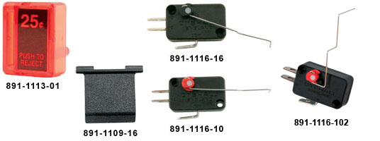

Hi all,
I've got a TMNT cab with four coin slots. As you can see from this pic, one of the slots has the cover missing. These red slots have a front part that snaps onto the main unit. Anyone know where to buy a matching  one and also the small artwork for it. Thanks!

It's a coin reject button.  Someone else may be able to tell you what type you have and what type you will need to get.  There are a few different makers and the button themselves may not be interchangeable (or maybe they are).
You can get replacement parts through Happ Control via Divemaster127 or even print out your own labels.

Pg 11 of the TMNT manual says that the coin reject button P/N is 91-1113-01.
Closest thing I found on the Happ site was 891-1113-01.
Not sure if it is the same part.   :dunno
Divemaster127 probably has them.

Wow, not only the perfect answer but an awesome link, thanks! Looks like that is it and contains both parts (nice image here: http://www.amusementdistributors.com/index.php?main_page=product_info&cPath=2_151_154&products_id=437). Divemaster is this site right? http://www.arcadeemulator.net/cgi-bin/shop/cp-app.cgi?usr=51F4178356&rnd=8385324&rrc=N&affl=&cip=&act=&aff=&pg=prod&ref=Reject+Button+Assembly&cat=Coin+Doors&catstr=HOME:Coin+Doors?
The ones he has look different so I'll check to see if he can get the one I need. Thanks again!

That green one you linked isn't the right part -- it's a 42-0517-03.
ArcadeEmulator.net is indeed Divemaster's site.
He carries a lot of other Happ and Ultimarc parts that aren't listed.
Drop him a PM with the link and P/N from my earlier post and he'll be able to tell you if he has it on hand or if he can order it for you.

Just keep in mind when ordering coin reject buttons.
  There are mostly two types:
 One is happ and the other is coin controls.
 The one you have is coin controls.
Happ sells parts for both
But definitely try to go through divemaster instead  it'll be cheaper
Re: Anyone know what this part is and where to find?
« Reply #6 on: March 25, 2013, 05:02:43 pm »
+1
Yup, that's a Coin Controls brand.  I have the same ones.

Yep they are definitely coin control doors. Thanks everyone I think the 891-1113-01 is correct. I sent a message to divemaster to see if he has them or can get them. Thanks!
