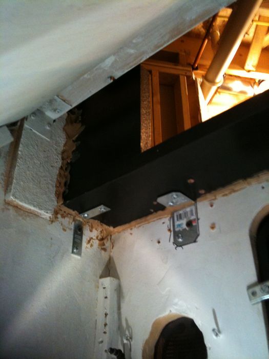

Here's just a few more pictures of how I did mine, to give you some ideas.
I was using an existing cabinet, so I cut a shelf into the cabinet to rest the CP on.   I've seen a fair amount of people add such a shelf to their new cabinet builds as well:
Then I kind of went overboard I think holding it in place.    I of course drilled the normal screws through the top of the control panel box.   Then I also used some support braces underneath to attach it.  And if that wasn't enough, I also lined it with glue.   That thing is going NO WHERE.  :)
And here you can see the finished product.  I used hinges as well for mine:
