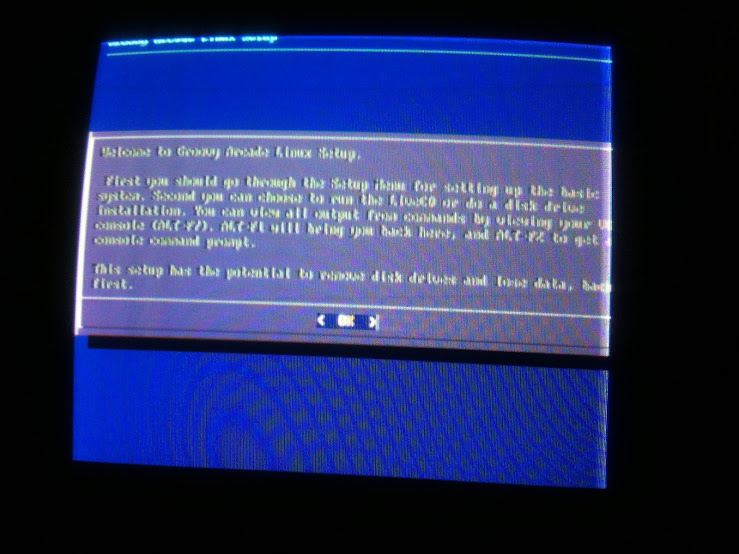

I'm hoping to use GroovyArcade with my original Space Invaders part II cocktail CRT monitor. In my PC I have installed an ATI Radeon FSC. When booting off of the latest CD, I get a stable (But not to the edges?) image of the GUI (1st image below). When I launch the front end however, I get a garbled image as seen in the 2nd image below. When using the setting  "generic 15.7 khz" (1st option) in the video setup menu, the garbled image rolls. If I choose  "Arcade 15.7 kHz - standard resolution" , the image is still garbled, but does not roll.
Any ideas on how to fix this?
GUI of CD looks OK, but image has big black borders:
When launching the front end, the image looks like this:

Hi tobiaspb, sorry for the late answer.
It looks like you just need to adjust your monitor. First use the horizontal frequency adjustment in your monitor chasis, that will bring the picture into sync.
Once you have a stable picture, play with the horizontal shift and horizontal amplitude adjustments until the picture fits the screen.

I could adjust the monitor as you suggest,  but would that not make the GUI look wrong? For starters I would like to use the same setting for the frontend as I sucessfully use with the GUI. Is that not possible?
Also, if I adjust the monitor, my PCB would no longer dosplay correctly I assume? I'd rather find a compatible setting for the frontend/MAME. Does that make sense?

Well, you should manage to find a horizontal frequency setting where PCB, Groovy's menu (gasetup) and games are all synced. It probably requires just a very subtle adjustment to achieve it. Bear in mind that all three frequencies are very close, and the monitor will have a range of tolerance, you just need to move the potentiometer a bit so these three frequencies fall inside.
As for the size/centering, you're right, you'll need different adjustments when you switch to the PCB, but you can also find custom software settings that reproduce your PCB borders size, if that's what you like (this won't apply to gasetup anyway).
