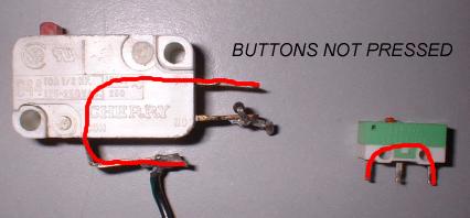

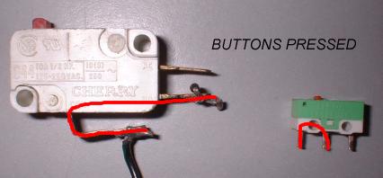

There's three slots to each mouse button on the trackball circuit board.  I'm assuming that I should wind up only using two of them and connecting the two that work together to the arcade buttons, right?
No, you should use all three (I think).
When I have done it in the past, I only used two wires.  However, when I was typing messages in this thread, I started wondering if maybe the correct way would be to connect the 3 wires to the 3 connections on the arcade microswitch.
I just did some tests.  I compared the microswitch that I desoldered from a mouse to an arcade microswitch.  Both have 3 connections, and they appear to do the same thing for the mouse and for the arcade button.
The red line indicates where the connection is made in each case.
Since the two types of switches are the same, and the circuitboard supplies connections for all 3, I recommend wiring all three to the 3 connections on the circuitboard.
In fact, I should do this to my hacked mouse.
