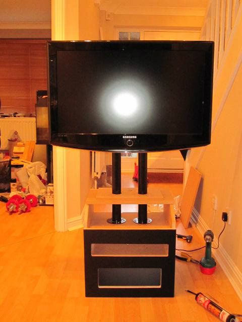

Now that I have a dedicated room for games, I need to get it all organised. My Vewlix cab is pretty much done, my gaming desk also nearly done, racing simulator looking ok but needing to be re-styled and my XBOX looking a right mess on a half finished cabinet. Got ---my bottom--- together today and started to rebuild the cabinet. I attempted one before but it didn't come out anything like I hoped so I stopped building it halfway through. This is my second attempt to build one.
Work done so far today:
This is a picture of a previous attempt. I'll be sticking with the poles for the TV mount for this new cab. You get the idea ...
Planning to put a couple of fans on the back for heat exhaust.

Last activity for today, Will be picking up again next weekend.
Top will be covered, the sides bevelled, legs added and extra side pieces made.
Doors will be added using some black mesh wrapped around a frame.
« Last Edit: October 28, 2012, 03:23:31 pm by SpaceHedgehog »

Front and sides skinned.
Sides bevelled and filledto give a bit more of an interesting shape.
TV in place (will get a new one at some point with a thinner bezel).
Now need to work on finishing the top and then the cabinet legs and shaped side pieces
« Last Edit: November 05, 2012, 10:59:21 am by SpaceHedgehog »

Are there any concerns about it being top-heavy?  Or is the TV light enough that the weight of the MDF is sufficient to keep it planted?  The first thing I thought of was extending the legs through the middle shelf, and to the floor.  Just to lower the center of gravity.  I've been pondering a similar build, might mix a bit of this into it :)
SpaceHedgehog
  • Posts: 937
  • Almost done ...
Re: Console Arcade Cabinet
« Reply #17 on: November 05, 2012, 04:00:29 pm »
Understandable concerns. The TV has been sat on a partially built previous version for well over a year so I don't think I'll have any issues. That one was taller by about 20cm (the TV was actually too high). This version has a top piece to further stabilise the metal table legs (which are bolted down rather than screwed). The addition of legs at the bottom with self leveling feet will further add to the stability as will the extra weight of the shaped side pieces (30mm thick MDF made from 18 and 12 mm sheets). The base is already quite heavy.
Edit: lowering the legs any further would prevent access to the middle shelf where I intend to put the speakers.
Will be interested to see any design ideas you have  :)

A couple of pics with the TV in place. A bit of work has to be done with getting this all fitted out correctly but you get the idea.
A thinner bezel on the TV will improve the aesthetics, I think.

Re: Vewlix Inspired Modular Console Arcade Cabinet - Base module progress.
« Reply #30 on: November 18, 2012, 09:05:30 am »
Supporting legs have been prepped and the adjustable feet fitted. I need to paint these before I attach them to the base of the unit.

« Reply #33 on: November 25, 2012, 09:00:29 am »
Sides, retaining piece and legs primed. Legs and retaining piece will be painted black.

« Reply #38 on: December 02, 2012, 04:25:42 am »
Legs and retaining piece have been varnished. Not completely happy with the latter so I may redo it at some point in the future.
