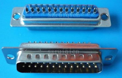

For those wanting to make swappable panels, solder type DB25 connectors are a good way to go. I used them as part of a universal harness I devised so I could swap (pre JAMMA) boards in/out of the generic cabs I have. They are fast to assemble and reliable.
http://img.alibaba.com/img/pb/243/086/380/380086243_457.jpg
Heh, I did the same thing years ago when I had an actual PCB collection that I had to reluctently sell off.   :hissy:

+1 on dsub connectors.  I use them for audio, video, and controls.  You can choose from a DB-9 up to a DB-37, and they work great with 22AWG wire.  Look up dsub connectors with solder cup termination on digikey.com.
