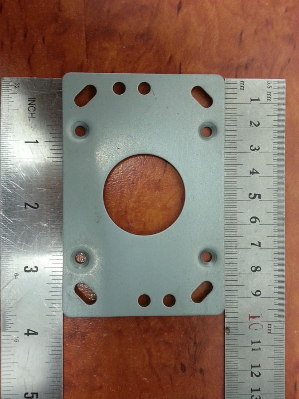

Can't help with an answer but can help with a pic of a zippyy mounting plate

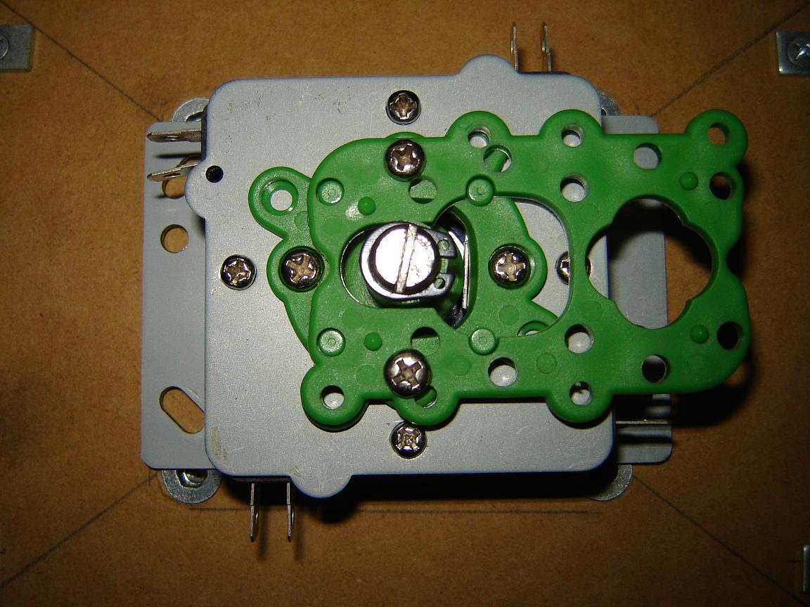

Are Zippyy Joysticks standard bolt pattern for mounting (like a sanwa JLW or Happ) or are they a smaller plate like a Sanwa JLF?
The Zippyys are definitely not the same pattern as Happ Supers shown here.
This photo shows inserts for mounting a Super with a Zippyy on top.
If you turn the Zippyy 90 degrees, the mounting plate  almost rests between the inserts.

The plate is 2.562" W x 3.822" H.
The center->center distance on the diagonal holes are around 1.7" W x 3.2" H.
