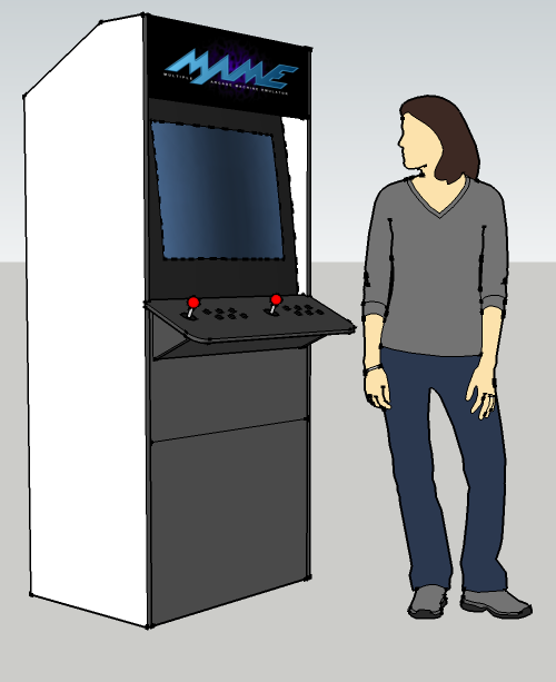

Thanks for moral support! Here is a screenshot from the Sketchup model, the cabinet is almost 2 meters in height (well over 6').
Being a Swede, I felt the urge to build the cabinet only out of IKEA furniture parts. (Or, rather, I had some stuff from IKEA lying around that I didn't need.)  ;D
I will post some photos further on as soon as things become more presentable.
