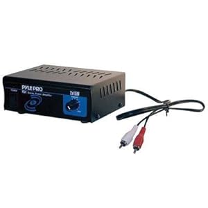

I did like Unstupid, I used two MS Pacman grills, the cheapest 6x9 they had at MediaMarkt (Magnat $19), and a dual-voltage 30w Pyle amp from amazon for $27
http://www.amazon.com/gp/product/B0012KZNP4
I then took the amp apart, de-soldered the potentiometer, soldered in 5 wires, and soldered the other ends back to the pot, then mounted the pot on the back.
It's the gold thing in the middle on the back with the wire hanging from it.
Here it is from the back (the tiny black thing to the left of the red button):
I bought the amp because it had one pot, and I knew I could relocate it.
