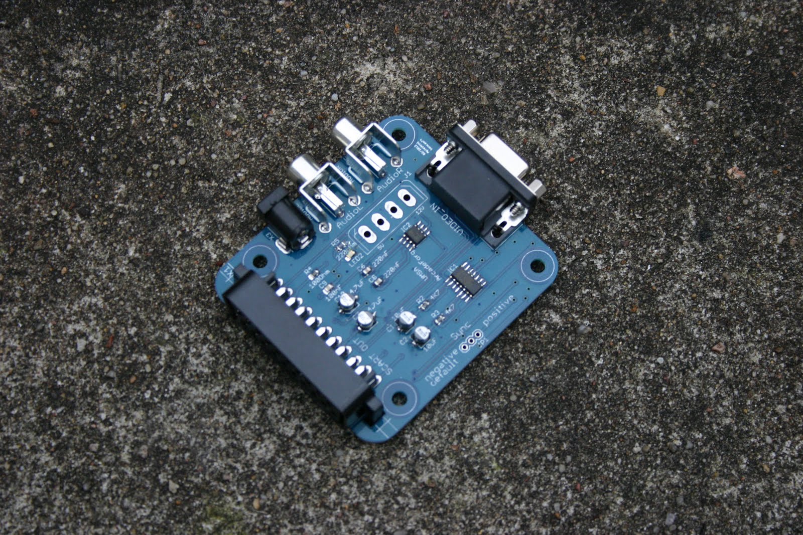

The only thing that's *different* about your situation from most people is the UMSA.  I don't recall anyone here using one.
Could there be a problem there?  Is it getting the proper voltage at the right amps?

It's this one:
It needs 5v and 15khz.
I connected my VGA directly to an LCD and the sound as well... just as it is. Same problem. Sound is stuttering. Means, it's not the UMSA.
It's really strange. Why would ANY game work at all with sound?
Crypt Killer works with sound, Mr. Driller aswell.
