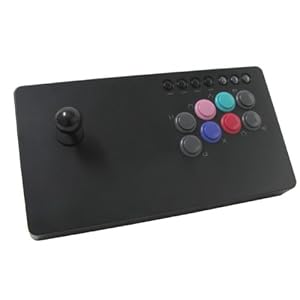

hey guys i recently began this arcade project, i want to turn my raiden 2 (currently not working unfortunately due to battery) into a ps3 cabinet. Why ps3? simply because i want a arcade machine in my home with up to date and modern fighting games (street fighter 4 AE, tekken, blaze blue, UMVC3, etc.) my question is to those both who have build a ps3 arcade cabinet and to those who have build a regular arcade cabinet, what are the expenses after successfully building the machine, how difficult is it? plug and play? or all these high tech wires everywhere in the cabinet, and what screen projector do you guys use? a LCD? or those big tvs that are originally inside the classic arcade machines? many thanks and appreciative for replying :)

Like mgb said, if you go with a new LCD, there will be no real wiring involved.  It will be more of a woodworking project (look up VESA mount LCD).  If you can hook up a PS3 to an LCD now, you can hook one up mounted inside a arcade shaped entertainment center.
The only real technical issue is the control panel to PS3 interface, then it's down to cost, somewhere there is a plug and play interface ready to be bought for the right price, or you can try to make one by butchering a normal controller (left,right,up,down is easy, it's the analog sticks that are going to be an issue to hack together).
Just get 2 of something like these and remount the parts:
http://www.amazon.com/PlayStation-WWE-Stars-Brawl-Stick-3/dp/B004M25NNQ
or
http://www.amazon.com/Universal-Arcade-Fighting-Joystick-Playstation-3/dp/B0015PHMFU
[last minute edit]
http://www.amazon.com/Playtech-Arcade-Fighting-Stick-Playstation-3/dp/B004DFDVWW
Just don't kill yourself taking out the old CRT (read:discharge it first), if it works, sell it on ebay or CL.

If you are looking for Buttons and joysticks to choose from , Popular brands are Seimitsu and Sanwa (if you wanna learn more about buttons PCB and those sort if things you can check out this website its awesome even though its not for a cabinet it has useful stuff on the arcade stick itself http://www.slagcoin.com/ . )
As for the PCB a cheap and pretty  good one will be the ZD rematch . The ZD remtach works for both PS3 and PC ( here's the link http://forum.arcadecontrols.com/index.php/topic,116490.0.html ) . For shop to buy buttons , joysticks balltops and all those stuff you can check out these few website , AkihabaraShop.jp http://www.focusattack.com/ http://www.arcadespareparts.com/arcade_parts/sanwa_parts.html .
