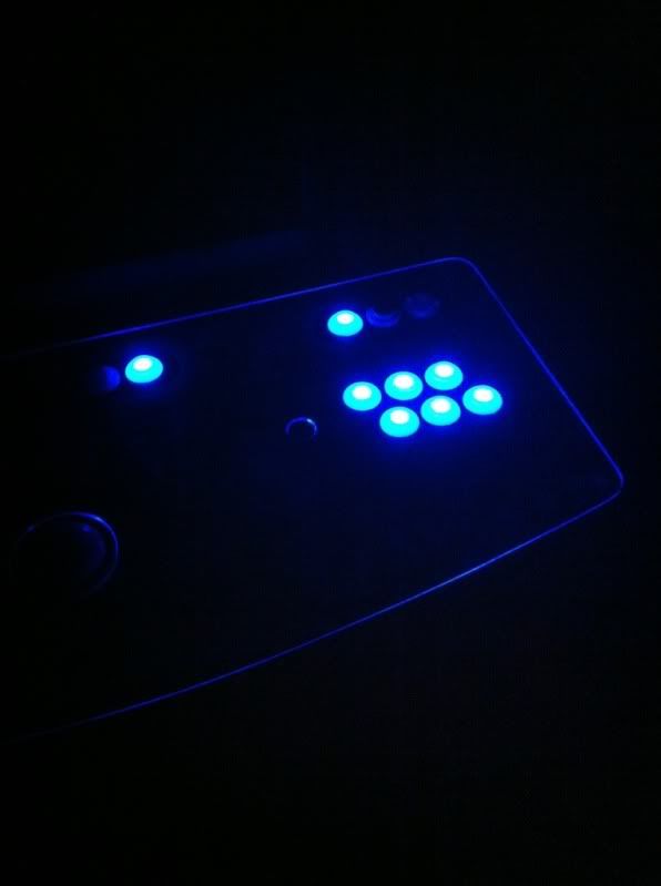

The lighting is interesting.  These are my first "milky white" LED buttons, so I found it interesting that in full daylight, the centers of the buttons would take the color of the LED that's currently lit, but the edges stayed milky white:
In the dark, it reverses and the edges become the most colored and the centers begin looking more milky white:
Also, they are bright enough to allow some edge lighting for my CP Plexi:
