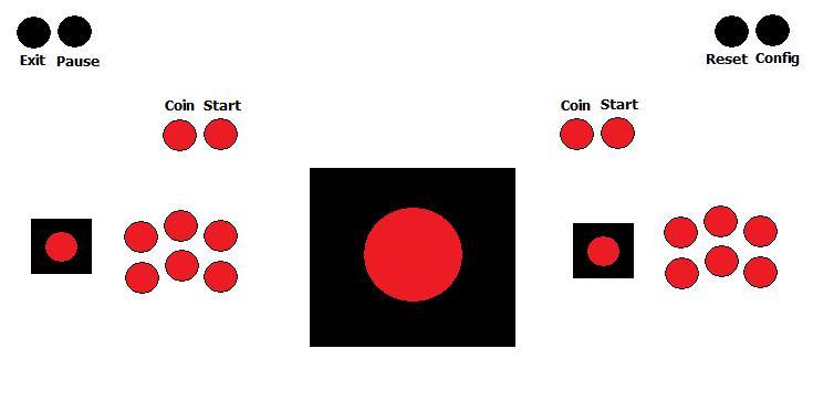

I am considering something like this as a potential CP layout. It seems simple enough, but I should get the functionality I want as well. What do you think?
Change "Reset" and "Config" to "Enter" and "Menu" (Tab) and you have all the basic admin buttons.  You might want your admin buttons in one horizontal line and grouped functionally.
I used Paradise Arcade's LED buttons and printed my own inserts for this layout.
Depending on how you set up your front end software, you may not need the mouse buttons and some people don't have a Menu button to keep curious kids or friends from messing up their configuration.
Slagcoin has some great player button layout templates.  You can print and tape them to a cardboard box test panel to evaluate the feel of the various layouts before you commit to one.
P.S. Hope nothing was damaged by taking apart the Intrepid.  :scared

Also, in terms of the layout you suggested for the admin buttons, a friend of mine (who also came up with the CP layout I posted) tried putting the escape button right in the center like yours, but he found that until he got used to it, he would accidentally press that if he had an exaggerated trackball throw in Golden Tee. That's the main reason I'd like to put the escape button elsewhere.
Sorry I wasn't clear in my earlier post, but I'm using a portable modular panel.  My trackball usually sits directly below P2 Start.  If you swap the mouse buttons to the right of the other admin buttons, the escape button will be far enough out of the way.
I figured from the amount of real estate on the upper area of your panel that you might be thinking of Golden Tee type games.
Also, in terms of the mouse buttons, I was hoping to actually get a switch that will swap my trackball to act as a mouse and my coin/start buttons as left/right mouse buttons. It cleans up the CP layout a bit and it worked out for the aforementioned friend.
"swap my trackball to act as a mouse" - What does it act like normally? :duckhunt  I keed, I keed.
As far as the switch goes, a DPDT toggle switch will do that but I'm not sure if it is worth the effort to change from four buttons to two buttons and one switch that may or may not clash visually with the rest of the panel.   :dunno
Before you finalize your panel design, you might want to consider:
- What games do you definitely want?
- What controls do they require? (Playing Donkey Kong with an 8-way stick can cause serious frustration.  :banghead:)
- Do you want it to look/act like a dedicated arcade machine or a computer?
- What front end do you want to use? Many have you navigating via joystick, selecting the game by player button, and exiting by pressing P1 Start+ P2 Start at the same time.  With this setup, you never use the mouse buttons or some of the other admin buttons.  Just remember to print an instruction card for guests.
- Do you want a specific fixed list of games, or do you want to quickly or constantly change them?
- Do you want a spinner? (Arkanoid, Tempest, Omega Race, Puzz Loop, etc.)
- Which encoder do you want to use? (Mini-Pac Opti, I-Pac, KeyWiz, Xin Mo, etc.)
