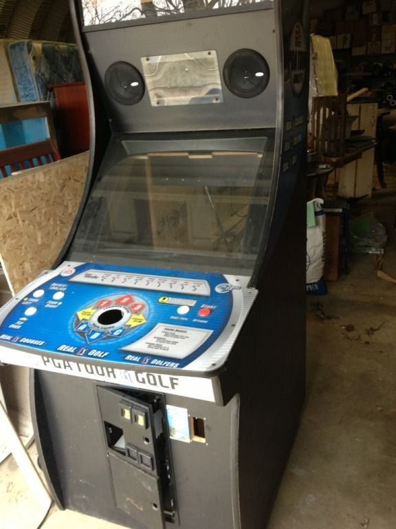

]A while back I picked up a pair of kiosks from work. 1 of them became my home jukebox. http://forum.arcadecontrols.com/index.php?topic=118409.0
The other a friend of mine wanted converting into a jukebox. Which then became a Jukebox/Arcade machine. Well here is the Kiosk and some of the plans I created.

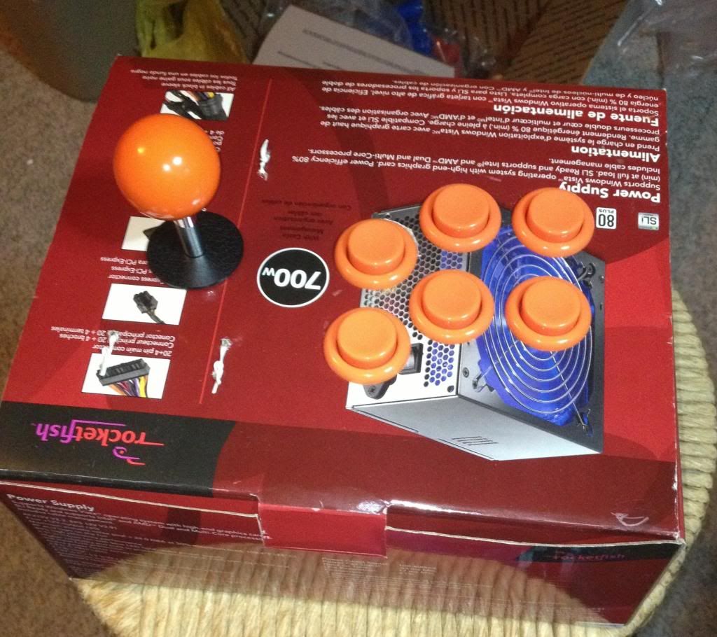

Ultimately I purchased a set of cheap Joysticks/Buttons and decoder and started by building a cardboard mockup (Ignore the buttons at the bottom I messed up)
