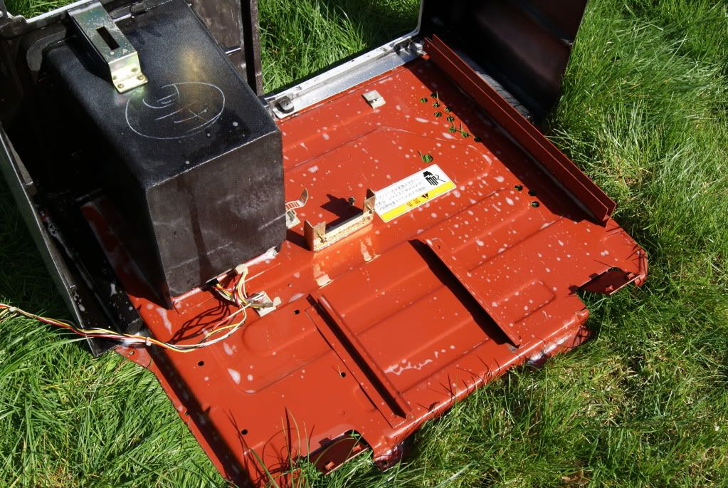

Any tips on drilling the Sega 5575 lock?
I have ordered new locks and keys but I suspect the coin box will be a different key.
The coin box is the only one still locked on my cab.
I won't try to drill until after I get the new locks and try the key.
If the key doesn't open the coin box how do I drill the lock to get it open?
This is the lock:
This is the key:
Should I drill at the center of the keyhole?
OR
Should I drill at the center of the entire lock?

« Reply #2 on: June 14, 2012, 01:57:48 pm »
The door is the coin valut box in the bottom right:
From inside:
From behind:
I don't think there is a way to get into that coin box without bypassing the lock.
OR

I would try jamming a large flat screwdriver in that lock and using a pair of vice grips try and turn it.
failing that. go for the center of the lock. (not slot)

How nice is the cabinet. If it is so, so, then just pry it open with a big flathead screwdriver and then bend the door back straight with a vise grip when you are done.
Otherwise, go buy a half inch bit (preferably one with a guarantee), and drill that lock on out. Take a lot of breaks to avoid overheating and breaking the bit.

Thanks for the advice everyone.
As stated in the first post I have ordered all new 5575 locks and keys.
So in the end it will still have authentic locks on it.
I've read where the coin box can be a different 5575 type key and this is why I posted the drilling question.
The coin box lock is the 5575 type so hopefully the same key will work.
The cabinet is in good shape so no prying the door open.
The other locks seem to have been accessed by loosening the locks from behind so the previous owner probably did not have the key.

I received the parts from Japan yesterday.
The 5575 key opens all of the locks on my Blast City cabinet.  8)
