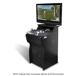

you could always build something like this and set your 22" on top :
http://www.amazon.com/Xtension-Arcade-Pedestal-Cabinet-X-Arcade-Tankstick/dp/B003Y9YJBK/ref=sr_1_4?ie=UTF8&qid=1338571734&sr=8-4
I wanted to go way bigger, so I built my pedestal to sit about 4 feet away from the wall on which I have mounted a 40" LCD which will rotate 90 degrees for vertical games.
Either way, you will run into trouble with "Area 51" style shooting games on an LCD, if I remember correctly.
