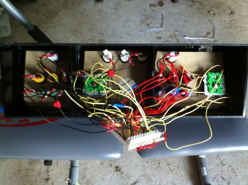

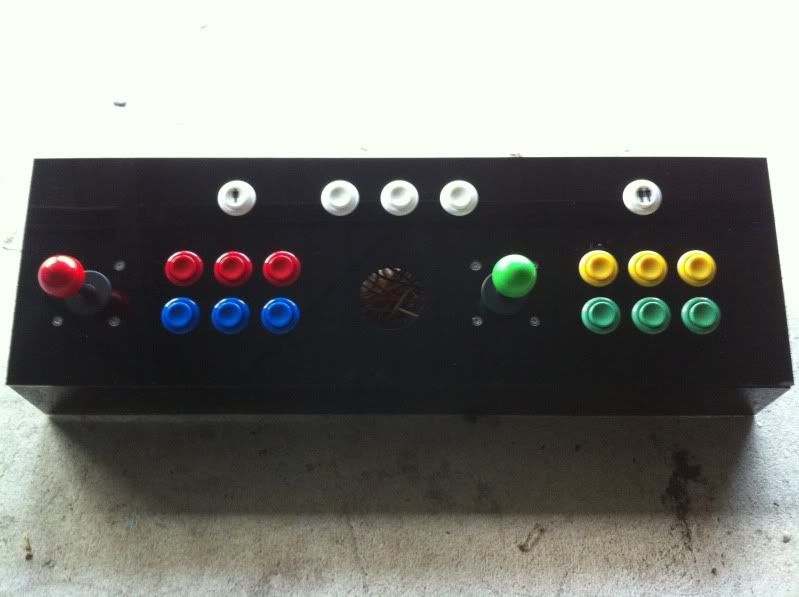

After a very quick web search I found enough info to be dangerous order some buttons and joysticks from ebay and attacked a keyboard.
Using my LASER cutter I knocked up a quick and nasty, very nasty, control panel to have a play.

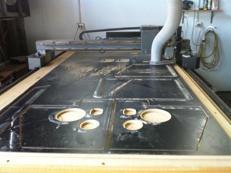

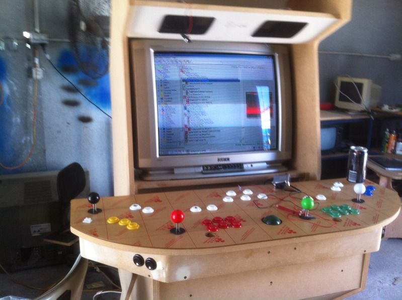

I then jumped straight in cut up some MDF on the CNC router and made a cabinet. I used the UAII plans based around a TV I was given. Once I had it together the size of the thing was a bit daunting.
That is as far as I got. Then the TV died... then another TV died. Add to this the cost of laminate to finish the cab was going to be stupid.

Fire up the CNC again and we are away
I'm working with black melamine on 16mm MDF. more to come soon.

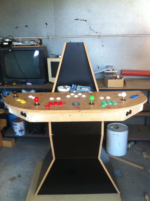

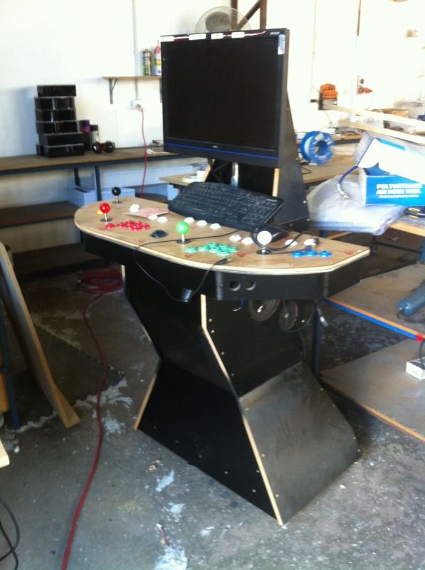

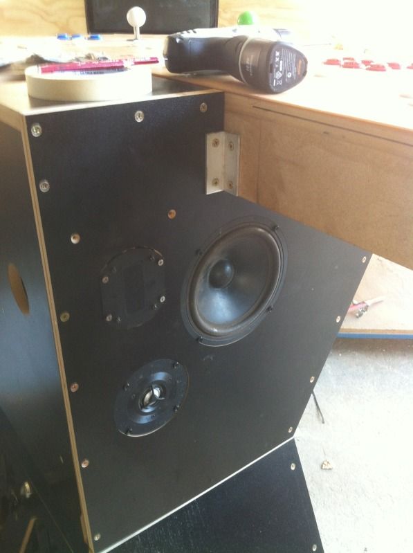

Got a chance to do a bit more assembly, one of the advantages of CNC is once the cutting is done it will move along pretty quickly. The speaker drivers are in and the crossovers are wired too.
the rainbow of buttons will all be changed over time and it will get a recessed base with concealed wheels rather than the board it is sitting on. More to come soon.
A few of my friend that have seen it are pretty keen for one for them selves I thiugh that next time in place of the speaker boxes I might put a projector...

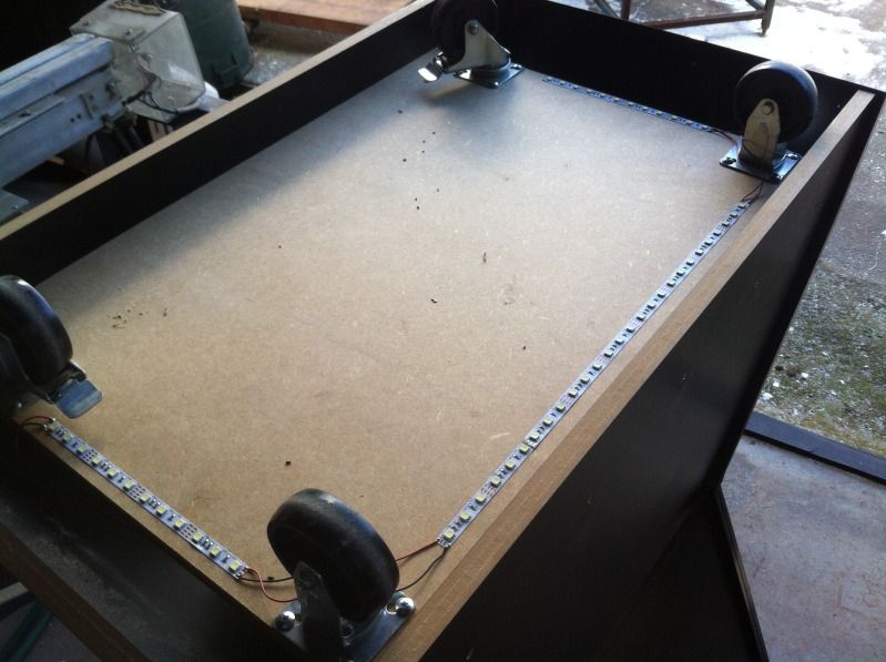

I got the base and the wheels mounted and added some white LED strip for shits and giggles

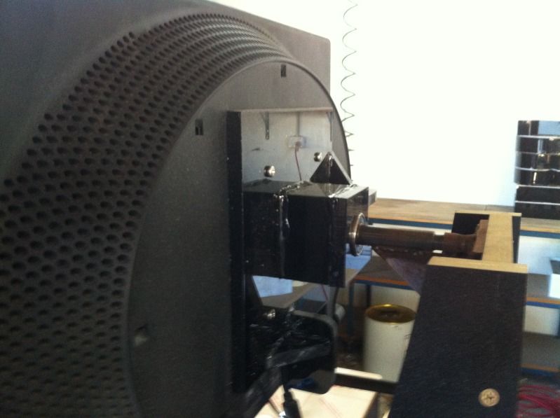

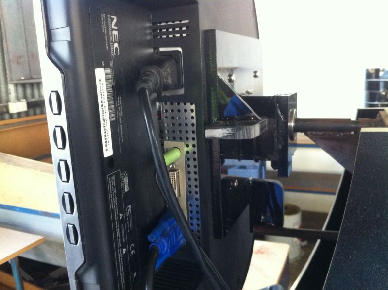

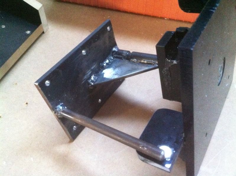

Then I was on to the rotating monitor mount.

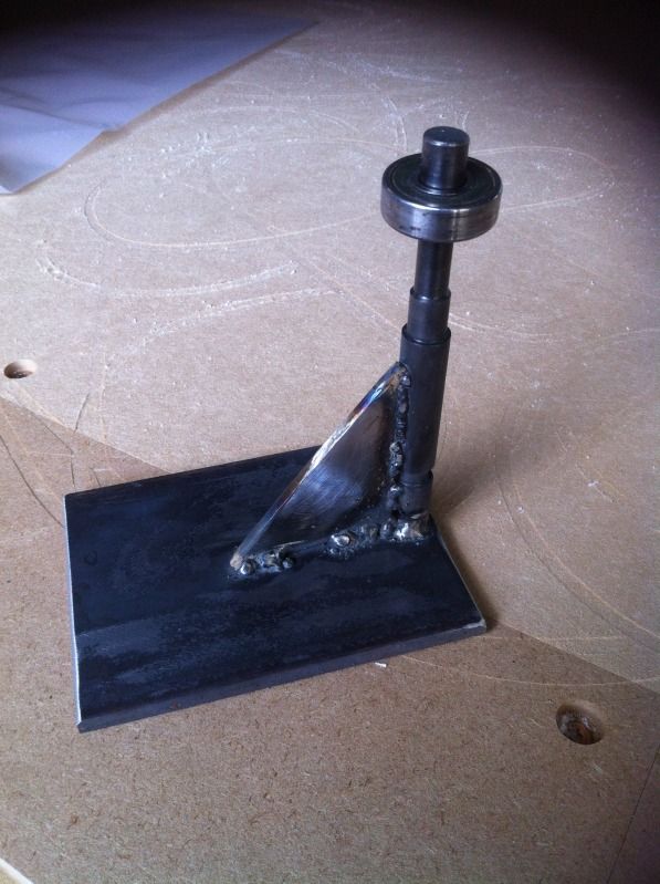

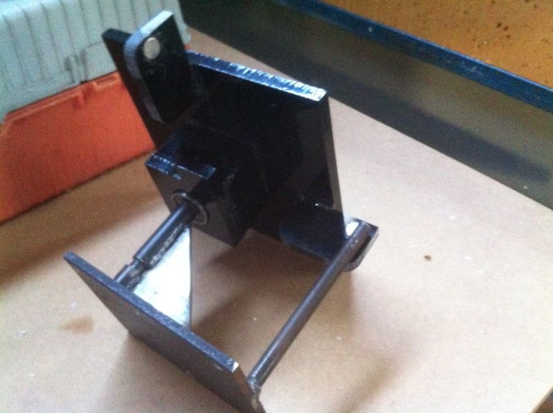

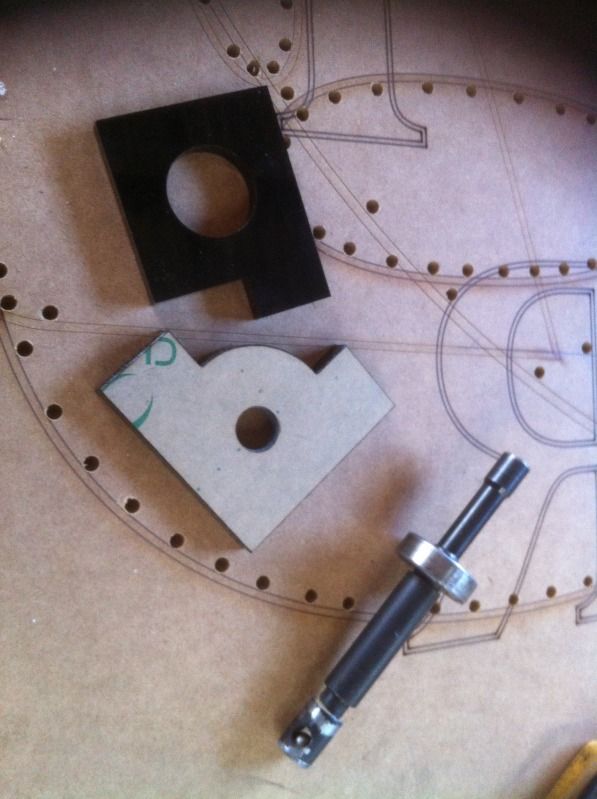

I started with two bearings, an axle, a few bits of steel plate and some LASER cut acrylic. I am sure the steel is overkill but I wanted it to be strong.
A little welding later
The original plan was to have stops at 0 and 90 degrees on the LASER cut acrylic in the second pic, I assumed incorrectly that the monitor would be balanced and stops this close to the centre would be enough but there was just too much leverage from the oddly weighted screen and the mounts broke.
So I put longer stops with magnets and a piece of rod for the stop
And the mount is done.
I'm very happy with how smooth the movement is and the magnets are strong enough to hold the screen in place.

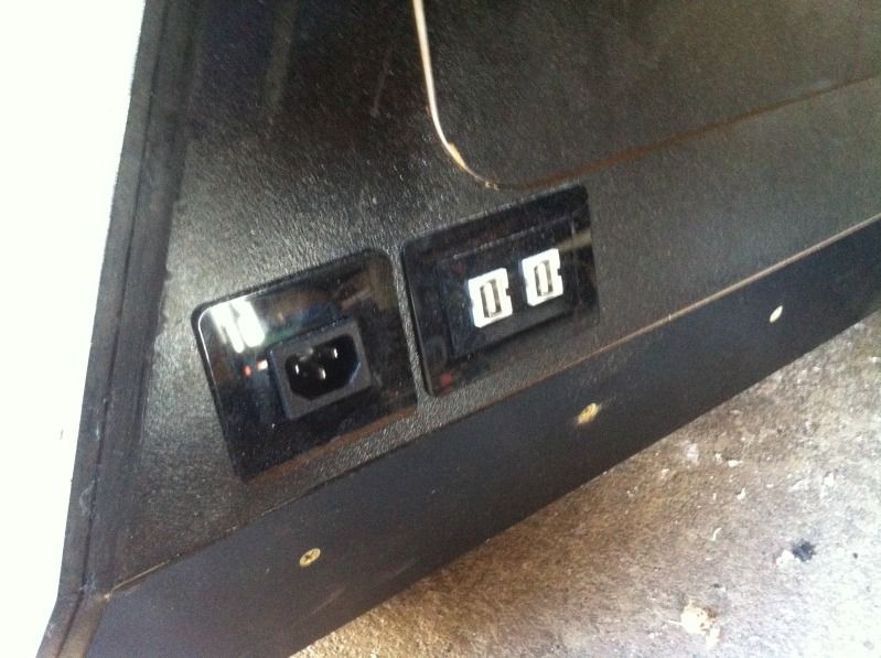

A few little LASER cut acrylic dress plates for Power and USB inputs
and short of disassembly for some finishing the main cabinet is done.

and one more quistion how is the monitor rotated mannual or mechanical ???

At this stage the monitor rotates manually but there is very little force needed so the auto rotate will be done later down the line

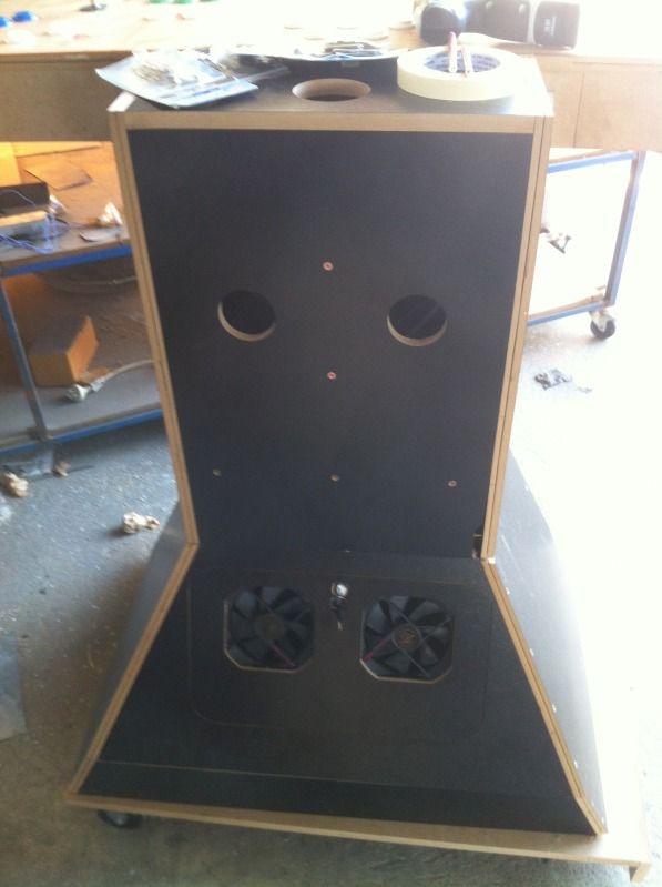

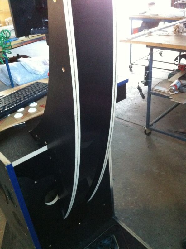

After test playing for a while I discovered that my cab was too front heavy and thus very easy to tip forward with only a little pressure on the CP. Not good when my two young boys will be playing the machine. Add to this the monitor was too close for my liking so moving the monitor back was a good step to help both issues.
This is what I came up with.
This has moved the screen back by 200mm or about 8 inches.

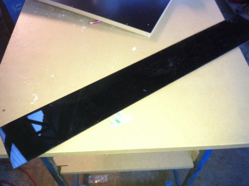

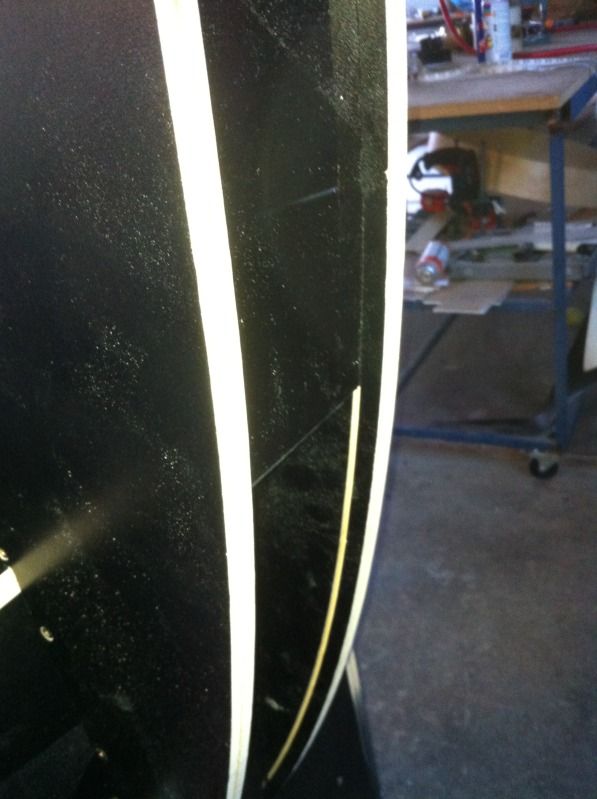

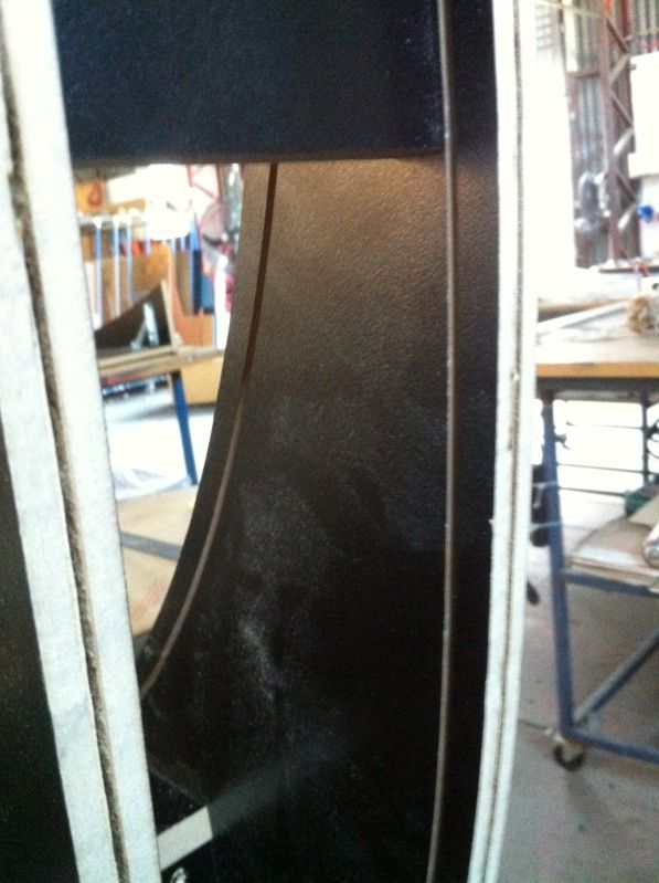

I've also had a rethink about how I will enclose the monitor mounts. I have router a 3mm groove in from the edge.
with a piece of 3mm black acrylic that slides in the groove
It's hard to get a good pic of black on black but the acrylic gives a nice finish with no need for laminate or paint etc

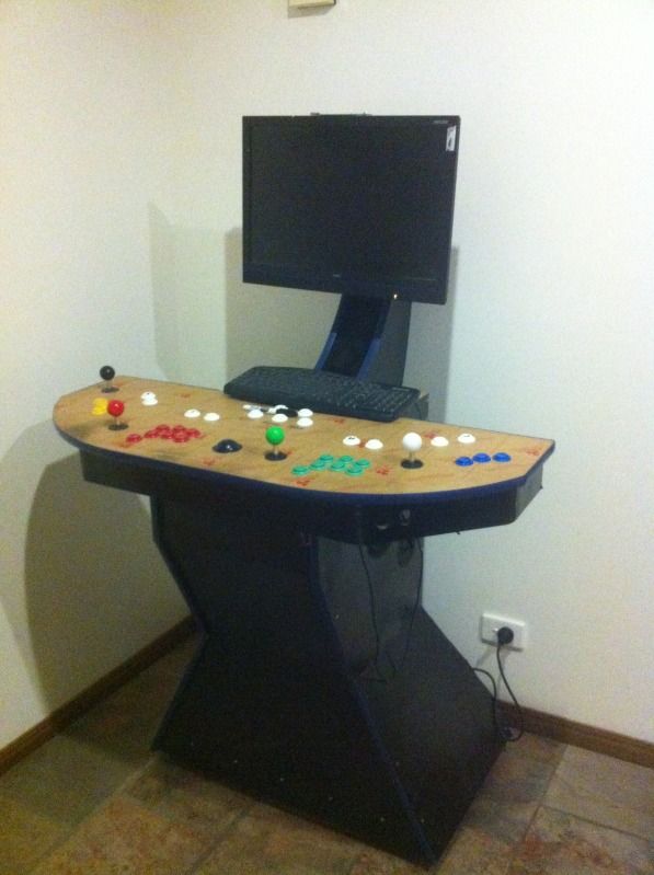

Sorry Guys it's still going but I've had to put it on the back burner for a while as real work has gotten busy again.
Most of the major stuff is done and the cab was moved home on Friday I'll get some pics tonight.
Other than the software side of things it still needs CPO artwork and a bit more t moulding. But it might get a completely new CP anyway as I'm not super happy with how this one plays.
Moving the monitor back has made a world of difference in both stability and viewing angle. My 2 year old has been swinging off the front as my older boy and I play with no hint of tipping. Viewing angle is still a bit average from P3 and P4 but I am using and old LCD that is not great anyway.

This is very similar to what I'm planning to do as well except I plan to use an automated system to rotate a 42" TV.  So your rotation is all manual right?  Very interesting design.  Good stuff!
selfie
  • Posts: 177
Re: Regrets or take 2... the un-named pedestal cab
« Reply #13 on: July 12, 2012, 06:28:05 pm »
At this stage the rotation is manual. I have always planned to incorporate auto rotate at some stage so the axle and bearing were built to have as little friction as possible
