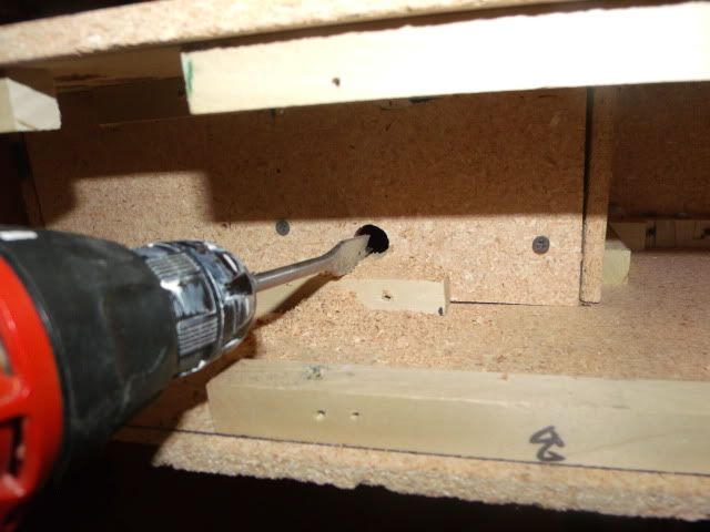

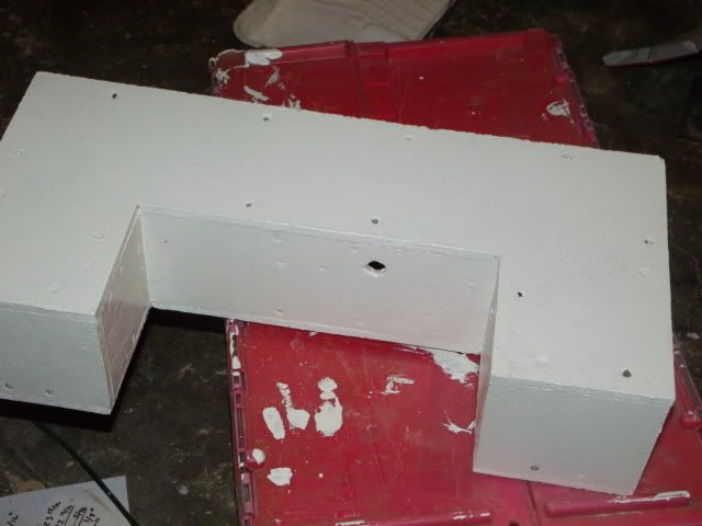

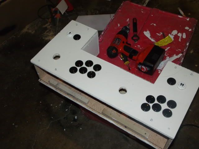

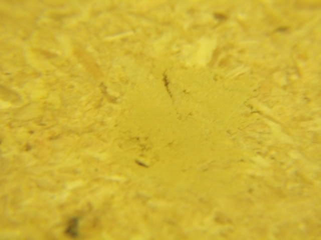

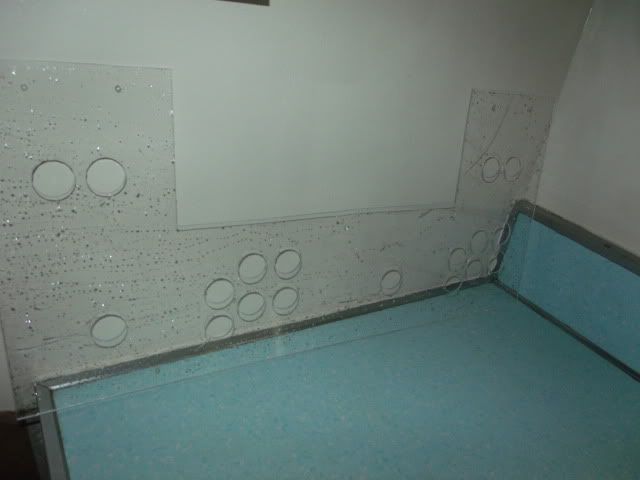

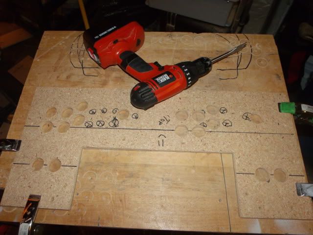

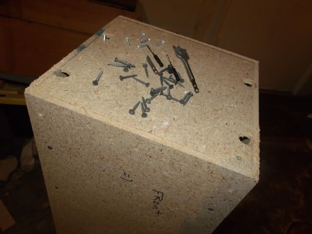

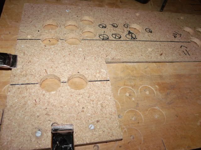

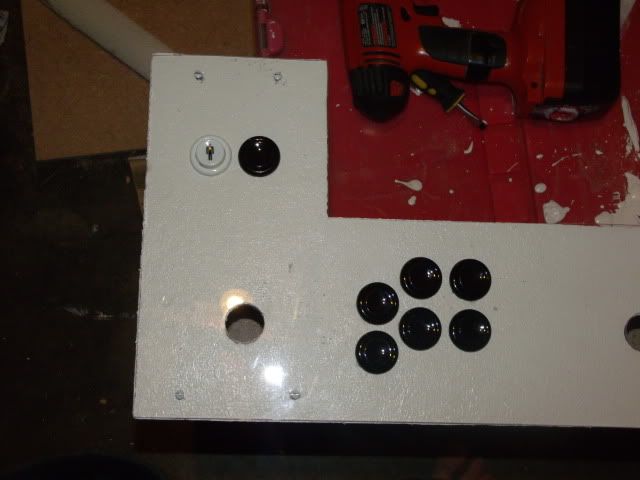

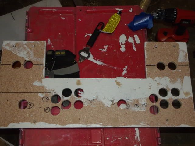

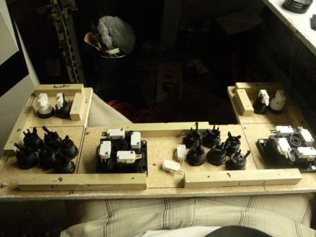

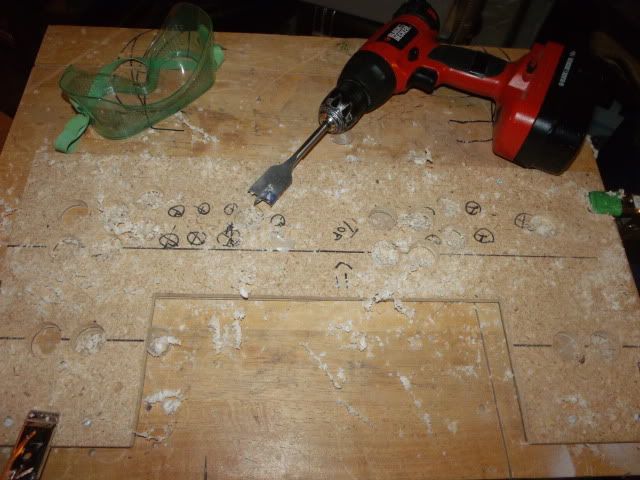

So I drilled the acrylic and did some painting, here is a picture update  :applaud:
Aligned the Control Panel and acrylic up with clamps.

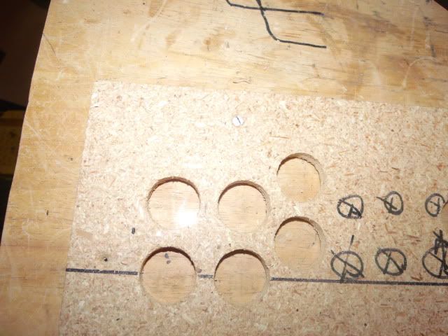

There will be a few white headed screws that will hold the acrylic on the control panel, I drilled the holes for it here and inserted the screws to help keep the piece from shifting while I bored the button holes.
Some people have their own ways of making holes in their acrylic, I prefer to use my spade bit. I align it with the hole, set the drill to Power - 3 so if it tried to pull and rip the acrylic it stalls. I push in slowly and basically what I am aiming for is the spikes on the outer part of the bit slice a perfect circle. Kind of like a jewelry thief cutting glass.
Turned out pretty well in my opinion

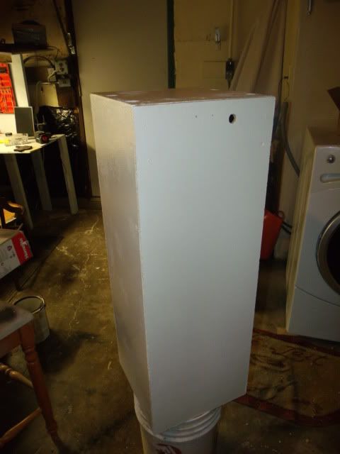

Painting prep.

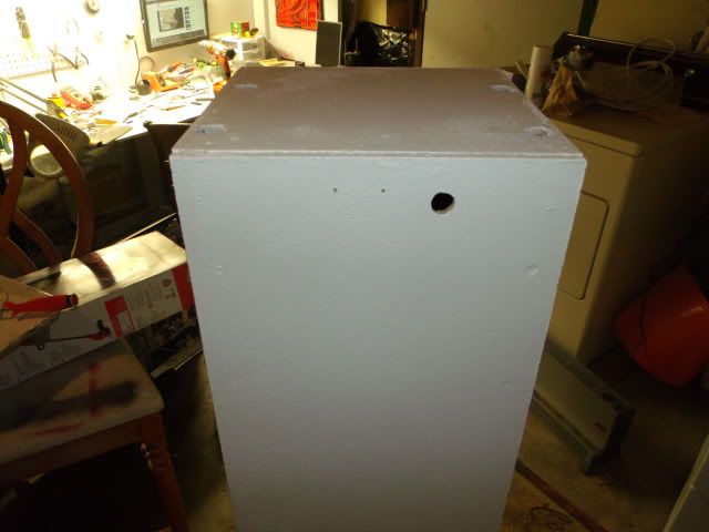

Small spade bit to create a hole for control panel wires to go into the pedestal
Removing the control panel from pedestal.

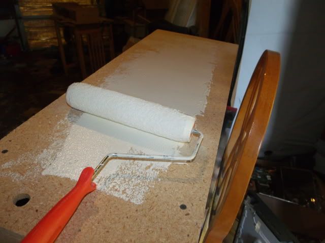

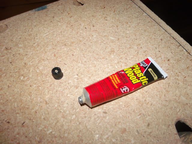

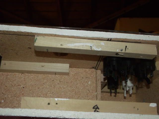

Time to close up any gaps and screws with some filler
Used to be a screw here - I am sure you all know how it works, I just like pictures
There were a bunch of spots to cover so I wont go anymore into that

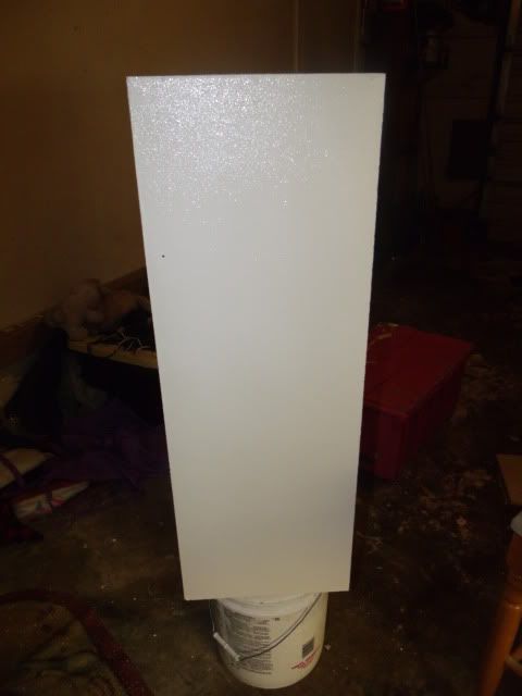

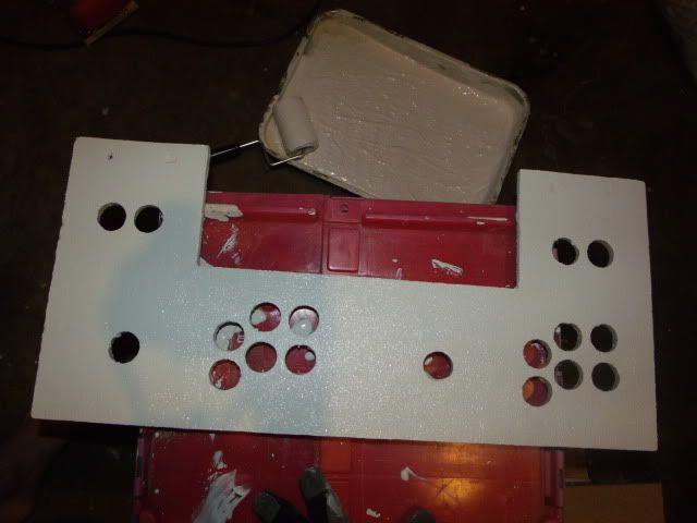

Painting  :applaud:
After first coat, will then sand and do another coat (maybe 3 altogether)

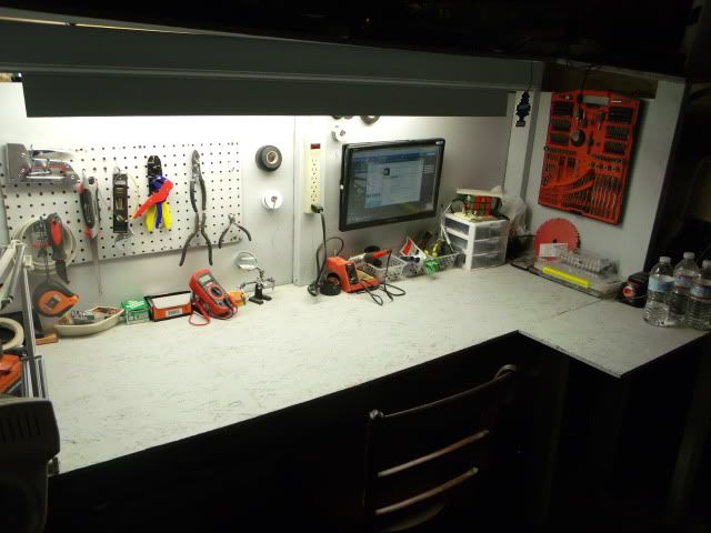

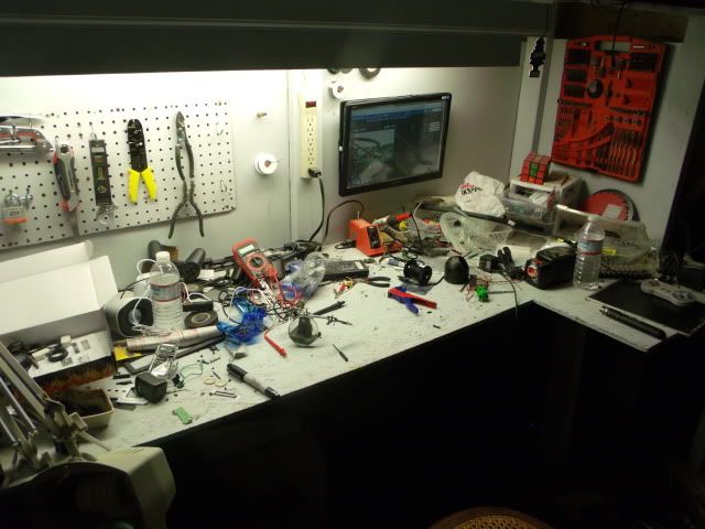

(I swear my electronics bench is clean most of the time)
Shot of the bench when I work on a project
And when it is idle (clean)
Okay, back to the project

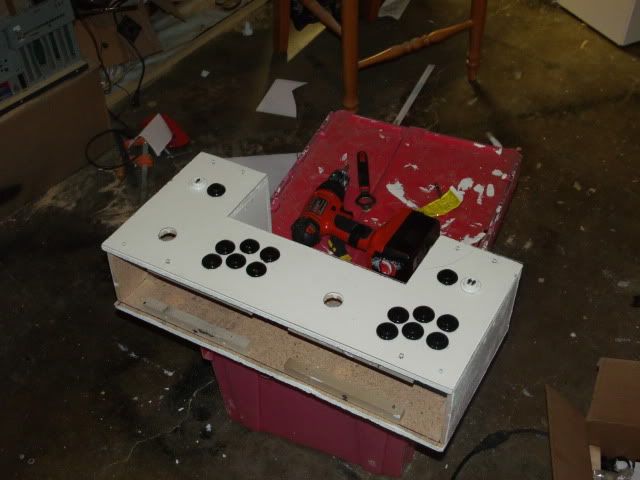

First coat on the control panel, just the bottom & sides for now
Just need to sand\re-coat the wood (including the CP) and I will be done with cosmetics for now.
 :laugh: Soon to be working on my favorite part of all, the electronics! :laugh:

cory, how do you like using the spade bit for doing the acrylic? i have used standard bits, low RPM bits, spade bits and forstner bits, and i am just wondering what your impression is and at what speed you use it at?
CoryBee
  • Posts: 2093
  • Bopity Boopy
Re: Bartop Arcades ~Lots of PICTURES~
« Reply #86 on: June 08, 2012, 10:37:35 am »
I quite like it, I find it easier than using the hole saw bit I first started using. It ended up cracking the acrylic half the time. With the spade bit I have it works pretty well and haven't cracked any acrylic since I turned my drill down.
Oh and like I said I keep the drill at speed "3" while using that bit on the acrylic.

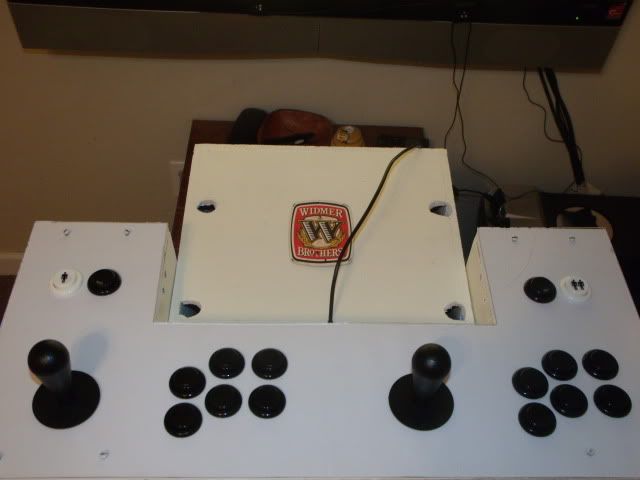

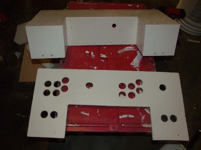

Didn't get much sleep last night due to this project, made some headway though.
Prepping with filler and painting the control panel
Dry Fitting the buttons

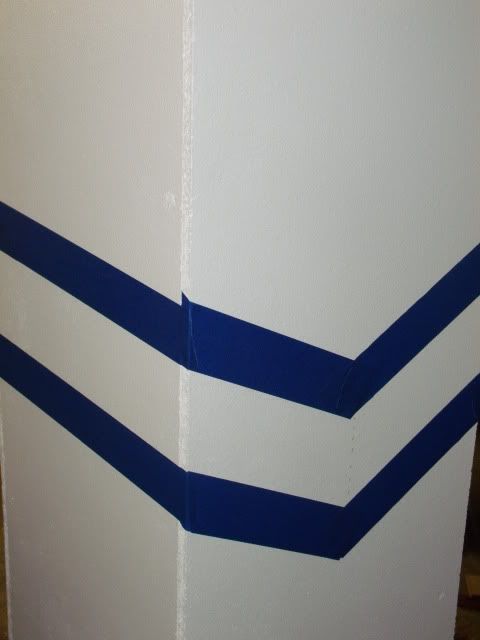

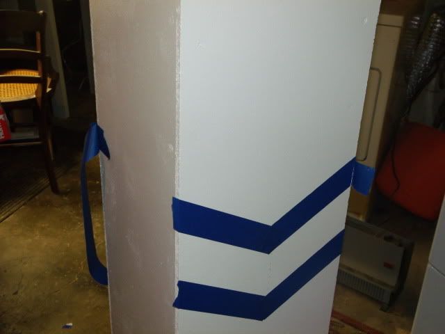

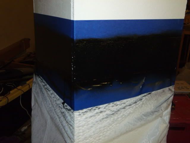

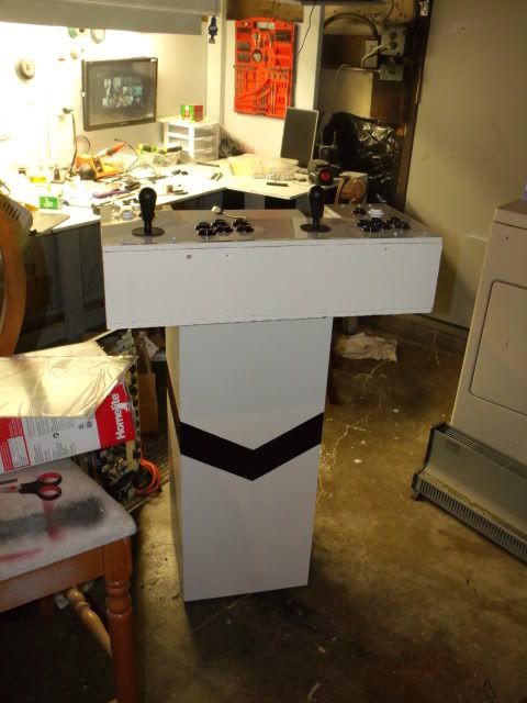

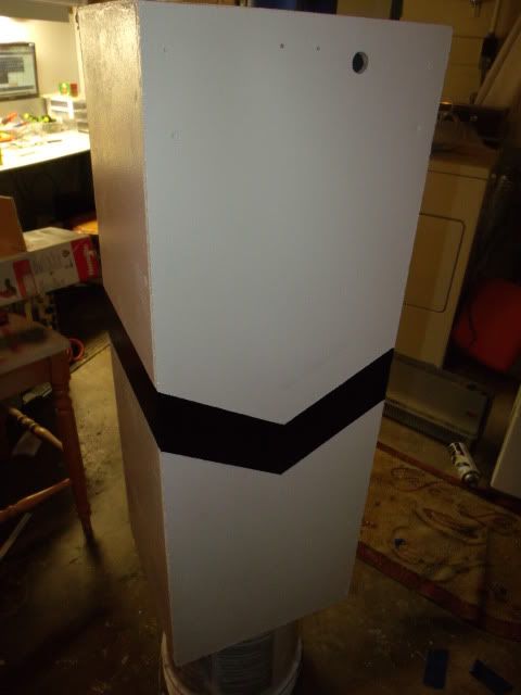

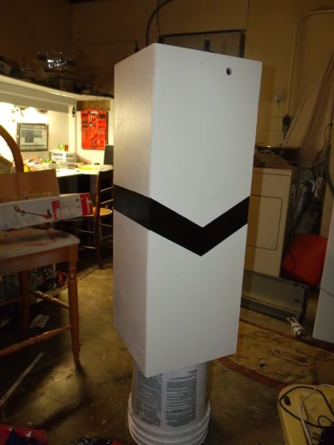

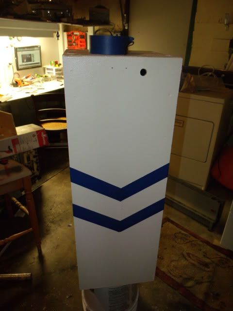

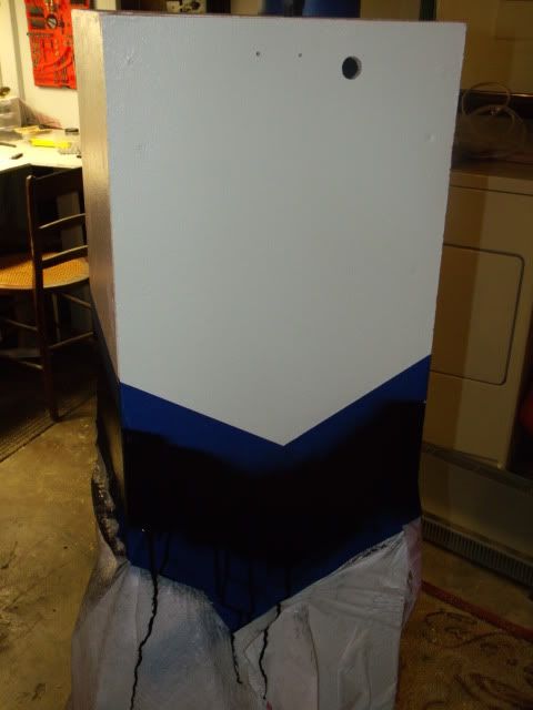

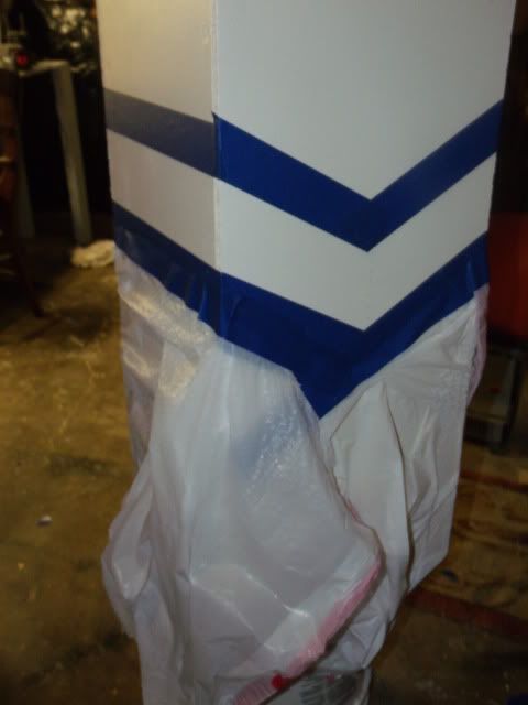

After painting the control panel I wanted to see if I could add a little design, a V in black on the pedestal
Keep in mind I have never done something like this so out of my element
Taped a bag around the bottom to catch any spray paint that dares drip on the great pedestal
PAINT  :applaud:
Removed the tape and bag, I think I did a stand-up job for the first time. The black will match the buttons

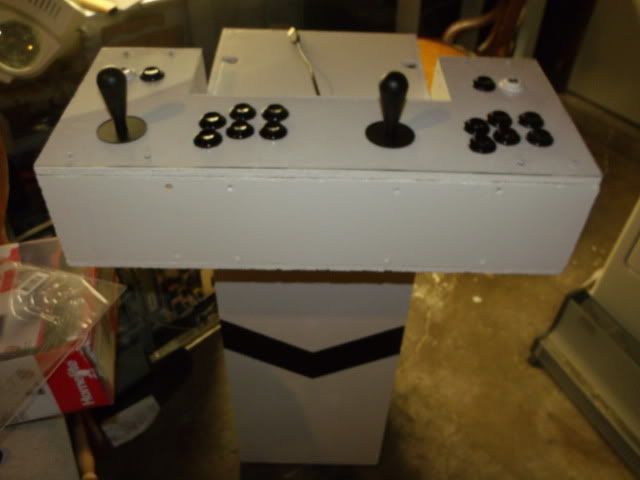

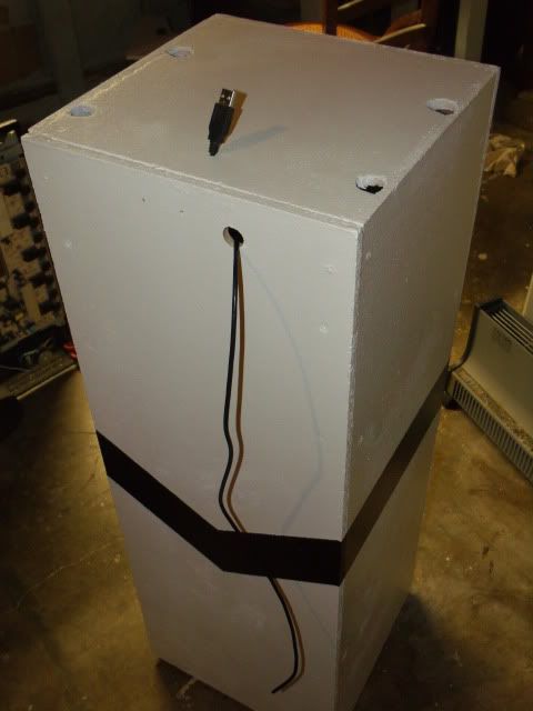

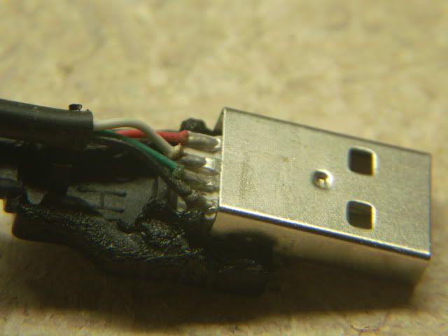

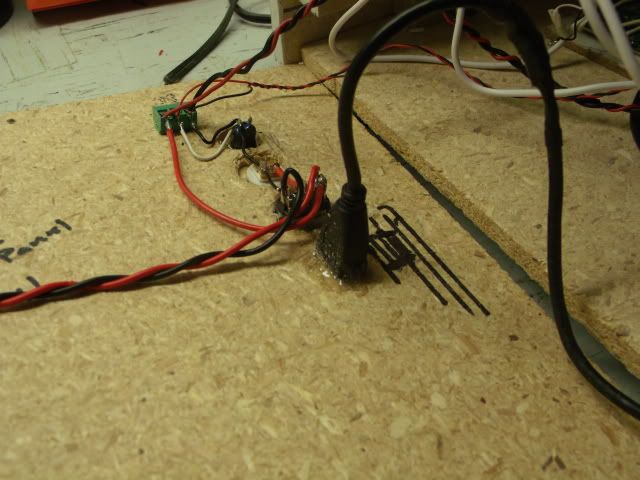

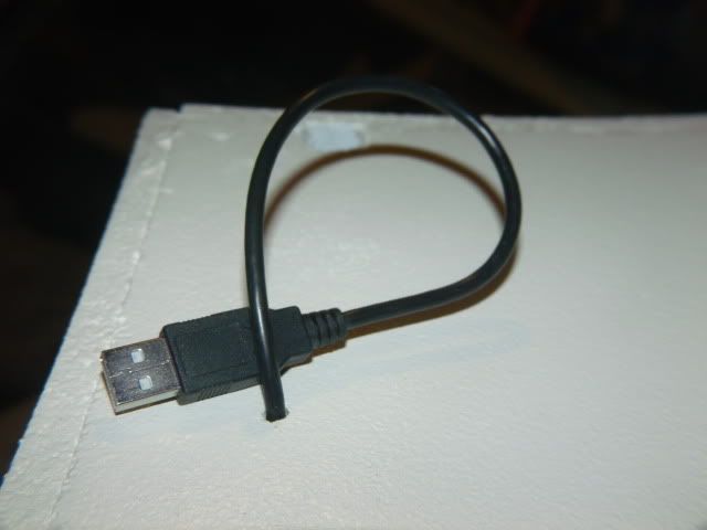

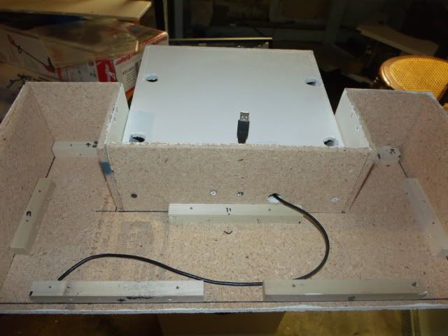

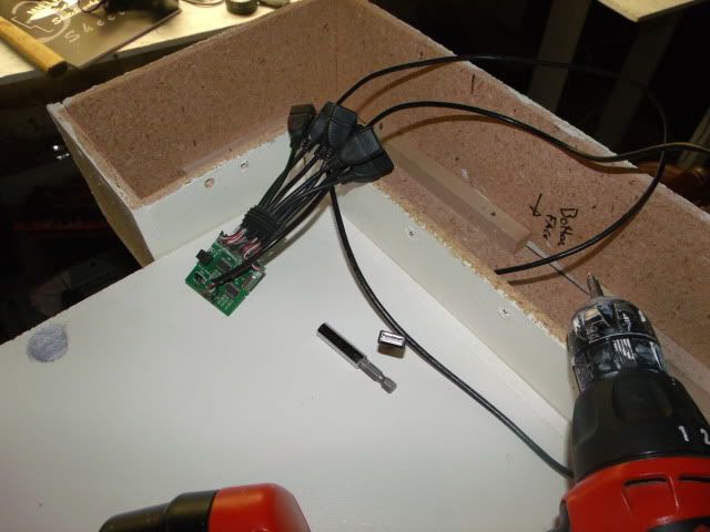

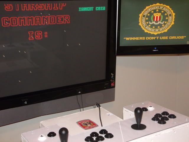

Inserting a 6ft USB cord into a small hole I made. It goes to the control panel via the hole I made before
Cord with control panel base connected

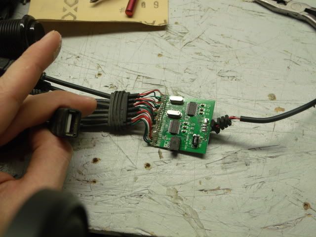

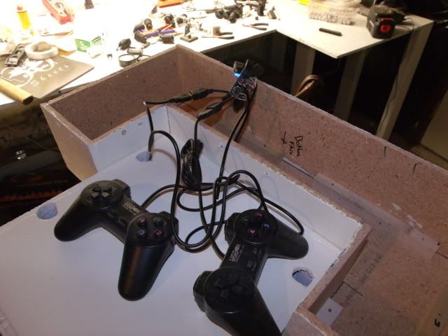

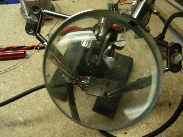

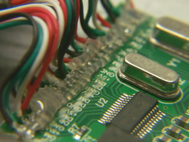

Thought I would get a little soldering done too, here is the USB hub. De-soldered the short cord and soldered on the 6ft cable.

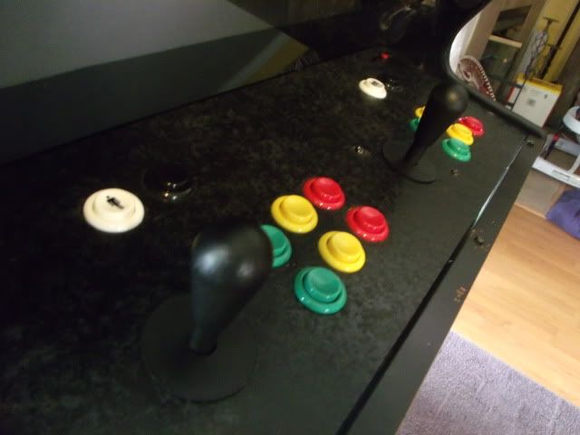

Testing the gamepads on the USB hub
Installing all of the buttons and mounted the joysticks

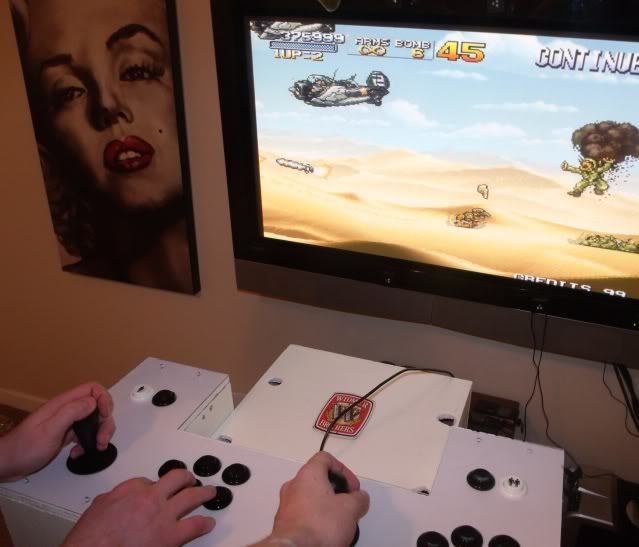

 :applaud: Finished with the cosmetics!   :cheers:
I think the black stripe really accents the black buttons
 :P
Bartop docked  :blah: No actual wiring is done yet so It is just for looks as of now
I am thoroughly pleased with how it looks considering the minimal tools I have, crappy wood, and no wood working experience.
Let me know what you guys think. I will be getting to the electronics side of it soon, I already figured out how I will duplicate the player 1 controls to the dock through USB. Stay Tuned

Looks like I could tip it over pretty easy. No?
CoryBee
  • Posts: 2093
  • Bopity Boopy
« Reply #90 on: June 08, 2012, 06:30:45 pm »
Looks like it, but no. Pretty heavy at the bottom buddy. PLus I will be adding more weight as well. I stress tested it pretty well.

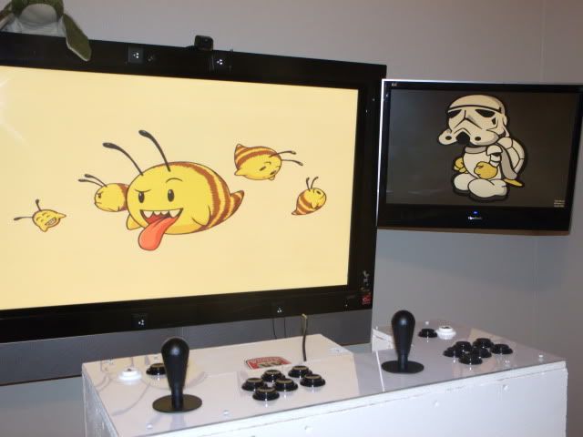

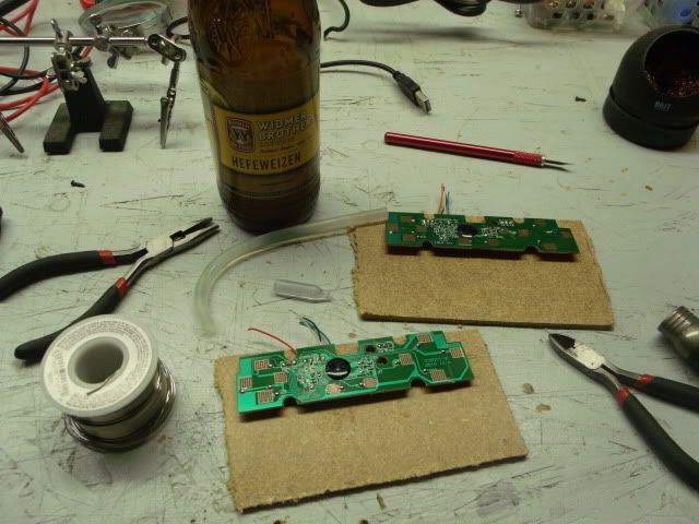

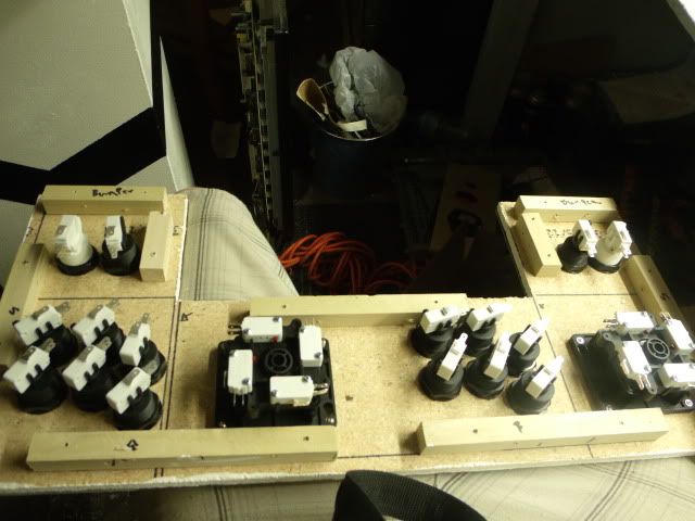

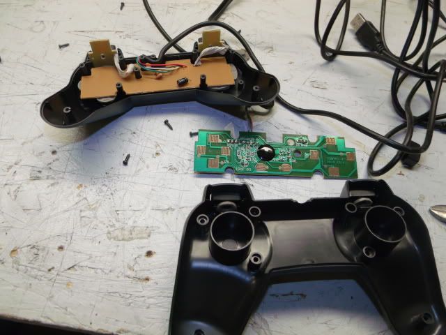

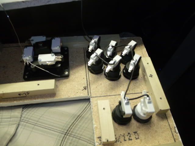

Brother is in from South Dakota with his girl, set them up with this as soon as they got here. Brother on Marvel VS and she is on pac-man.

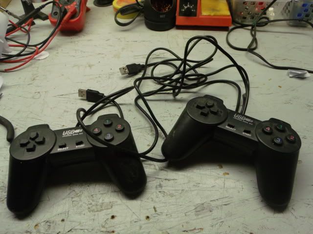

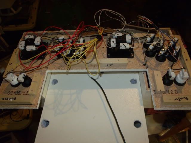

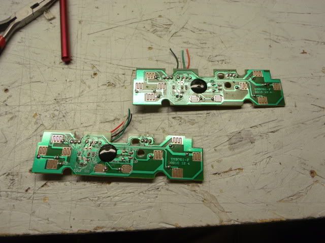

Solder time  :applaud: My brother thinks I am crazy because I like to solder and that it relaxes me.
De-Shelling controllers and removing shoulder button PCBs
Prepped with solder, ready for wires

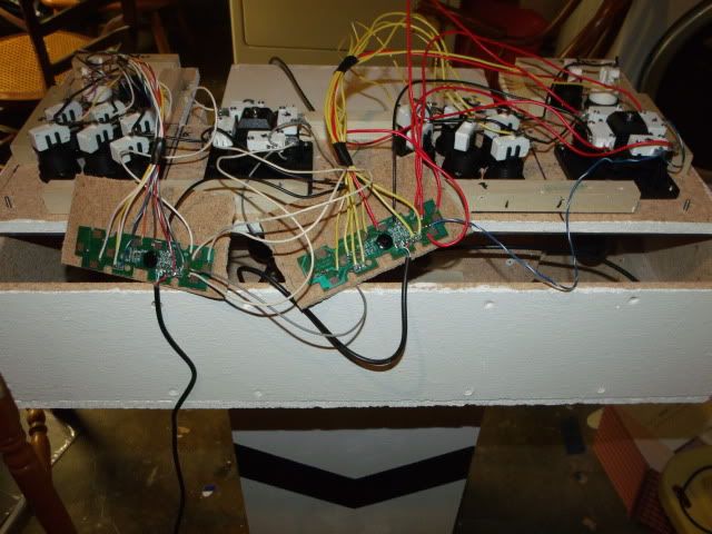

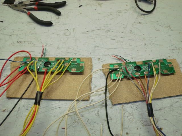

Mounting to scrap board cut to fit in the control panel for mounting
Don't mind the multi-color wires, I ran out of wire on my spool and am using scrap wire from an old arcade tear-down. Wired up the controller PCBs
Ground connections of buttons daisy-chained
All wires soldered from PCB to buttons & joystick
I swear I am working on my wire management, It doesn't look so chaotic now with the wire ties
Gaming Tests and glamor shots. There wasn't and elbow bumping either (until we played Mario Kart 64 - then it was everyman for himself)

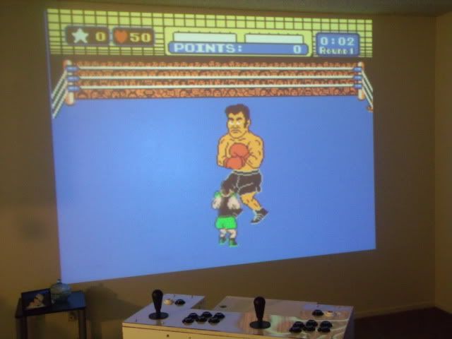

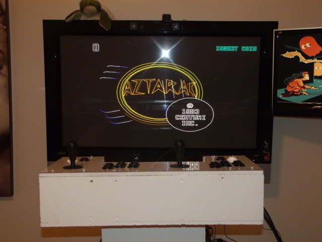

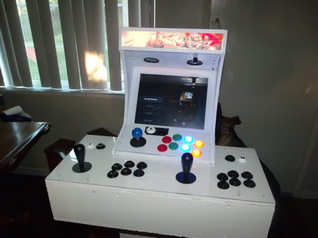

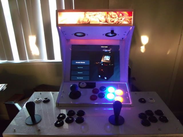

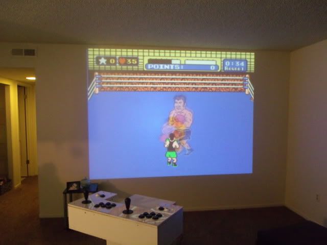

Switching the ability to use the bartop as a controller to make the USB port for the Pedestal. I don't like splicing wires much, so I cut open a USB cord with the soldering iron and soldered directly onto the connector.

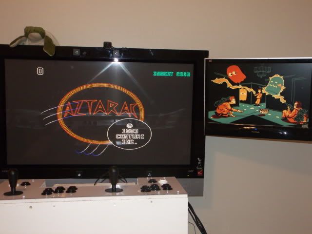

Also, I brought the pedestal over to a friends and played it on a projector  :cheers:
I found that this thing does tip a bit when on carpet..... :banghead:

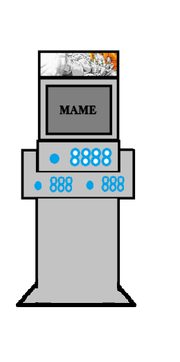

I am thinking maybe a better base? or those heavy wheels would help instead of the rubber feet I have on it now.
Maybe a base like this? or any better ideas?
  • Posts: 7924
  • Last login:November 30, 2025, 12:59:41 am
« Reply #96 on: June 11, 2012, 08:45:55 am »
Add a foot to your current design to give the base a little more width/depth. Paint it black and it should look decent.
Wheels will give it too much play movement, even when locked.
CoryBee
  • Posts: 2093
  • Bopity Boopy
« Reply #97 on: June 11, 2012, 11:46:39 am »
What exactly do you mean a foot?
  • Posts: 7924
« Reply #98 on: June 11, 2012, 01:54:32 pm »
Create a bottom portion and add it to your base to make it wider and deeper. You can disguise it to look as a foot rest or put some arcade pedals on it for driving games. Paint it black and it will look like it belongs there.
The easiest, non-decorative thing I can think of would be to use a piece of wood 4"-6" wider\deeper than the base and secure it to the bottom of the base. That would give it a bigger base and add stability.
phyrosis
  • Posts: 47
  • Last login:June 20, 2012, 06:54:07 pm
« Reply #99 on: June 11, 2012, 03:10:49 pm »
i would create a surround for it,
i bet i am thinking the same thing as leapin
i would do a 4 sided stand that the base is placed into, three sides (back and two side panels) sloped to 45 degree and go out about a foot, and the front part have chrome foot rests that connect into the two side bits,
i would also add some weight to the bottom, bricks, bottles of water or sand would help alot...
