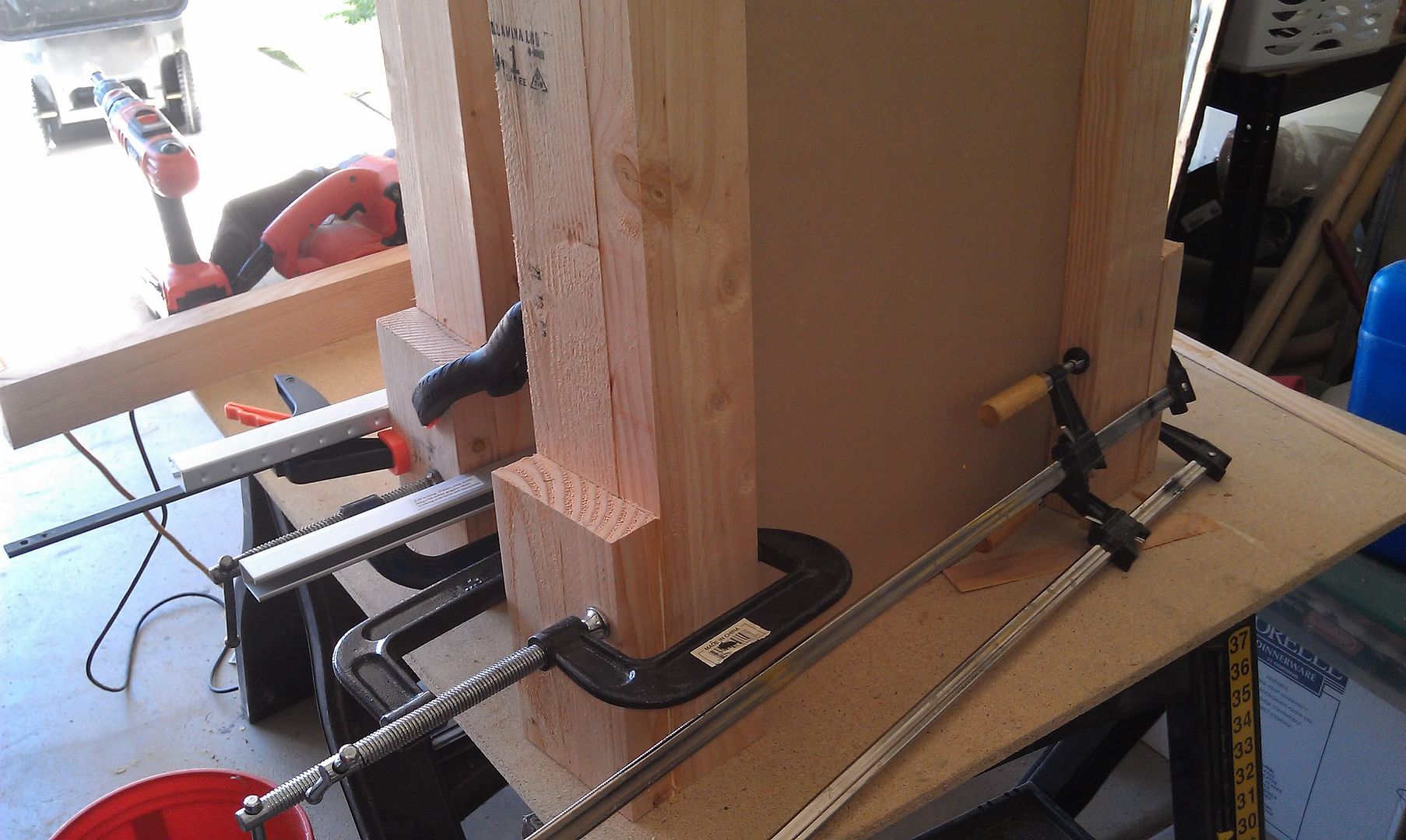

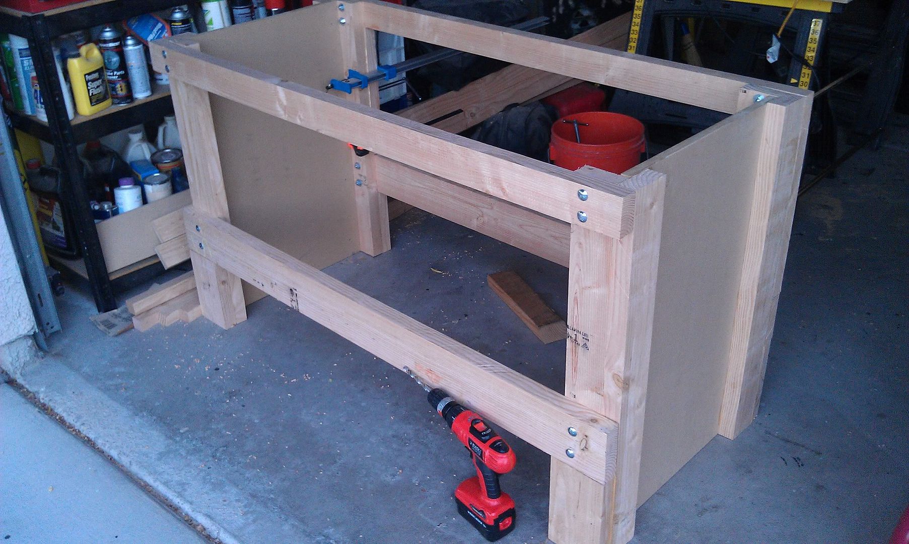

Well I've been a hobbiest of several hobbies for 20 years now.  I think its time to get off the sawhorses and garbage bins and make a nice flat stable place to work.  I've been watching the Woodsmith shop on PBS (Yeah I know).  They had a project they called the "Weekend Workbench".  Well the weekend came and went and I'm about a day from having the base completed.  So far I'm into it $162.57 and and I have about $113.86 left to go.   http://www.woodsmithshop.com/download/206/heavy-duty-workbench.pdf

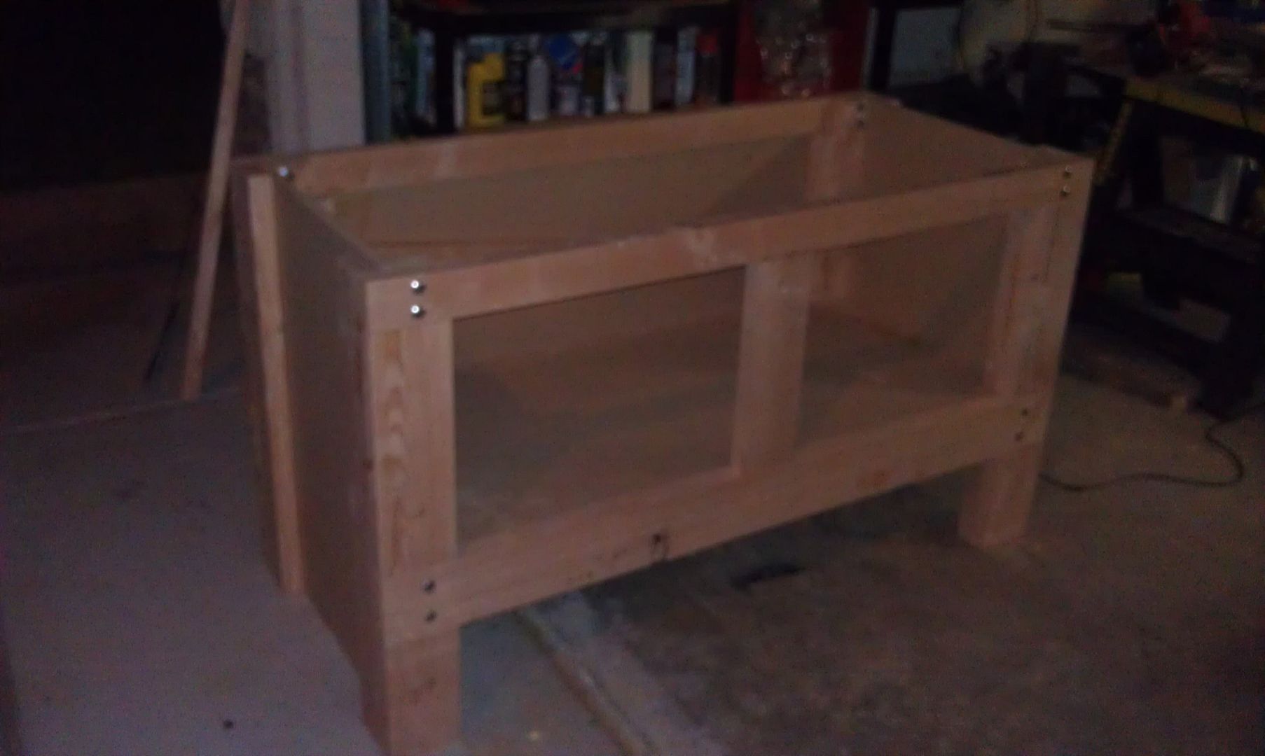

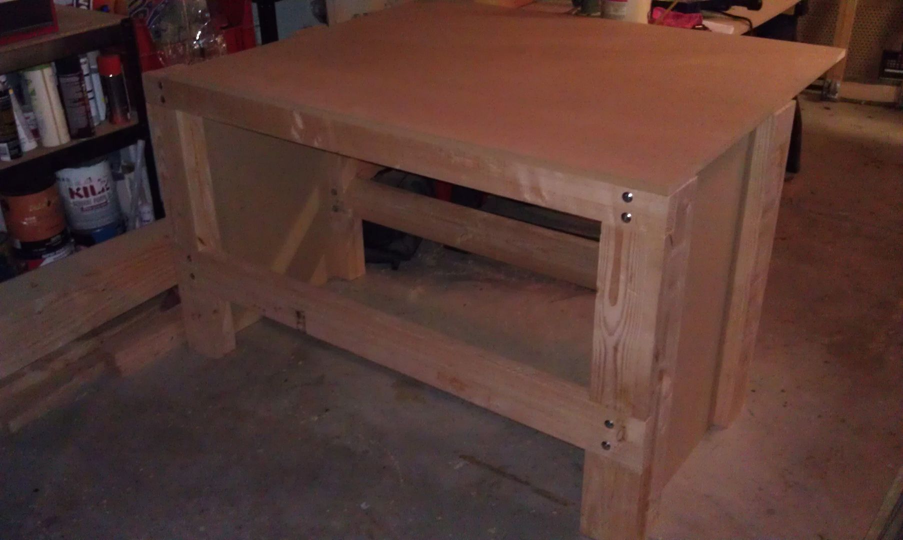

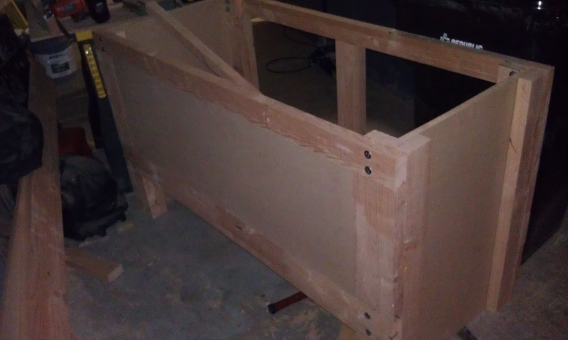

Saturday Update: Weekend workbench my Butt! I Assembled the MDF for the top today. (4 layers Glued and Screwed) also chamfered all the edges on the all the Douglas Fir.  I'm up to about $260.
The thing is so heavy I had to use a car jack and a Piano dolly to move it with the top on.
The stock on the workbench is for the doors.  Maybe tomorrow, maybe not.

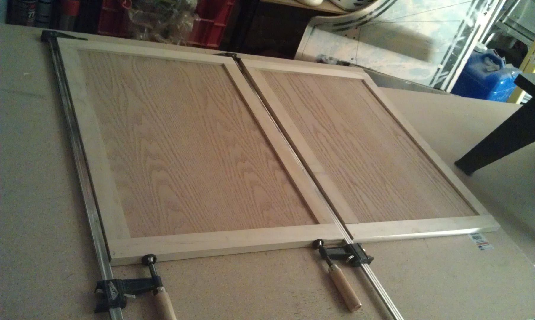

First attempt at stub tennon and groove doors.  Not perfect, but acceptable.
Nice to have a flat stable place to work.

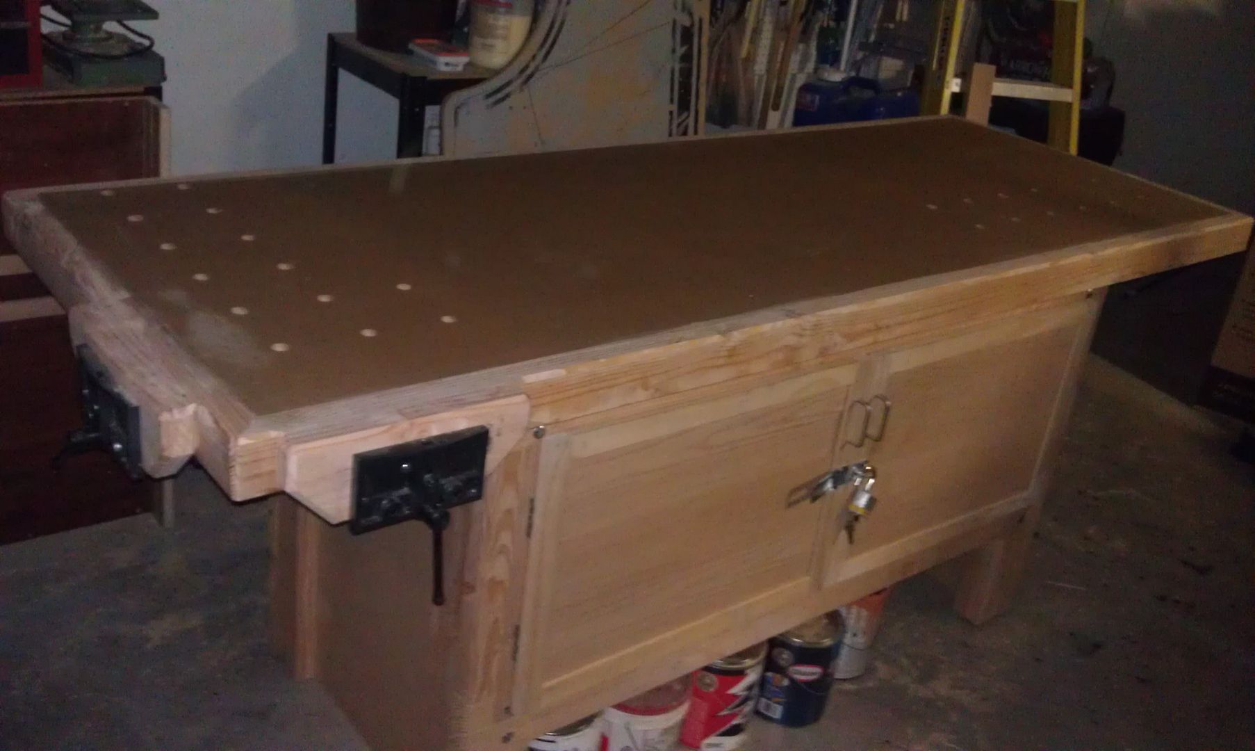

Mounted the doors.

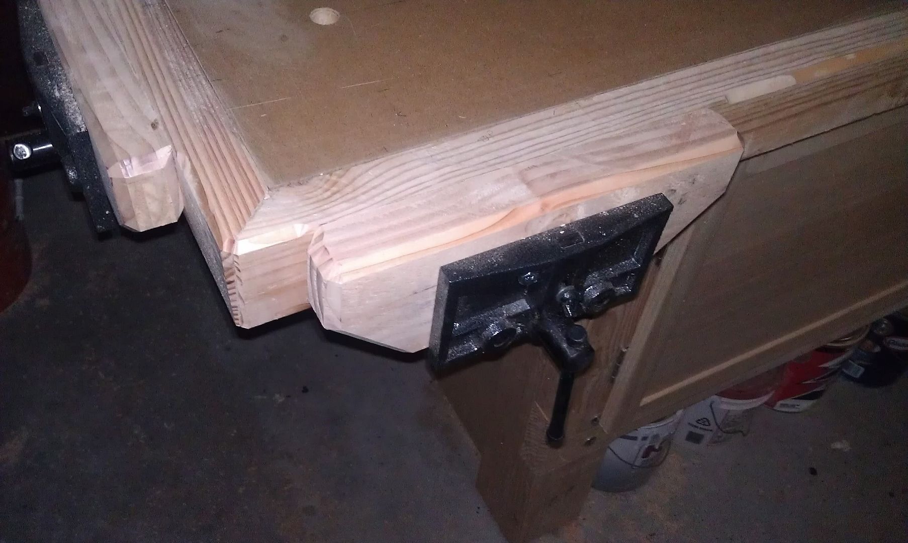

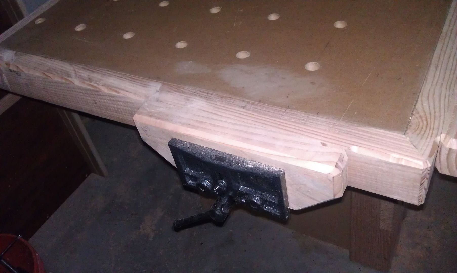

I added the rear and one side of the edge banding.  I added a layer of masonite and brought the edges up to that level, so I will have a flush mounted, replaceable layer of hardboard.  I did'nt mount the side and other end because I'm waiting for two 6 1/2 inch vises that I will bury the rear jaw in.  They should be here tomorrow.

 :pics

It's not ready for its closeup, but if you insist.  This is the back corner showing the two sides that are done.

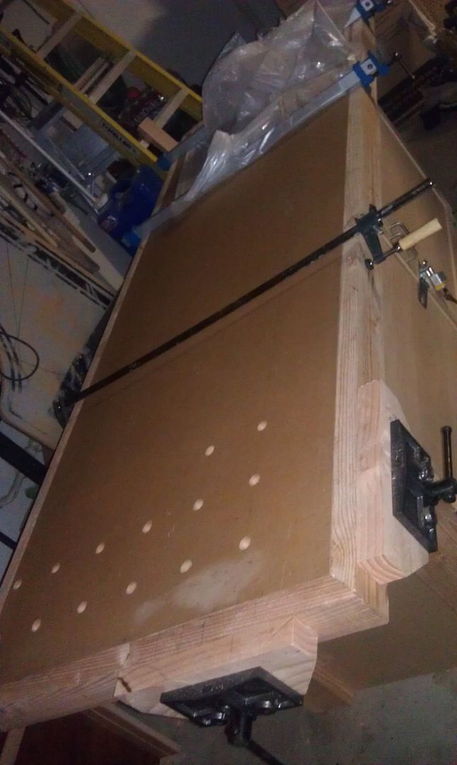

« Reply #36 on: May 09, 2012, 01:03:44 am »
Buried the two winches in the edge banding and glued up the edges.  Mounted the winches and began preparing the Vise faces.

I chamfered the banding edges and Vice Faces.  I cut a few more holes till my spade bit quit.
TopJimmyCooks
  • Posts: 2097
  • Last login:Yesterday at 03:28:53 pm
Re: Finally time for a real workbench.
« Reply #39 on: May 10, 2012, 08:58:58 am »
did you get metal bench dogs with springs?  Mine has square holes and I've been making do with old dowels and offcuts for hmm . . . .11 years now.  I just keep four of them in the holes near the vise so I never have to actually take them out, I just pop them up.
newtrix
  • Posts: 165
  • Last login:March 26, 2025, 04:16:36 pm
    • Loving Family Seeking to Adopt
« Reply #40 on: May 10, 2012, 10:41:26 pm »
For now I'm going to make some simple dogs from dowling and square blocks,  the 3/4 hole is pretty standard for dogs these days, so If i find some I like I'll go with those.

« Reply #41 on: May 12, 2012, 01:11:38 am »
  Holes finished and Chamfered so they won't chip out.

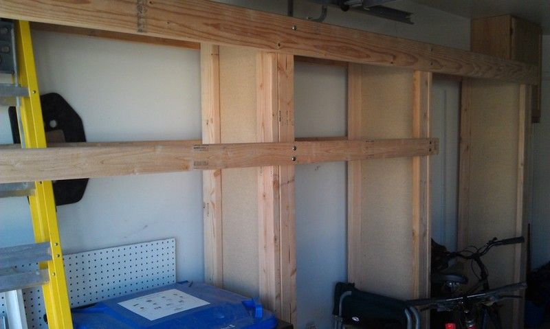

Now its time to start some built-in shelves.  The center opening is for a five foot stainless tool chest.  To the right of that a 4.5 ft Workbench with a pegboard backing for holding tools.  The left side is support free as the Garbage and Recycling bins go under it.  Eventually the shelves will likely have doors to match my workbench.
