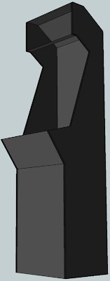

Hey folks, long time reader, first time builder. I'm aiming to start my project this very weekend now that the wood (15mm-tick MDF) arrived.
The plan is to build an upright slim cabinet that is loosely inspired by a bunch of other projects I followed until now (most notably the "Scratch Slim Marvel vs Capcom"). According to my lazy sketch, it should look something like this:
Initially I was aiming to use a 21" inch CRT TV, but it's too heavy and I don't have enough woodworking skills or equipment to hold it. Then I planned a bartop, but I'd want a real size one, my plan was to build it two pieces (bartop + a connectable lower part) but I found out that the bartop has very specific dimensions and angles and wouldn't work as both.
So I got to where I'm now: a slim upright cabinet. I opted for a LCD screen (I wanted a 4:3 19" but I only have a widescreen one of that size. So I'll use a spare 4:3 17" while I wait for a 19" 4:3 deal to appear) it will weight little enough for me not worry so much about stability. Also, internally I'll not worry much about building a good PC, I'm currently looking for a cheap laptop with a broken screen to do the job, it'll save space, need little ventilation and will be easy to mount.
My scale model (somewhat outdated):
I'm very pumped for this project and looking forward to start. I certainly should have planned more, but there are things (such as the screen angle) that I want to fine tune while building, so I'm leaving a few things to figure out on the spot (what could possibly go wrong?  ::)). Also, I'll go with the excuse that I don't have enough time to plan into details, but that's really just an excuse  :angel:.
Off the top of my head, these are the biggest risks/roadblocks/potential problems I will probably run into:
I love it!  These little models people build in the planning stage are awesome.  Hmmm this gives me ideas.  Welcome to a seriously addictive hobby BTW.

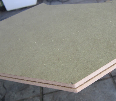

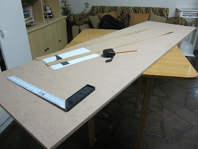

Amazing how sometimes things actually go according to the plan!
I know I shouldn't be surprised, but the side were cut perfectly and it all went pretty damn well.  :applaud:
... Aside, of course, the fact that this might have been the hottest day EVER and we had to move positions about 3 times before start cutting, but hey, I can't complain.
This was the 3rd and final setup (and before you ask, yes, I moved the birds before starting, didn't wanted to kill them with the dust from the mdf  :laugh:):
I did a lot of experimentation with my Jigsaw and the big mean circular saw and, not surprisingly, the circular saw was too broad and was doing a lot of damage to the edges while cutting, so my trusty jigsaw did all the actual cabinet cuts, and it did way better than I expected.
The coolest thing about this jigsaw is that I initially would let an adult do the cutting (and by adult, I mean an actual professional woodworker) but seeing how much he charged me to do that, it would cost about the price of low-to-mid range jigsaw. So I purchased the jigsaw instead, did it myself and it worked perfectly :cheers:.
To cut straight lines, I took the effort to place a wood strip to guide the jigsaw straight, it worked fine, only a few minor derails that were easily fixed afterwards while sanding the edges.
This is the result of the cutting (before sanding to fix some imperfections and make edges rounder).
Looking at it now, the camera's wide angle makes some lines look not straight, but I promise they are :angel:! I should have photographed at after sanding, but I forgot, sorry ;D
I'm very-very happy with the result. Next step, T-Molding. I will make some calls and look some more for a woodworker that can do it. If it takes too long, I'll buy the pine wood and start working on the front and back cuts first. Wish me luck.

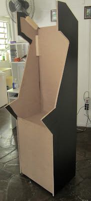

Lot's of updates coming out of the weekend. First, I got the t-molding done on friday, the woodworker mounted a small circular to a table router and did it in no time. Interesting how thing work when you use the right tools :).
Finally!

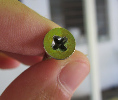

So early on Saturday the plan was to start screwing in the pines to the sides. I got 40x40mm pines and 50mm screws that will cross thru the pines and into the mdf. This way, the screws will stay on the inside, hidden and will allow me to unscrew them if necessary with no damage to the outside. I positioned the to two vertical bottom pines of each side right over the wheels. The idea here is that they will carry the all weight of the cabinet and weight it all over the wheels. Sort of like this:
Vertical pines right over the wheel to drive all the weight to them
So it's drilling and screwing time. Right away I was having a hard time with the screws, I was using flat-headed ones (seemed like a good idea in case I needed to hide them) but either these were low quality or all flat-headed screws are really hard to get a grip. My screw bit kept slipping out got dull early on and the screw heads where loosing their shape just as fast. The result was that I wasn't being able to drive the screws hard enough and kept adding more and more to reinforce the pines, until I realized it was useless and I needed to get round headed ones. BTW, they got so dull that I almost couldn't remove them.
Damn you flat-headed dull screws from hell!
It was late in the morning already and most stores were closing, so all I got was non-crossed (non-phillips) rounded heads, but they'll do. So after a few hours I got to this:
Twin sides
As I expected, it took some effort to get both side exactly the same, but wasn't that hard. I got them side by side and used a guide wood strip to make sure that (specially) the bottom was properly aligned. A few pines are still missing (top, bottom of the bezel and monitor mount), but those I still want to adjust after I assemble the cabinet.
With that we called it a day. On the next post I'll talk about the work on Sunday when we started to laminate and it went, well, not so smooth :timebomb:.

Have you tried drilling guide holes with a small bit before you sink your screws in?  I find that it helps everything go in a lot easier.  Everything is looking awesome so far. :)
Yes I did, the screws were 5mm wide and I drilled 3.5mm guide holes and still I was having a hard time with the flat-headed ones. When I changed the screws it went much easier.
Thanks :)

If you can get yourself a box of square head screws you will be very thankful.  They don't require force to keep the bit in the screw head.  But seems like you figured it out.

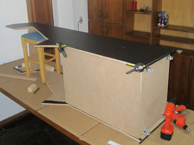

Everything went relatively well until now, right? So we decided to gain some time start laminating on the Sunday afternoon.
I purchased 4 meters of a black plastic laminate made out of recycled soda bottles, it's very resistant, relatively cheap and (according to manufacturer) easy to trim with an stiletto. Ok then.
So we cut it to both sides and took what was left from the cuts to fill the visible inside borders.
So I started to apply to the inside borders first with contact glue. I used a spatula like the laminate instructions recommended, but that was taking ages so I tried a paint brush and it was WAY easier. With the all of them applied (and without a router to trim the border) I trimmed it with an stiletto, again, like the laminate instructions recommended, and it took ages to do it right.
Trimming laminate with a blade is frustrating, even if the laminate is made for that, trust me
But that's ok, it worked. Next step is to laminate one of the big visible sides. We applied a hand of glue on both laminate and the mdf (two are required). Then the second hand and we waited around 10min before gluing the laminate.
In that mean time our good luck apparently ran out. There was a minor medical emergency nearby (proven to be nothing serious later) and I'd have to drive to the hospital. No problem, let's rush applying the laminate and leave right away, right?
Right, but things didn't work as planned. As we were holding the laminate to make contact to the MDF (rushing to get that done and getting ready to leave, all at the same time) the laminate barely touched the MDF without getting into position first. CRAP! Contact glue cemented immediately (damn effective glue) and we tried to pull it back quickly only to end up ripping the laminate :angry:. After it ripped, it made even more contact :hissy:. Ok, plan B, we just ripped it all off before it cemented even more.
Proof that rushing to get things done is bad, very bad, mmmkay?
So that where I'm at right now, there is a considerable amount of cemented contact glue on the cabinet side. While not a thick layer at all, it's probably enough make the surface somewhat bumpy if I'd just ignore glue the laminate over it. So I will have to remove those spots by hand by using heat, scratching and then sanding. I can't use chemicals because they could interfere in the application of the laminate later and I can't overdo the sanding to avoid doing damage to the MDF.

Small update: Looking at the cabinet side the day after, the cemented glue has contracted after it dried and the surface looks almost flat again. It looks like I can just apply more glue and laminate over it and the surface will be sufficiently smooth. I'm not completely sure though, so I'll try to remove most of the glue bumps before laminating.

Time to fix the mess I did last weekend. First step, remove the cemented glue. As I mentioned before, I can't use chemicals, so I tried a bunch of things, including using a sharp blade, but what really worked was using sand papers with wide strokes. After a while I got to this:
Not pretty, but surprisingly smooth
Good enough, time to laminate. Cut another piece of laminate to size and applied glue (no distractions this time). he application went very well and it now look like this:
Pretty good! :cheers: The other side went the same way :applaud:. I also used some laminate leftovers to fill the remaining visible areas on the inside. Trimming with stiletto is a pain.
So, good progress and a major screw up fixed, next step, cuts of the front and back pieces and the first assembly! All of it (hopefully) next weekend.

Straight cuts are overrated.
Or so I’m trying to convince myself as I cut the front and back pieces of the cabinet with a jigsaw, rather than my overly powerful circular saw that makes too much mess and noise. Add that to the fact that this is Sunday at 6am and people in the house wanted to sleep and I only had the morning to build the cabinet. So as quietly and fast as I could, I cut pieces for the back, and the bottom front and inside.
And yes, cuts were not quite straight. Actually, they almost were, but when I noticed I need to trim just a little more, I made a mess  :banghead:. Oh well. At least these crappy cuts were areas that didn’t needed to be straight (the end of the bottom front area and the front and back of the shelves on the inside) the other cuts were pre-made when I brought the MDF. So no biggie.
Time to build the cabinet. Just screws and no laminate on the front and back yet, just in case I need to fix something later. I had no idea how I’d do it properly, I figured that laying one side, placing pieces and then placing the other side on top and getting it up would work. And surprisingly, it did work fairly well.
I made quite a few changes to my initial plan, which proves that having everything planned to detail is a bad idea, I tried to leave a lot of room for changes. Some of those changes were:
  • made the lower are of the cabinet a box rather than an “empty” cabinet (with no mid shelf supporting the structure). Essentially I made the bottom and middle pieces (or shelves) to form this box shape. If wasn’t for this middle shelf, the whole structure would be wobbly, so I’m glad I figured this out in time.
  • The back piece will not be one big piece with a door from a hole in the middle (that I’ll make later). Initially I’d split in three pieces with the middle one a door that opens down but this wouldn’t work because the side are extremely tight and it wouldn’t open much less close. With a door in the middle of a single piece, the tightness isn’t an issue.
The only thing worth noting about the assembly is that when I was to place the back piece, I couldn’t. the sides made the back area too tight (may just one millimeter, but wouldn’t give). Maybe it was just the laminate pieces (0.9mm each side, that’s ~1.8mm). After much brainstorm, we (my dad was helping here) managed to side it (forcing it) in from top to bottom kind of like a sliding door. While VERY tight, it’s not like it’s stressing the structure or anything like that.
So we got the cabinet up and amazingly, it’s very sturdy and straight. Awesome!  :applaud:
