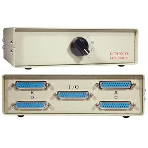

« Reply #13 on: March 10, 2012, 02:20:46 am »
to be clean and safe but also a long process I would use a db15 vga switch box.
wire your controls to a male db15 and write down each pin and what they are.
then it plugs into the input on the switch box.
then for the output use another male db15 again and use your wire pinout you wrote down and run each wire to their correct spot in the ipac gp wiz or whatever for the pc.
say the switch box is a 3 channel A B C
say C for computer.
say B for xbox and you would wire the same pinout to the xbox controller or xbox controller pcb emu thing if there even is one.
say A for wii then wire the wii controller up with another db15.
it is alot of work and time consuming but when done everything is clean, you know what and where every wire goes.
if there is ever a problem instead of going through tangled mess's and perhaps soldering desoldering or crimping etc. this way you just unplug the harness from the DB box and the console can be removed with ease and attached back with ease like in seconds not hours so it pay's off in the end.
want too go from pc to xbox just flick the switch.
I decase the controllers solder them up with the wires and then hot glue them and seal them in radio shack project box's so there safe dust free and in the end you have a clean black box with the db15 harness coming out of one end to the switch box and the console's controller cable that goes to the console coming out the other.
you can also unplug your whole arcade cp this way and pull it right outta the machine in no time but it takes time getting it all setup my way.
you dont want to share any signal lines or ground with 2 or more system pc's or what not at once.
some where along the line something is bound do be very goofy, not work, or possibly ruin something where you loose complete control function.
dreamcast no likey any of that for sure.

I was going to chime in, but northern came close to what I was thinking.  Have you looked into the old Centronics LPT switchers? 25 wire in/outputs that can be switched to 1 to 4 out/inputs.
$26 http://www.amazon.com/Cables-To-Go-03292-4-Port/dp/B0000512C5
Uncle Monkey
  • Posts: 124
  • Last login:September 12, 2020, 10:16:25 pm
  • P24L
    • Project Thread
Re: Calling all wiring/electrical experts, please advise.....
« Reply #19 on: March 12, 2012, 09:32:31 am »
So correct me if I'm wrong, but I should be good with one wire for common, one per button and four for the joystick (SANWA JLF with microswitches) Which puts me at 16.....
MacGyver
  • Posts: 317
  • Last login:December 18, 2023, 12:49:00 am
    • Project Build
« Reply #20 on: March 12, 2012, 11:07:22 am »
I would say no. Even if one controller did, the other ones would have to share the same wiring config, maybe they would, maybe not
For a keyboard encoder, yes, but for a joypad, not so much.  There is no telling how they decided to wire up the switches for each action.
That's why I posted the 25 wire switch.  6 buttons would be 12 wires, 4 way joystick could be up to 8 wires more, now we're up to 20 wires, 2 wires for "start", 2 wires for "select", puts us at 24 wires, and that is just one player.
There might be a way to use transistors, but it has been a long time since I played with that.
You could maybe use a micro-relay across each "button" of the joypads, and then drive all 3 (PS3,XBOX,WII) of the micro-relays from one arcade panel button. Repeat that for each button.  Micro-relays are expensive, but it should work.
I don't think the diodes idea would work due to the different controller wiring configurations.

Re: Calling all wiring/electrical experts, please advise.....(SOLVED)
« Reply #21 on: March 14, 2012, 08:00:09 am »
As fascinating as this discussion has been, (I've learned a lot :cheers:) I think I'm going to go with the Toodles MC Cthulhu since I can use it on my PS3/PC with a simple USB and the wii with a different cable. Plus it supports a bunch more consoles with special cables...... :applaud:
