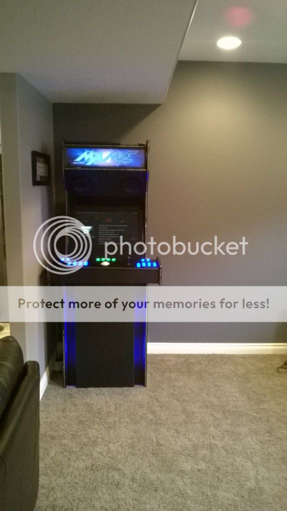

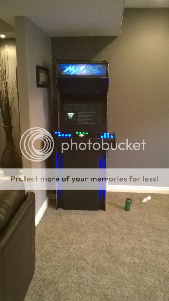

Here's some pics I took of it while it was playing some music on xbmc.  I had to install a door on the side because the monitor wouldn't wake on HDMI, so I have to turn the power on at the back.  The door turned out to be a pretty good place to install the toggles for the marquee as well as the volume knob.
Current working systems:
Mame
Sega: Master system, Genesis and Dreamcast
Nintendo: Nes, Snes, N64
SFIV
Mortal Kombat Komplete
Family guy/future pinball
« Last Edit: May 30, 2014, 01:04:38 pm by Frank Drebin »
